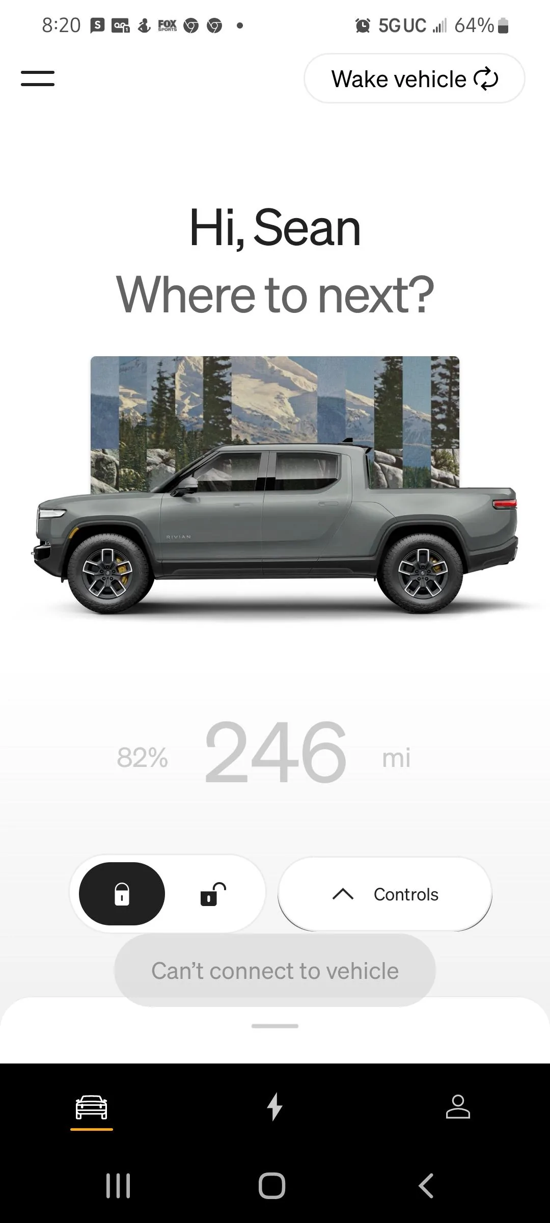

It’d be interesting to know the VINs on those bricked trucks to see if they were all early production units.
Mine just did it. delivered 10/10/2022. still dark even though it has an 82% charge
Rivian R1T R1S Truck is bricked! Update FIXED!   [12v battery trickle module software issue] Screenshot_20221111-202034_Rivian
