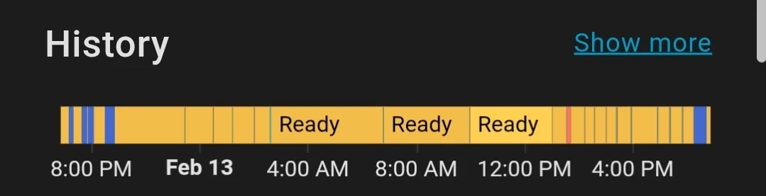

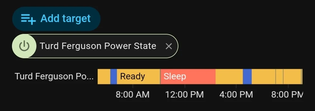

I'm seeing the same thing. Though for me there are a few distinctions:
1. It did not occur directly after the update.
2. It does sleep, but only when unplugged.
3. Technically, it does go to sleep, but only for a few seconds.
Plugged in:
Rivian R1T R1S Truck no longer sleeps Screenshot_20260213_185409_Home Assistant
Rivian R1T R1S Truck no longer sleeps Screenshot_20260213_185315_Home Assistant
Unplugged:
Rivian R1T R1S Truck no longer sleeps Screenshot_20260213_185447_Home Assistant
Plugged in:
Unplugged:
Good data, thanks for sharing.
I should note that mine has occurred unplugged for the most part. Also, it wasn't directly coincidental to the latest update, but definitely since then.
