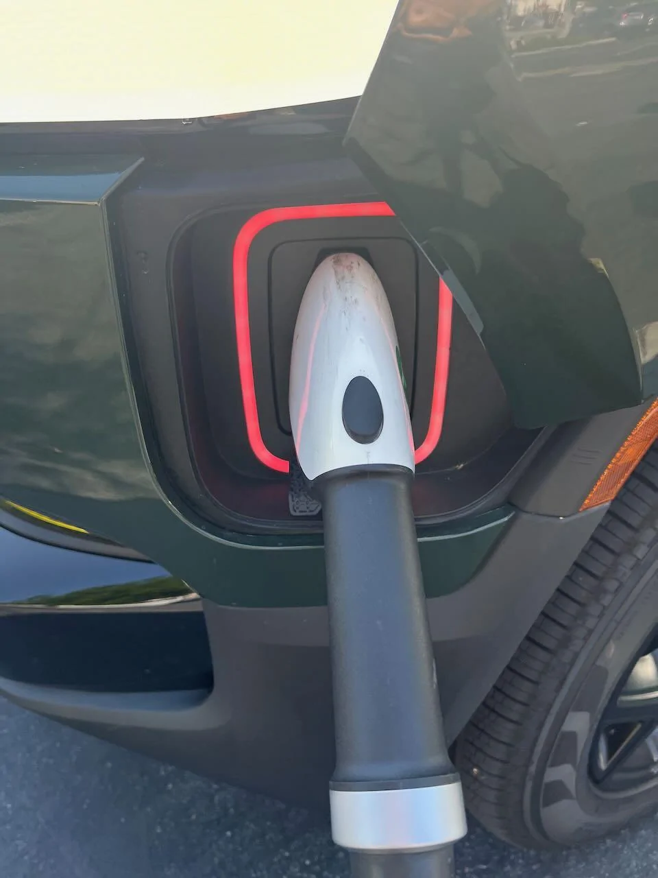

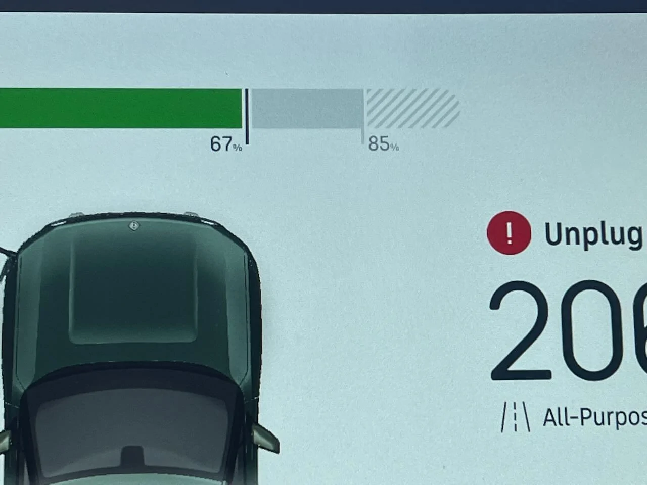

No issues with Level 2 Charging, both Public & at Home, but every attempt at even brand new EA and Chargepoint chargers results in "Unplug & Try Again" messages. even after reboots. These are working chargers with Porsches, Volvos, Ioniqs, etc successfully plugged in, FYI. Anyone else experiencing this?
I am experiencing the same problems since the last update a week ago. I have almost 8,000 miles on the truck and haven't had an issue with charging until now. It charges level 2 fine, but won't do DC fast charge

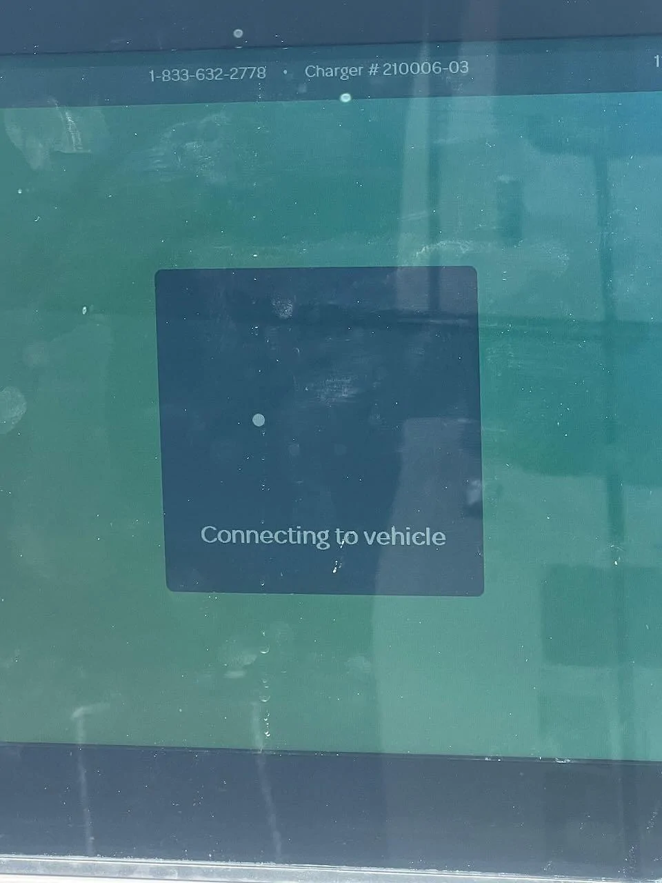

Just went up to Kernville with the family for the weekend and had an “interesting” experience. We rolled into the Inyokern Rivian DCFC to find that the truck would not initiate a charge with any of the chargers. It would fail out and warn to unplug. We luckily found a nearby 50KW charger that we could use, albeit slow with my unruly passengers (wife, 3 girls AND 70lb shepherd in their laps) not thrilled to hear we needed to sit around the middle of nowhere.
My assumption is the same as everyone else experienced. I didnt call it in as I had already read some threads about it and instead logged a ticket to get the family on the road. Im following up, but heres the interesting part… After that incident I planned our return from camping to go to an EA charging station as I had use their 150KW chargers with no problem previously. When I got there I realized they were all 350KW chargers, but gave it a go anyways. The truck and charger behaved and we were all filled up in about 18 minutes (Approx 30% to 80%).
So, for me, it would seem my truck can talk to all charger networks except Rivians…
While typing this I got an update on my ticket saying that it’s a module to replace. Must be a module specific to the Rivian charging network?

Got my truck back today and here was the fix for my Level 3 DCFC charging error:
Concern:
- Customer states: Vehicle not charging at DC Fast charger
Cause:
- Central Gateway Module internal fault preventing fast-charging. Replaced and programmed new Central Gateway Module and verified proper function of DC charging.
Correction/Remedy:
- Module, Central Gateway (Remove and Replace) - External Charging General Diagnostic
