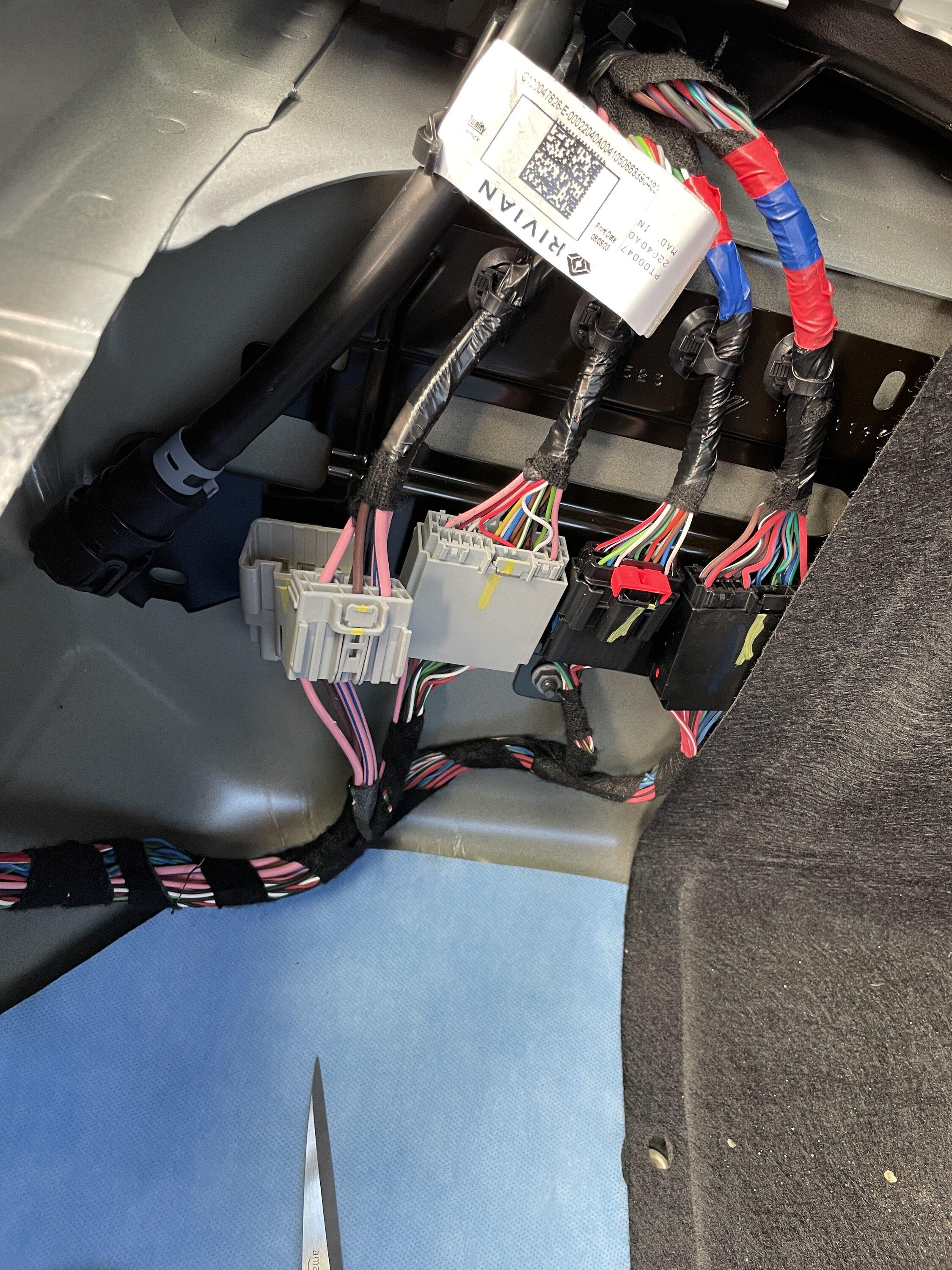

I have left my control inside the spare wheel compartment. Eventually I'll run the wire to the front, but so far it has not been necessary. On the EQ I have pushed the 65Hz about half way down before adjusting the sub level. Now by moving the 65Hz level it can fine tune the sub if needed.
I'll take a picture of what is needed to be removed for access to the sub and the 12V. The 12V ended up being easily accessible. No messing with fuses necessary, as you just unplug the connector located under the rear piece of carpet inside the spare storage and tap to the pink wire going from the fixed connector which is going to the tow hitch. Since that is switched power, it is used for amp control as well.

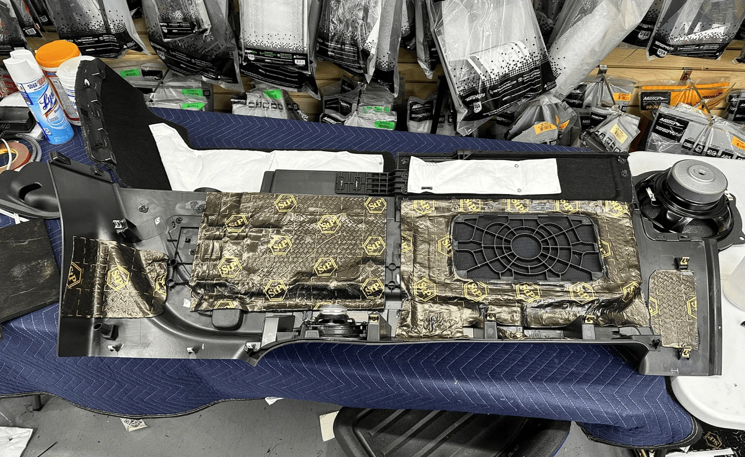

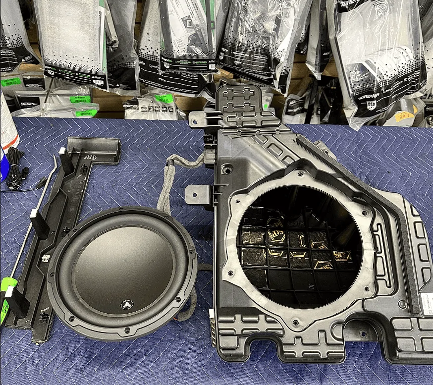

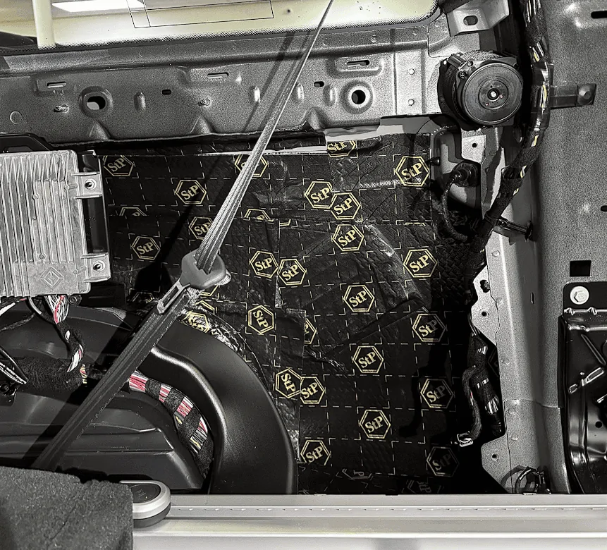

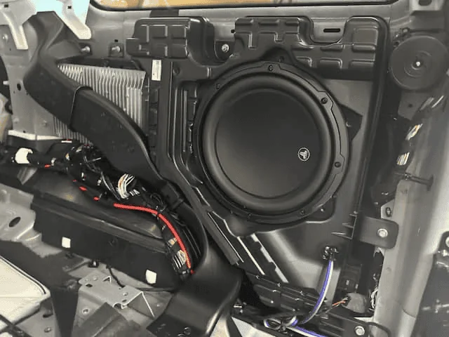

VikingMD
Aug 4, 2023

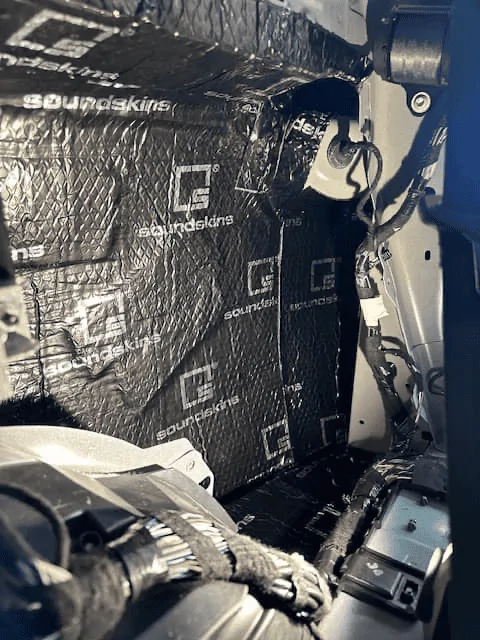

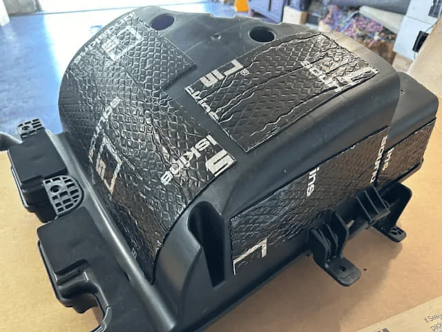

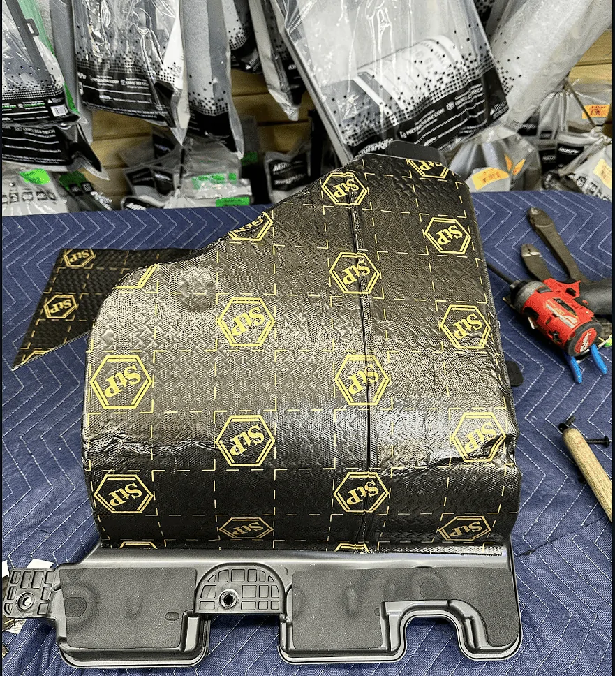

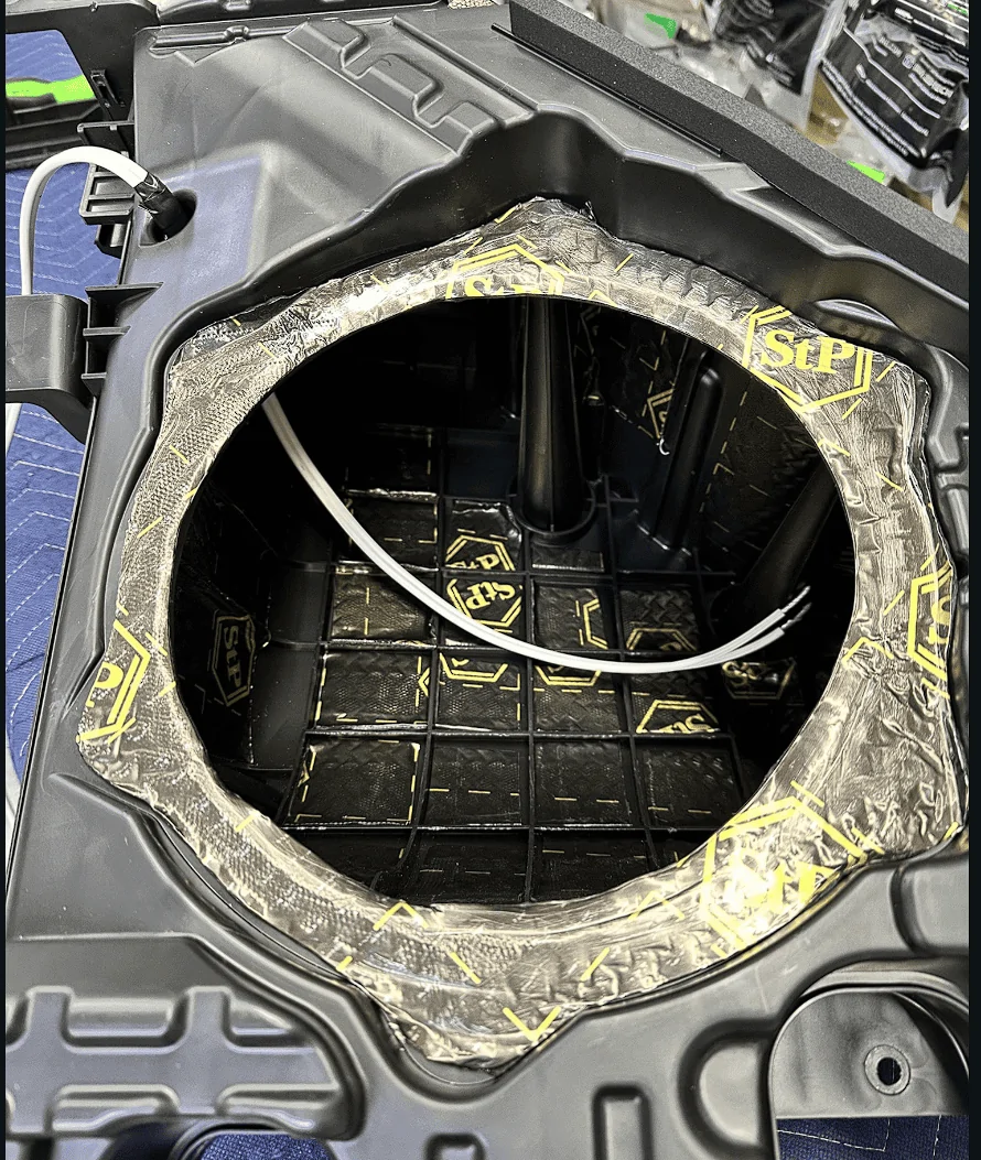

Not sure but I thought people in this thread my be interested in this FB post that I cam across.
He installed the following in the standard sub location with sound deadening.
  • JL Audio 10W3
  • JL Audio MX500/1
  • JL Audio XDACS60 (Wiring Kit)
  • JL Audio RBC-1 (Bass Knob)
  • Audiocontrol LC2i (Integration)
Rivian R1T R1S Upgraded the sub in R1S with aftermarket Alpine SWR-T10 Subwoofer 1698077670128
Rivian R1T R1S Upgraded the sub in R1S with aftermarket Alpine SWR-T10 Subwoofer 1698077627018
Rivian R1T R1S Upgraded the sub in R1S with aftermarket Alpine SWR-T10 Subwoofer 1698077646950
courtlandre
Oct 11, 2023
Raleigh, NC

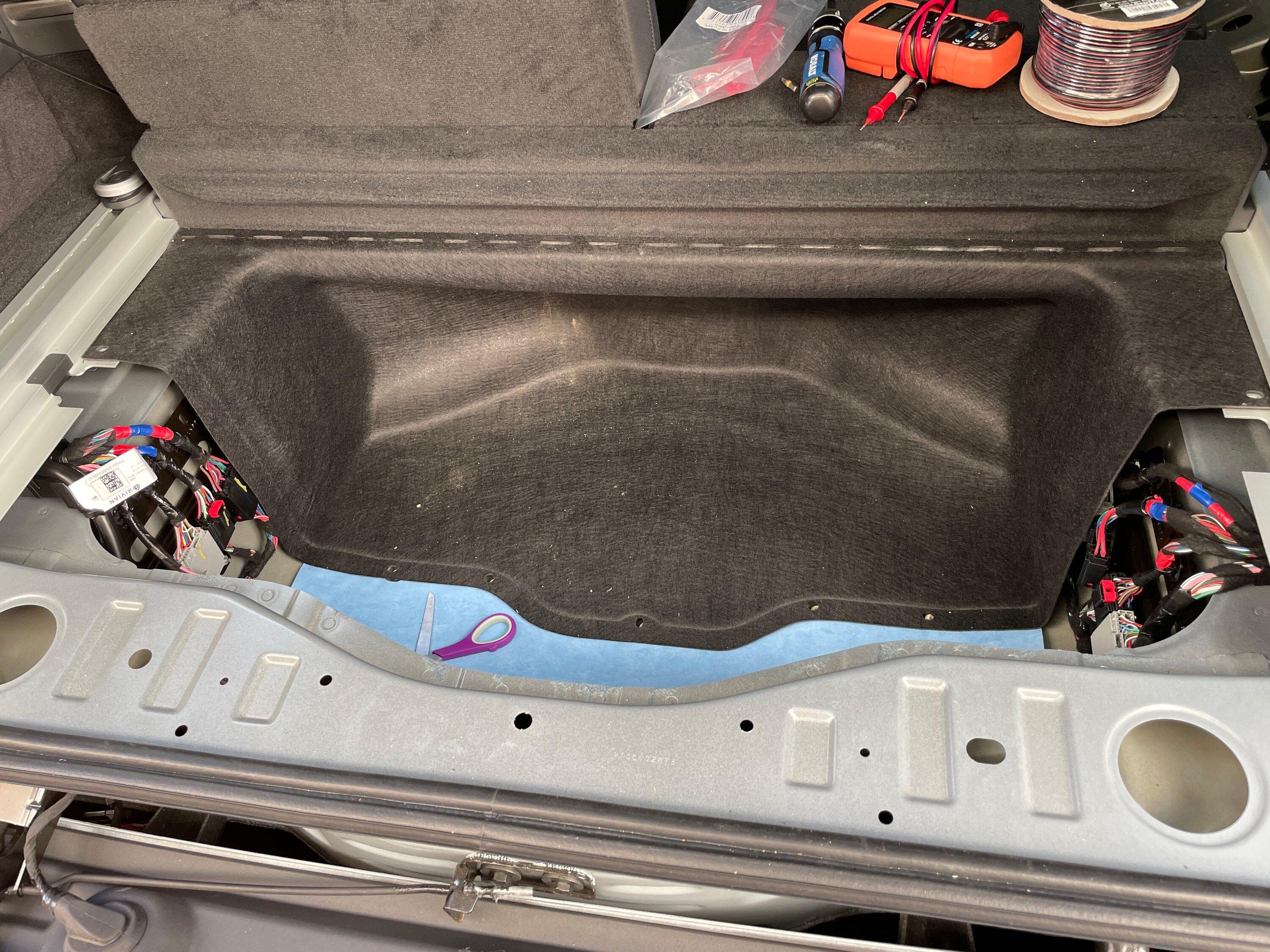

Taking out the tub cover was pretty easy, just pop up the plastic screw things holding it down.
Rivian R1T R1S Upgraded the sub in R1S with aftermarket Alpine SWR-T10 Subwoofer IMG_3301 (1).JPG
On the left side there is a group of connectors; I tapped into the far left pink wire.
Rivian R1T R1S Upgraded the sub in R1S with aftermarket Alpine SWR-T10 Subwoofer IMG_3302 (1).JPG
I'm not entirely sure this is correct, but it turns on/off with the car and provides ~13V.

Great! Other than that pink wire, what other wire did you tap? Considering to take this route, but I have no idea on these and trying to learn
courtlandre
Oct 11, 2023
Raleigh, NC
Pink is the power cable, for ground I just loosened a bolt attached to the chassis and attached a wire. For the audio I took from two of the four wires going into the stock sub. So basically power and ground then two speaker wires go into the amp, from the amp there are four speaker wires for the 2 coil sub.

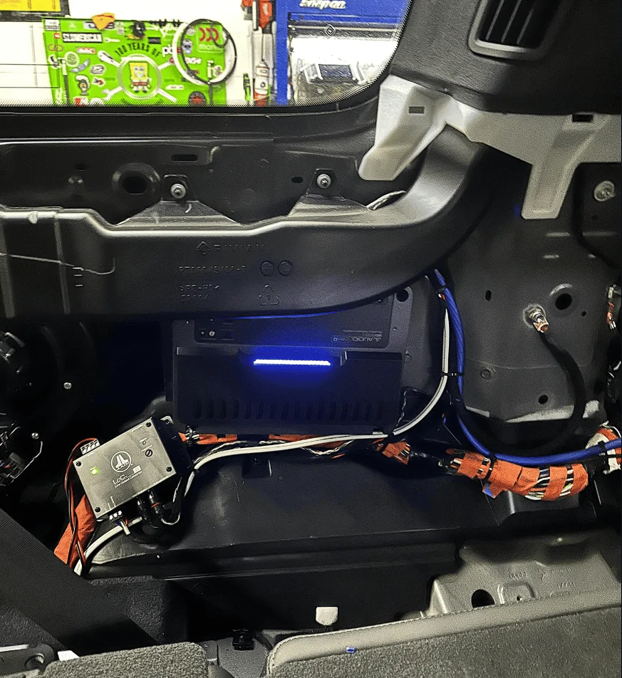

Someone on Reddit has photos of a sub upgrade he had done at his local shop. Reddit post
  • JL 10W3
  • JL LOC22
  • JL RD500/1
It sounds like the LOC is not needed, and amps can handle speaker level input from the Rivian amp?
Rivian R1T R1S Upgraded the sub in R1S with aftermarket Alpine SWR-T10 Subwoofer 1699039781490
Rivian R1T R1S Upgraded the sub in R1S with aftermarket Alpine SWR-T10 Subwoofer 1699039795686
Rivian R1T R1S Upgraded the sub in R1S with aftermarket Alpine SWR-T10 Subwoofer 1699039811754
Rivian R1T R1S Upgraded the sub in R1S with aftermarket Alpine SWR-T10 Subwoofer 1699039825139
Rivian R1T R1S Upgraded the sub in R1S with aftermarket Alpine SWR-T10 Subwoofer 1699039852480
Rivian R1T R1S Upgraded the sub in R1S with aftermarket Alpine SWR-T10 Subwoofer 1699039868700
Rivian R1T R1S Upgraded the sub in R1S with aftermarket Alpine SWR-T10 Subwoofer 1699039889625
