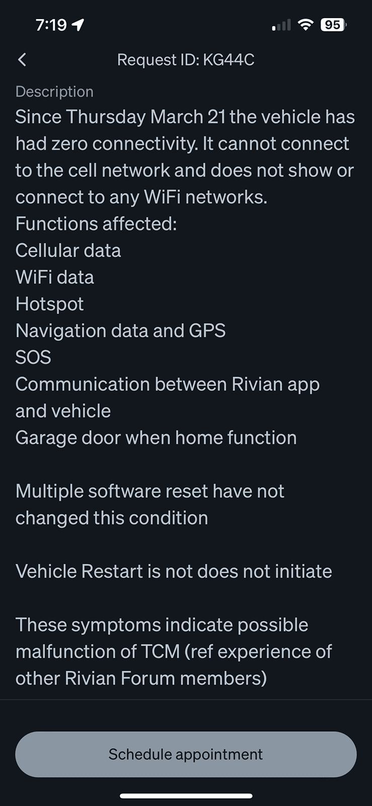

Same issue. No connectivity. Done a hard reset and sleep mode twice with CS Friday and Sunday. SOS, Nav., Spotify, setting charging schedule, cell service, proximity lock all down. Earliest appt. I could get is May 21st...first issue I have had on vehicle, 12K in. Looking forward to reading the fix.
When you made the appointment did CS say that ATT outage is over?
May be it’s time for me to contact them again.
That’s quite a wait.
Where is your SC?

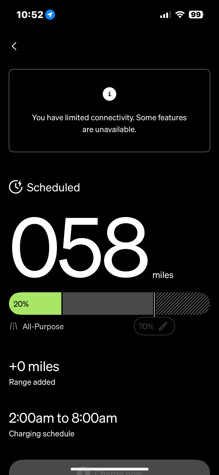

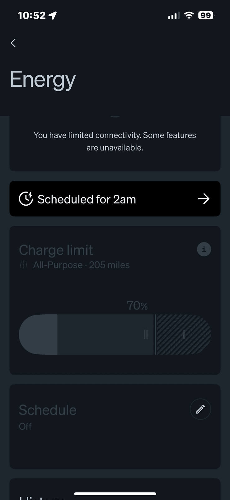

I’ve had some of these similar issues, in the last 24 hours. An overnight scheduled charge didn’t happen. The phone app has limited connectivity with the vehicle. For instance, there is no way to start a charging session manually from the app. The shortcuts on my Watch/phone are not working. Talked to a Rivian person who indiacted it might have something to do with some issues that AT&T was having. Hopefully, it will resolve itself. We’ll see what happens tomorrow.

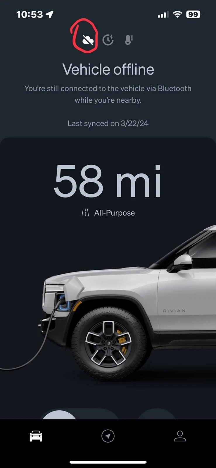

I just noticed that I have no app to vehicle connectivity either. It’s charging but my app doesn’t show it.
however mine should be on WiFi and I was able to see it connect on my router. I have a feeling this one is a different issue.
Where is your SC?
CS in Portland. I am in Bend, OR. Appt. set with mobile CS. CS did mention AT&T and other providers. I have Verizon.

My app also shows the vehicle is off line, even though the in-vehicle display shows its connected to WiFi. About the only thing I can do with the app is lock/unlock the doors and turn on/off the interior climate settings.
I talked with service team this morning- we did a reset by pressing button left button on left side of steering wheel and caution lights button for 15 seconds to reset, then it took about 90 seconds to complete and all is good.
Thanks. Tried several time. Screen never cleared as CS noted it should
I’m in same boat. Cannot do vehicle restart. I was not plugged in any time.
I requested service visit in app. App said there are no available appointments at Bellevue WA, said Rivian will call me to schedule.
