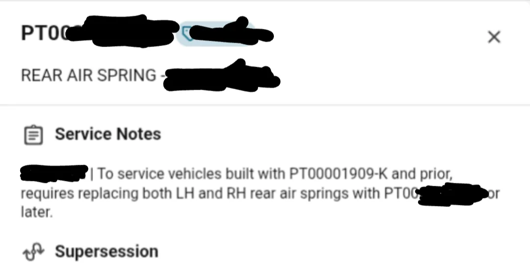

Hey everyone, I wanted to give a quick update on the ride height calibration situation with my custom Rivian.
After months of troubleshooting and thinking the calibration was the main issue, my mechanic now suspects that we might have been working with the wrong part from the dealer/store. This could explain the long delays and why the calibration seemed necessary when it might not have been the real problem at all.
For reference, the part in question was the Air Spring – Rear Left (PT00001909-K1), $866.89. We’re now planning to order the correct part via eBay, which should hopefully finally resolve the ride height issue—or at least clarify whether dealer intervention is truly needed.
Just to note: this is new information I’ve heard, and I still need to confirm whether Costa Mesa truly sent us the wrong part—but it’s a possibility.
For anyone following along, this just goes to show how even small ordering mistakes can create big headaches, and sometimes delays aren’t due to mods or DIY work—they can simply be the result of part miscommunication.
I’ll keep you all posted once the new part arrives and we see the results.

Your
third-party technician with years of experience
is clearly not a Rivian certified third-party technician with Partner Portal access who can check to see there is both a successor to that part number and also a Service Note with valuable information.

It's too bad you didn't approach this problem like a normal human and ask for help with the real problem: your
didn't follow service guidance. We could have figured this out days ago with little fanfare.
And no, I will not be posting unredacted part numbers and information. I recommend getting a new
