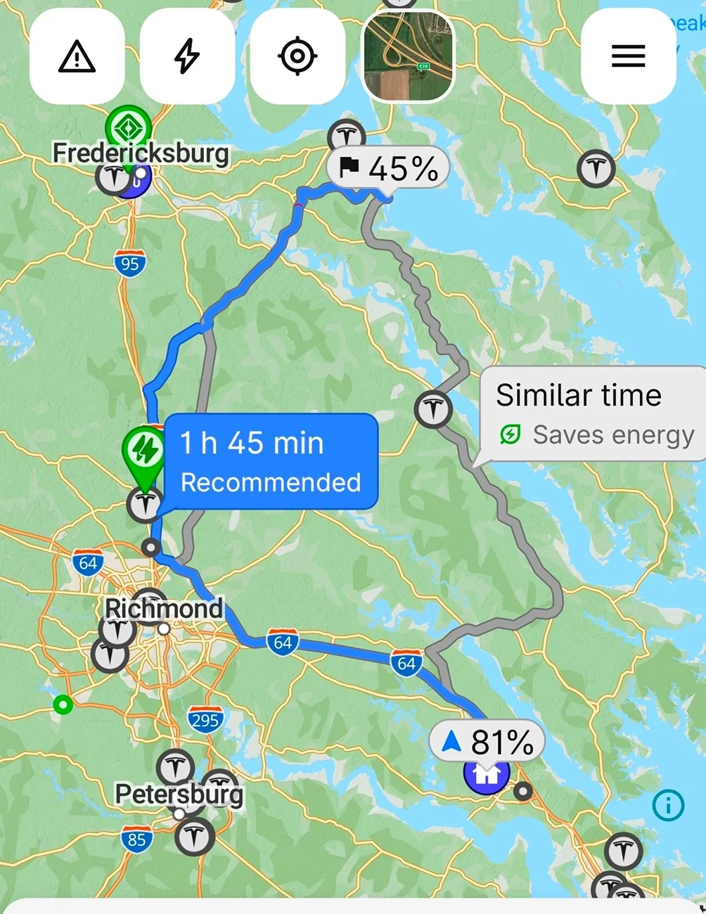

So it turns out alternative routes are offered when going to a destination.
Rivian R1T R1S rivian google maps vs native google maps IMG_20260721_134150700_HDR
I still don't see options offered during the drive, but this is an improvement over what I originally thought the reality was. Not sure if this was added in the 2020.24.40 update or if it's always been there.
It's been part of the R1 navigation for a while, so I'm guessing that it was always in the R2 software/nav...... but as I stated in a different post, weirder things have happened.
