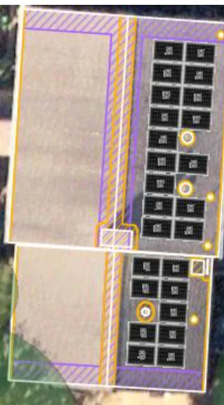

The additional challenge for my house is our HOA. I cannot put panels on the front, so there is only the rear, which faces east. It gets good sun for a much shorter period of time than if I had a roof facing south, or if I could put panels on both sides of the roof.
I had Dominion Energy do a estimate for my house and if I covered every allowed surface, I could get 8772 kWh of production with 25 panels. It would offset 34% of my electric bill.
