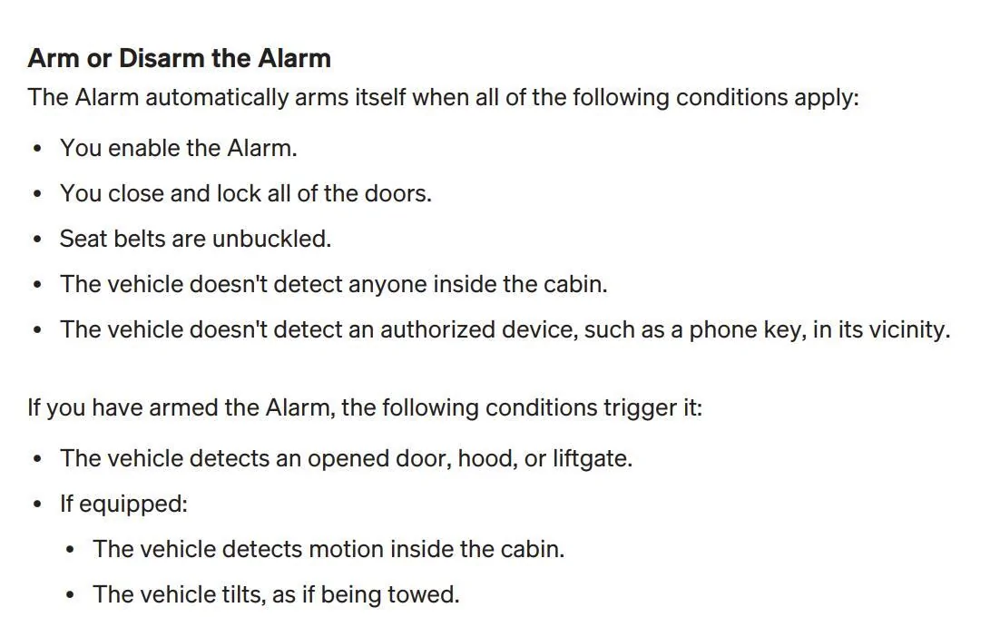

I have never tested it.
The owner's manual does not indicate the fob must be used, and does mention the phone key.

Occupancy disables the alarm.
The test would be to have a window open, phone very far (or off), and reach in and open the door.
