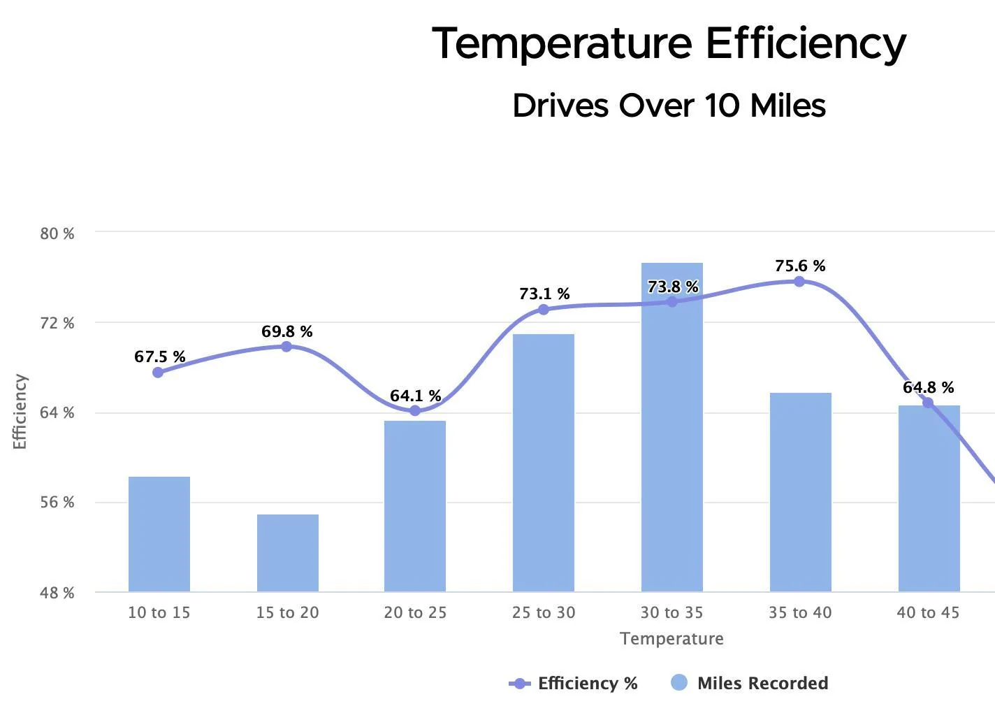

Here's my temperature data from electrafi.com. The efficiency percentage is based on 360 nominal miles, so at 10-15F we’re at 243 miles real world range. Most of those miles are slower than highway speeds.
TemperatureWh/MileEfficiency %Miles Recorded
10 to 15 F561.1367.5155
15 to 20 F549.8169.8105
20 to 25 F602.3364.1231
25 to 30 F526.3273.1346
30 to 35 F518.3673.8441
35 to 40 F508.9575.6268
40 to 45 F591.564.8250
Note, most of this is with 21" snow tires on 20" rims (calibrated to 20" tires). The 21" diameter should make them reasonably efficient, but they are soft.
