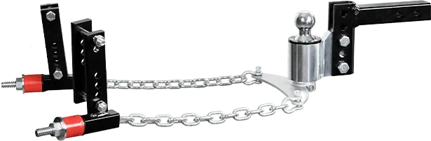

For a trailer that small and lightweight I would use an Anderson anti sway hitch:
https://andersenhitches.com/product/weight-distribution-hitch/
Rivian R1T R1S weight distributing, anti-sway hitches WDHitch
I actually used this for my Ford Raptor towing a 8k lb trailer and was able to greatly reduce the tongue weight. The raptor has lighter sprung rear suspension, so the truck needed it badly.
One advantage to this hitch is you can adjust tension in very finite amounts (using the threaded peices.) For those torsion bar type WD hitches I believe you only have a few preset positions. With that type of hitch you may end up reducing the tongue weight too much which is even worse for towing stability. To repeat the same tension levels with the Anderson I would just use a torque wrench to run down the nuts to the same value.
Also. the anderson is WAAAY lighter than a traditional WD hitch, and way quicker to hook/unhook. It's compact and easy to store. The install/removal is much safer too. I watched a buddy of mine nearly fracture is tib/fib removing his WD hitch when the torsion bar shifted off the pin. Scary stuff especially when you're out camping.
Lastly the Anderson hitch uses a friction plate on the ball itself, which will always give you some level of anti-sway. Anti-sway is probably what you need more than the weight distribution mechanism for a trailer that light. Also when turning/backing the trailer it did not seem to bind up as badly as a normal WD hitch.
Keep in mind a Raptor is ~6k lbs. The R1T is an additional 1k lbs (with a similar but shorter wheelbase), and your trailer is much lighter so I would not expect any issues. The R1T will help self level with the air suspension as well.
I tow a small offroad aluminum camper with a RTT that is about ~2000 fully loaded with gear with my R1T. I don't even notice it's there. I have no plans at all to run WD on there. If you keep your towing speeds reasonable, I would not expect you to need a WD hitch at all, but if you do want some level of anti sway protection AND the ability to adjust the tongue weight then the Anderson is the best bet.

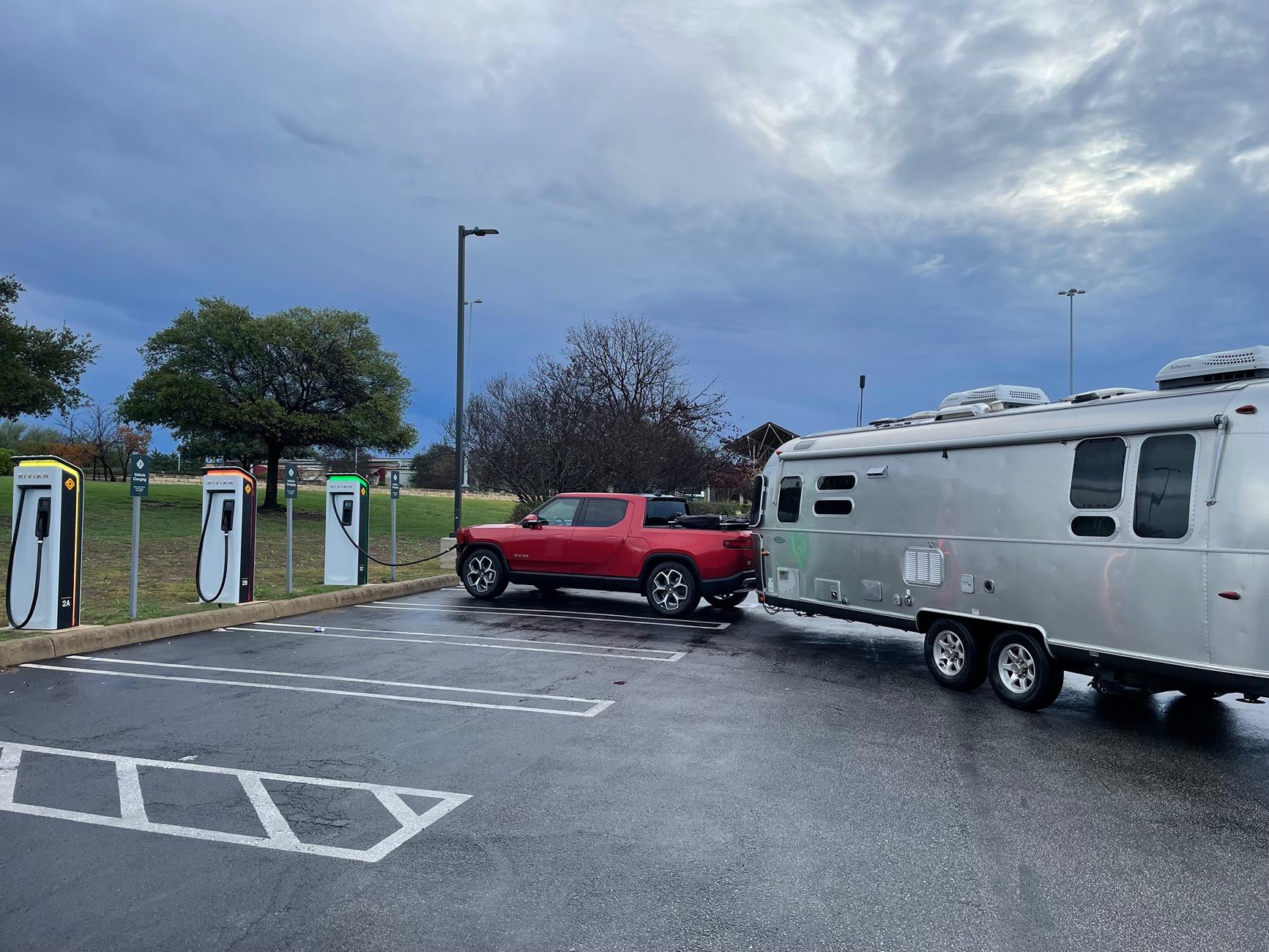

I have the R1T and tow a 25’ AS. Everyone will agree that towing with the Rivian is fantastic (except for the range). I do use an Andersen WDH and really like the simplicity, ease of use, and simple storage needs. The chain method vs the bars is much better, IMO.
Loving seeing all the AS / Rivian combos! Any issues with sway at all?

The Ridgeline manual is due to it being unibody as others stated, you need a frame to use a WD hitch which your R1T has. A good WD setup makes a world of difference towing, boat trailers typically don’t have the tongue weight for them to be needed. I like the chain style, find them easier to hook up than the bracket needing tools. My current hitch is a Curt w/ 1k bars, it works well for my Airstream 23cd (I’ve got an Aircrafters Onan onboard genset that adds to tongue weight). Make sure you measure at the height you want to tow at unladen when setting up the hitch, the suspension will level the truck once you hook up and throw off the geometry. It tows like a dream, I don’t run the anti-sway cams.

I use an Equalizer WDH for towing my 28’ Airstream with my R1T. Set it up for mid suspension height, then lowering the truck will increase weight distribution. - useful in high crosswinds. Raising the truck will lessen weight distribution, a real plus when entering rough ground or steep driveways. Shorter trailers are more prone to sway, and a good WDH will help with that. After 13 years of towing three different trailers with four different tow vehicles, I would not do so without a WDH. The R1T is the best tow vehicle that I’ve ever driven.
