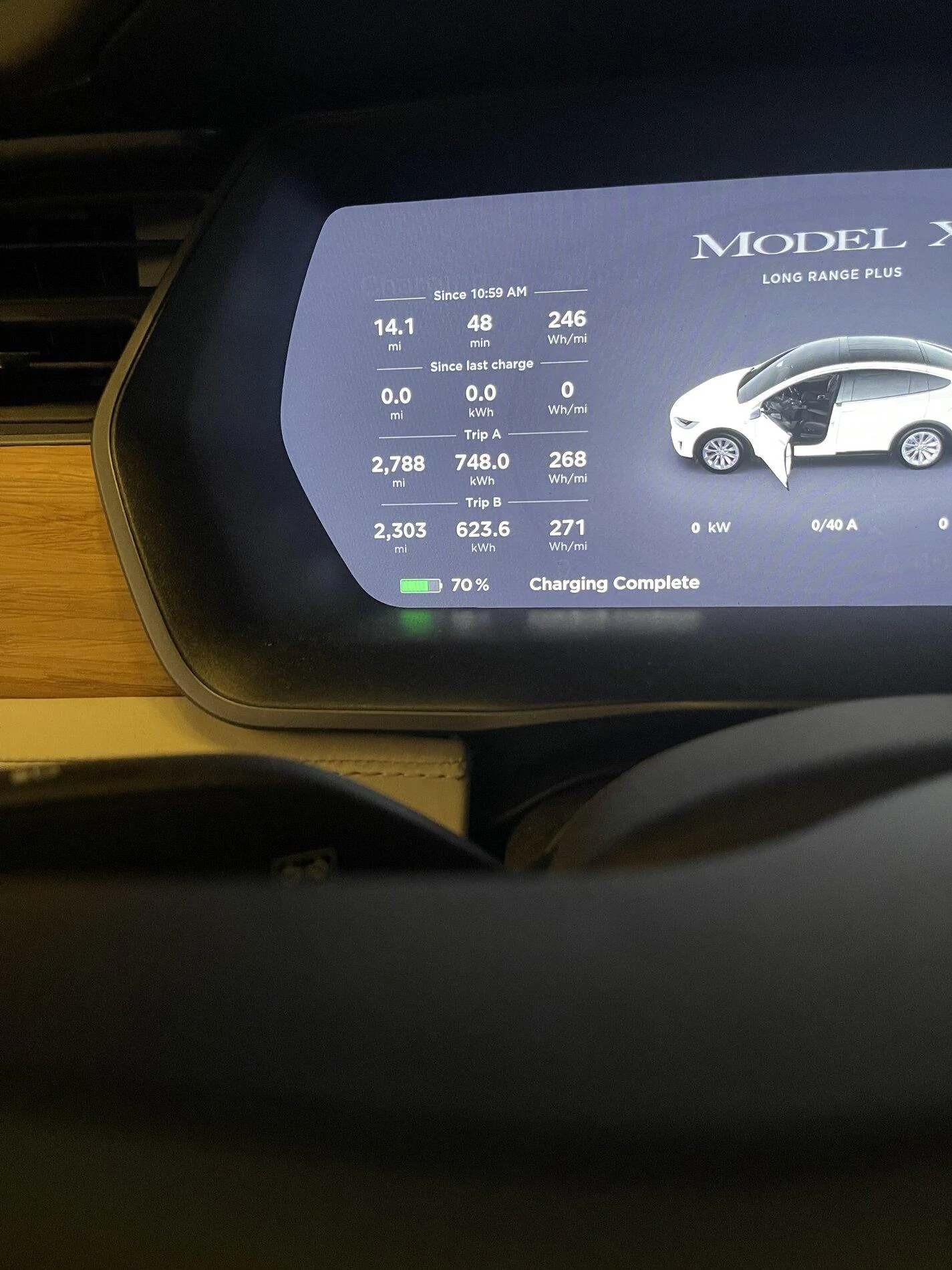

Sorry but yes and here's proof.
Rivian R1T R1S What would you do? Get LE version (300+) or wait for MaxPack (400+)? IMG_1648
Rated for this vehicle is 282 Wh/mi.

See image I posted while you were typing yours. All the trips shown exceed the EPA rating.
