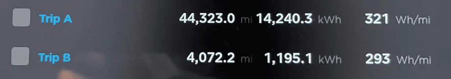

EPA is 340 Watts per mile for this Model S (see below from the EPA site), in the last 44K miles we have averaged 321 watt per mile, in the last 4K mostly my wife driving averaged 293 watts per mile.
In 44K miles we are below EPA by 5.6% In the last 4K miles with my wife mostly driving she has beat EPA by 13.8%. I will add when I am on the highway I usually drive between 75 and 80
