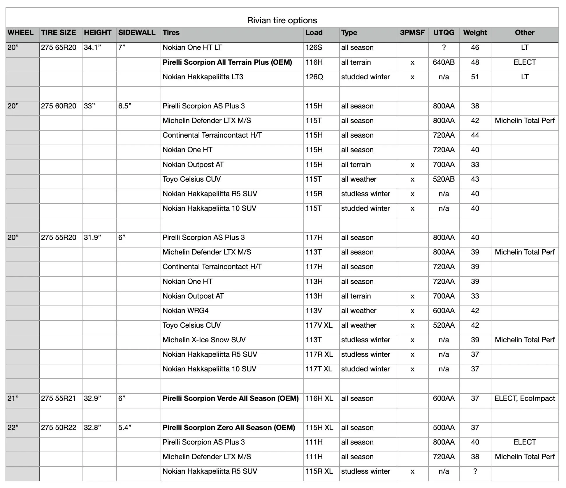

Any chance you could add tire weights to this as well? This could affect efficiency as much or more than tread pattern.
See below. The Pirelli Scorpion AS Plus 3 tire looks like a good option if you don't need all-terrain tires. You'd save about 10 pounds per wheel. I saw a Model X with AS Plus 3 tires the other day, maybe they're the OEM tires now.

There are a ton of typical ATs used by us off-roaders that probably should be on the list for comparison in the 275/65/20 sizing for LT E-load. Look at the Goodyear Duratrac, Falken AT3W, etc. I've been running the Falkens for years on my 4Runner and a ton of folks here in Colorado run the Duratracs. The biggest difference is going to be likely lower speed rating and a lot heavier tire. Most of the LTE tires I looked at in that size were closer to 55-65 lbs per tire, but they're well-regarded AT tires with thicker sidewalls. I strongly suspect that all the flats they had on the media drive were due to the stock Pirelli ATs being P-metric vs LT E-load.
Added BFGoodrich KO2, Dueler Revo 3, Conti Terraincontact A/T, Wildpeak A/T3W, and Goodyear Duratrac.

This is really helpful all, thanks. I'm going with the Pirelli Scorpion AS Plus 3s in 275/55 R20 to replace the all-terrains that are coming with mine. I will be doing some short distance, light, towing and will be all highway for me. Will post pics when they're on.
Love to know the range difference if you get to compare.

Good list, but I think the difference in diameter from 275/65R20 to 275/60R20 or 275/55R20 is too great; 295/60R20 would probably be the only acceptable substitution.
Unless they're pig-headed like Tesla they'll let us re-calibrate the speedometer to match a new tire size like every other car manufacturer.
But I don't have particularly high hopes, surprised this isn't required by law or something.
I created a similar list with all the compatible tires that ship to me and included price: Rivian Tire Options

DEFENDER LTX M/S - SIZE: LT275/65R20
Any reason why it wouldn't work? It is 34.1 inch diameter, all season, and exceeds the load rating. It is #14 in your list. Tire Rack wouldn't confirm it would fit though...
