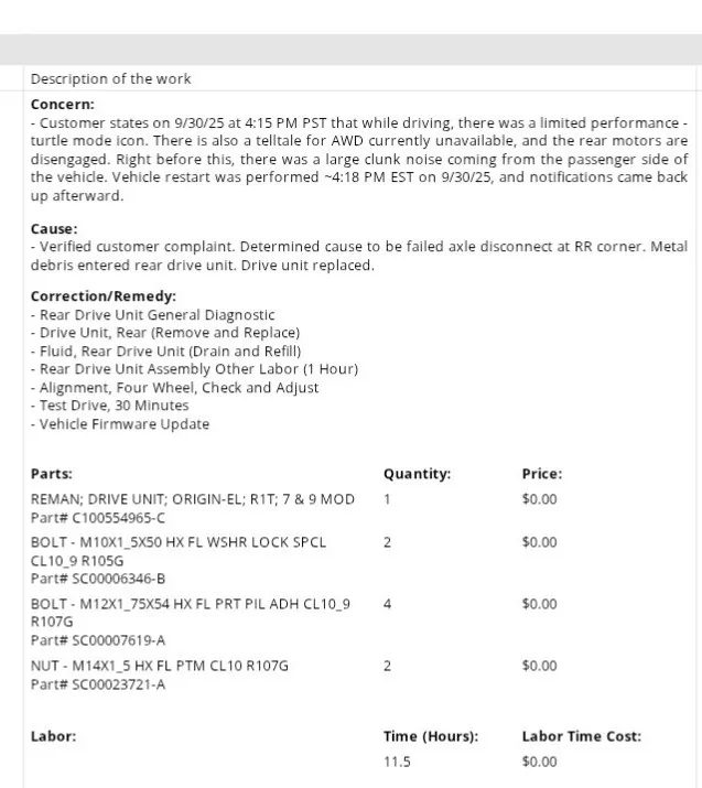

Well, they haven't said anything about rock sliders, but confirmed today it's not just the disconnect but the entire rear drive unit. Parts will delay it a week then it'll take a couple days to complete.

Is it too early to ask how? Also, is it covered? Cheers.

Probably is too early, if I see a tech at pickup I ask mechanical/technical Qs.
No mention of it NOT being covered, which she said at drop off she'd mention before any work began, so I'm going with... Under warranty.

It's really difficult to tell from the photos, but in your third picture it looks to me like something hit and damaged the half shaft at some point.
But my observations aren't worth squat. I would be very interested to hear what Rivian comes up with when you take it in.

Got it back today! Culprit: failed disconnect that threw debris into drive unit. They installed a remanufactured drive unit, which makes sense to me, but it's the first time I've seen refab'd parts for Rivian.
Rivian R1T R1S When it rains, your motor blows 1000006231
Halfshafts and ting washers were reused, guess they just needed some grease and tightening, because all my clunks are gone!
That's the good news, bad news is I got home and started hearing a hiss from the left rear... I couldn't isolate it, but took measurements of damper and tank pressures to see if they drop.
Refab parts are now common afaik - both of the ‘New‘ AXM2.0’s I’ve been given under warranty are refabs.
