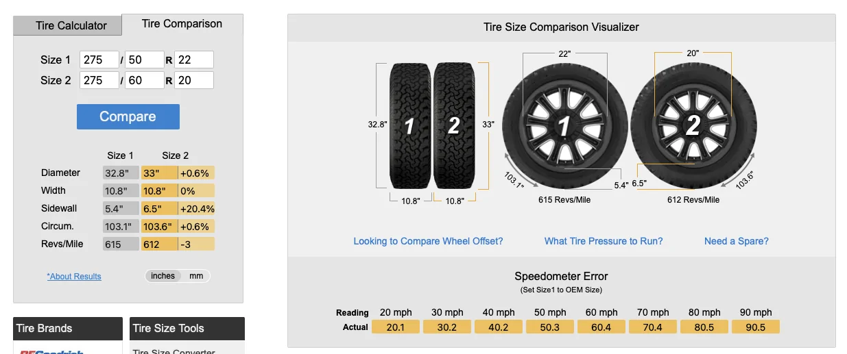

My question is about the tire size. This tire that DT recommended at 275/60 is 0.2" taller than the stock 275/60. Will this be ok if used temporarily if I have a flat?
275/50 R22 = 33.8" tall
275/60 R20 = 34" tall

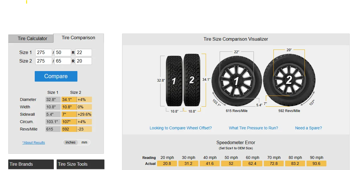

In this quote, you’re giving the height of a 275/65r20 tire - as shown in the tire comparison above a 275/60r20 it’s almost identical to your current 22 inch rim equipped tires.
Ahh yes you are correct!

That tiresize site is pretty cool!
But now that I see my 275/65/20 KO2s on my Ram 2363 wheels are quite a bit taller than my OEM 22s haha.
Oops! But I've been running them for a long time in all purpose/standard height. If I go lowest, it will rub when I hit a dip at speed and very slight rub at full lock on slow turns.

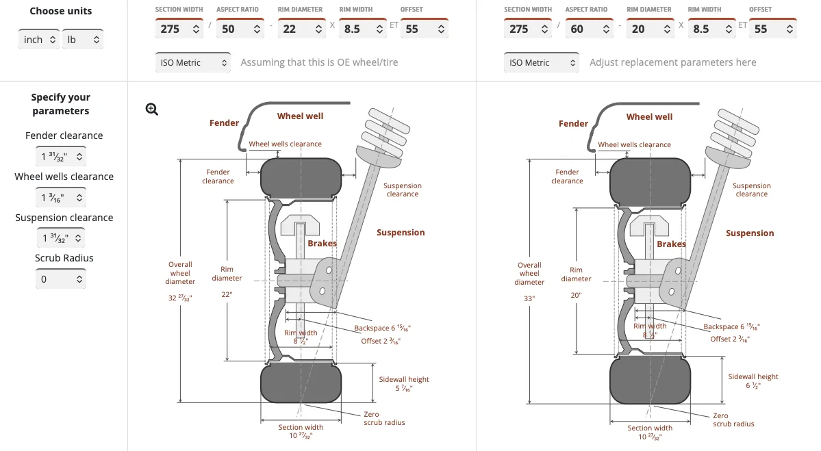

This following site is even better if you have more details.
https://www.wheel-size.com/calc/?wh...-20X8.5ET55&fcl=50mm&scl=50mm&wcl=30mm&sr=0mm
