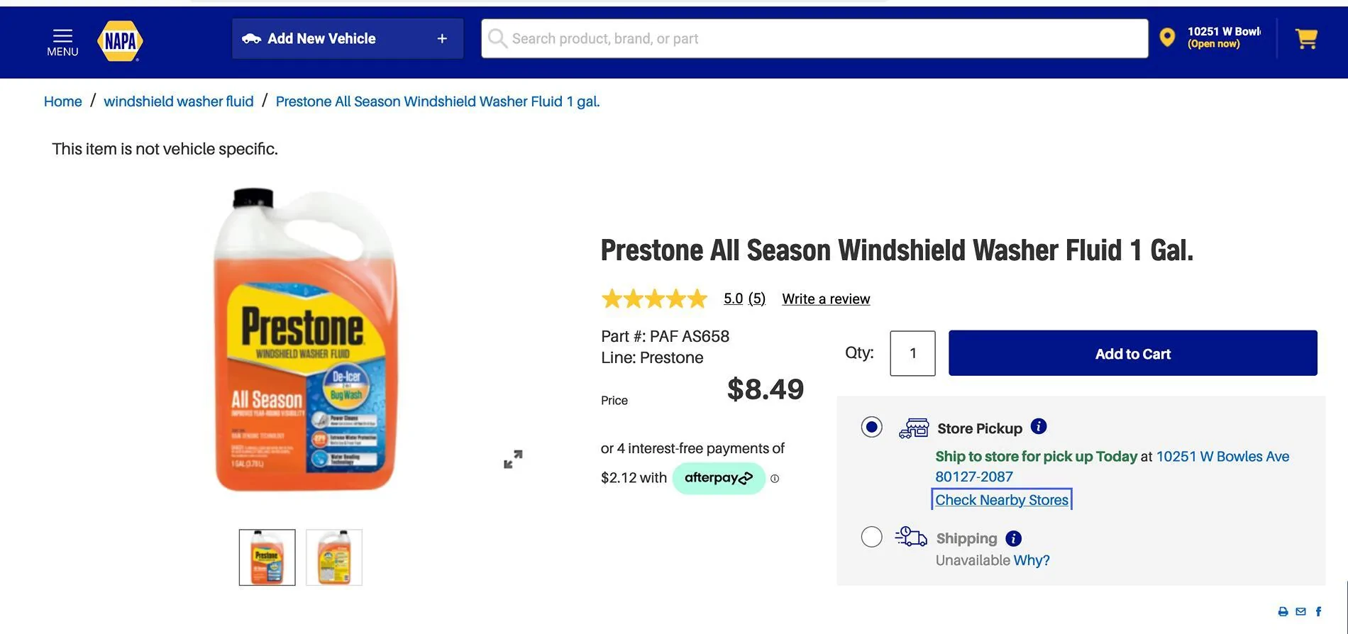

It looks like my local NAPA has this stuff in stock for a much better price. Am hoping the -27 is good enough for the CO mountains. I had the factory stuff not working well on a -20 degree trip back from Steamboat the other week. Fluid was barely coming out of the nozzles. Flow is back to normal once things warmed up to ~30 degrees or so.
