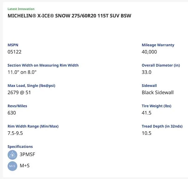

I have the 20” AT currently. The Nokian Hakkapelitta R5 SUV seem like they would work but I can’t find any.
If you can't find the Nokian, try the X-Ice Snow. Michelin just added the 275/60R20 tire size according to their website.

I like them too but the current model only supports a load of 115 and the R1S at least needs 116. My local tire center wouldn't install them. The 65R20's do. I suppose they're more truck constructed so likely heavier and costlier

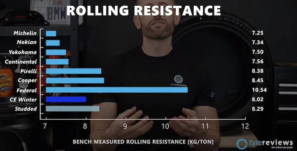

Aren’t the 20” tires snow tires? They have a triple peak rating don’t they?
That doesn’t make them ‘snow tires’. 3peak and snowflake means they’ll do better than most all seasons in the snow. But true snow tires a much better.
Also, these Pirellis haven’t compared well with other 3peak and snowflake rated ATs. I’m guessing that is related to the rubber composition being more oriented to lower rolling resistance for an EV.

Michelin X-Ice with the XL rating
the OEM 22s are 115
