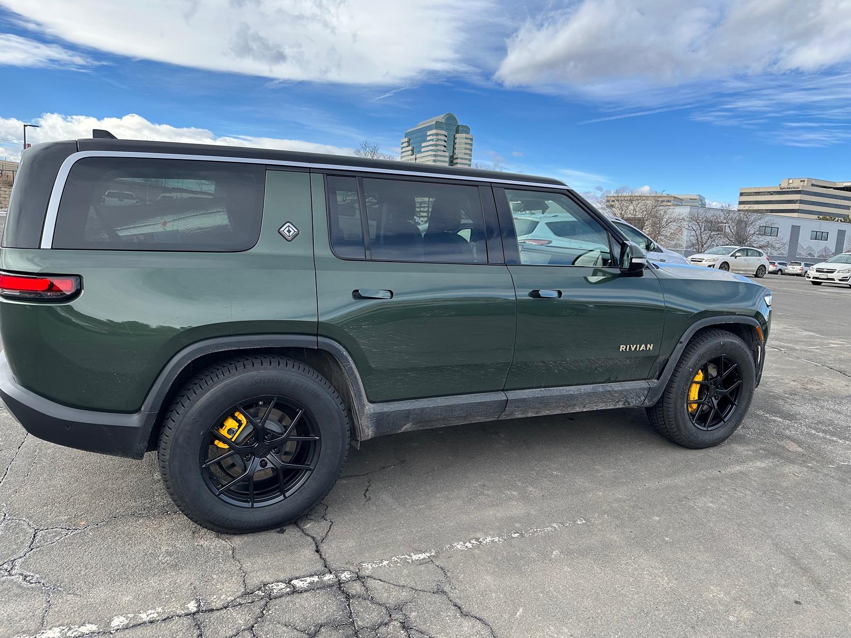

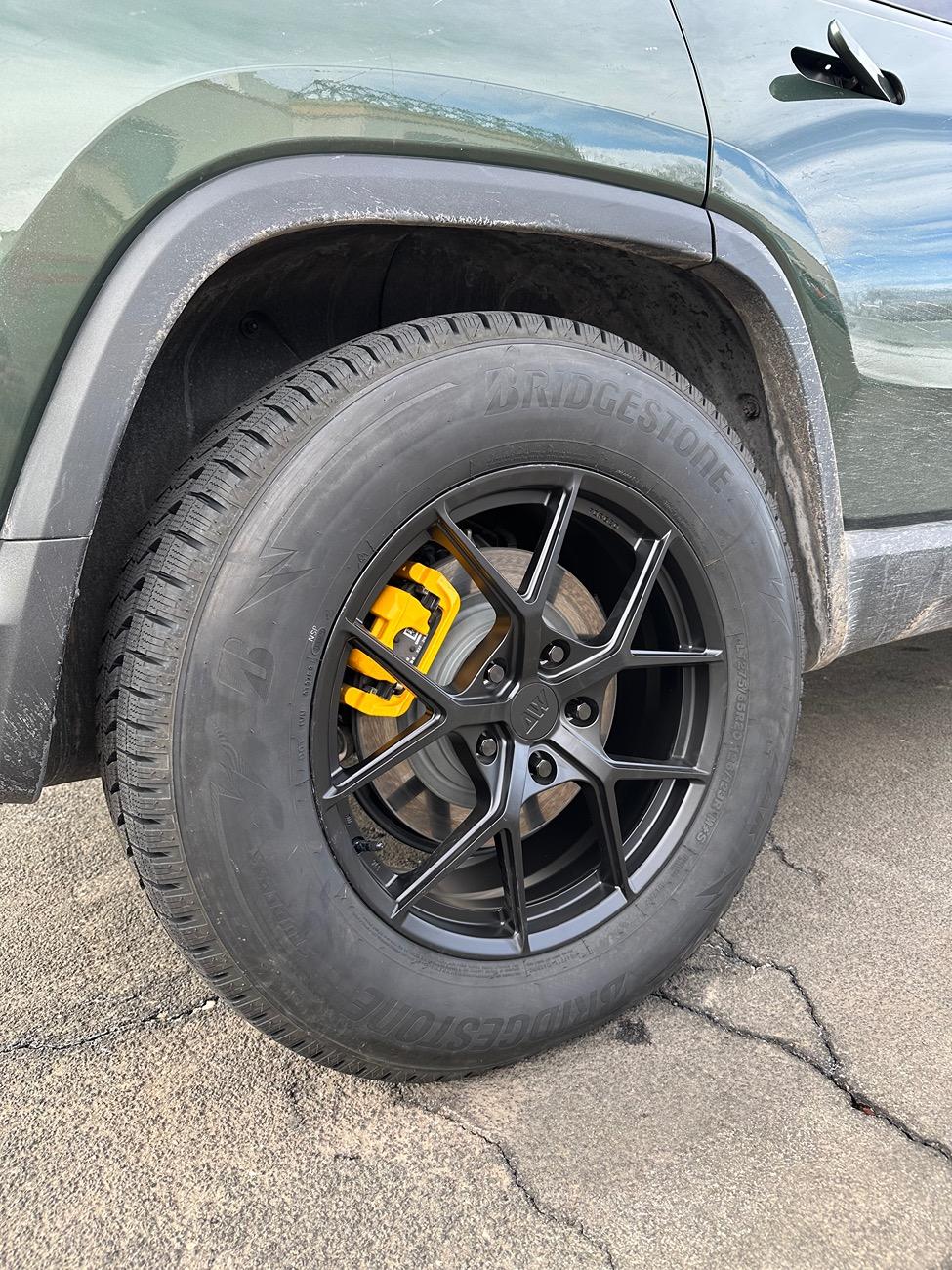

I am really liking the Atomic AW01 wheels with Blizzaks! It really does feel like the steering is much lighter with the wheels vs the stock Rivian 20s. Discount tire mounted the tires on the wheels straight out of the box.
I’m spoiled to have the second set of wheels now. Going to test them in the mountain snow soon. The new tires are SO quiet I don’t want to put the pirellis back on.
