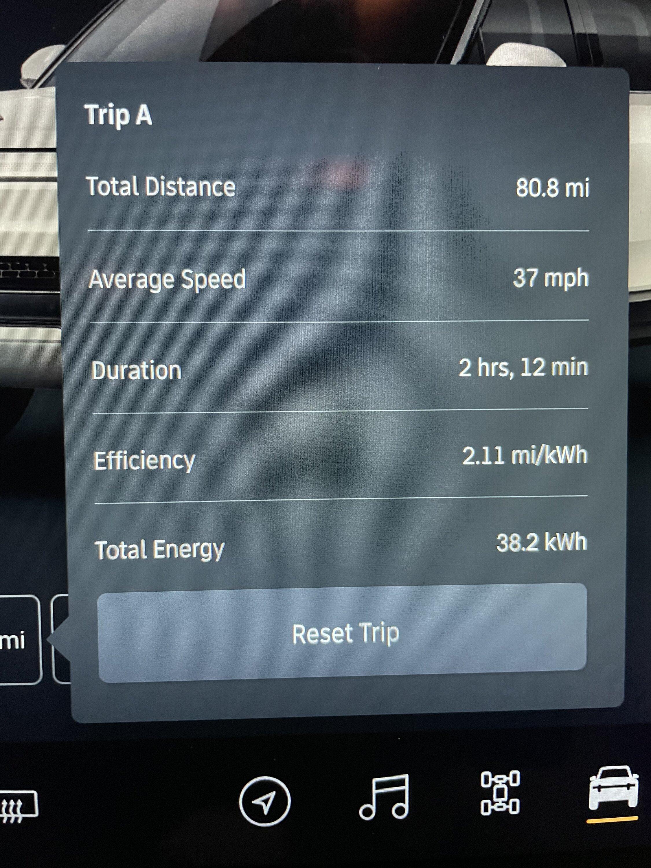

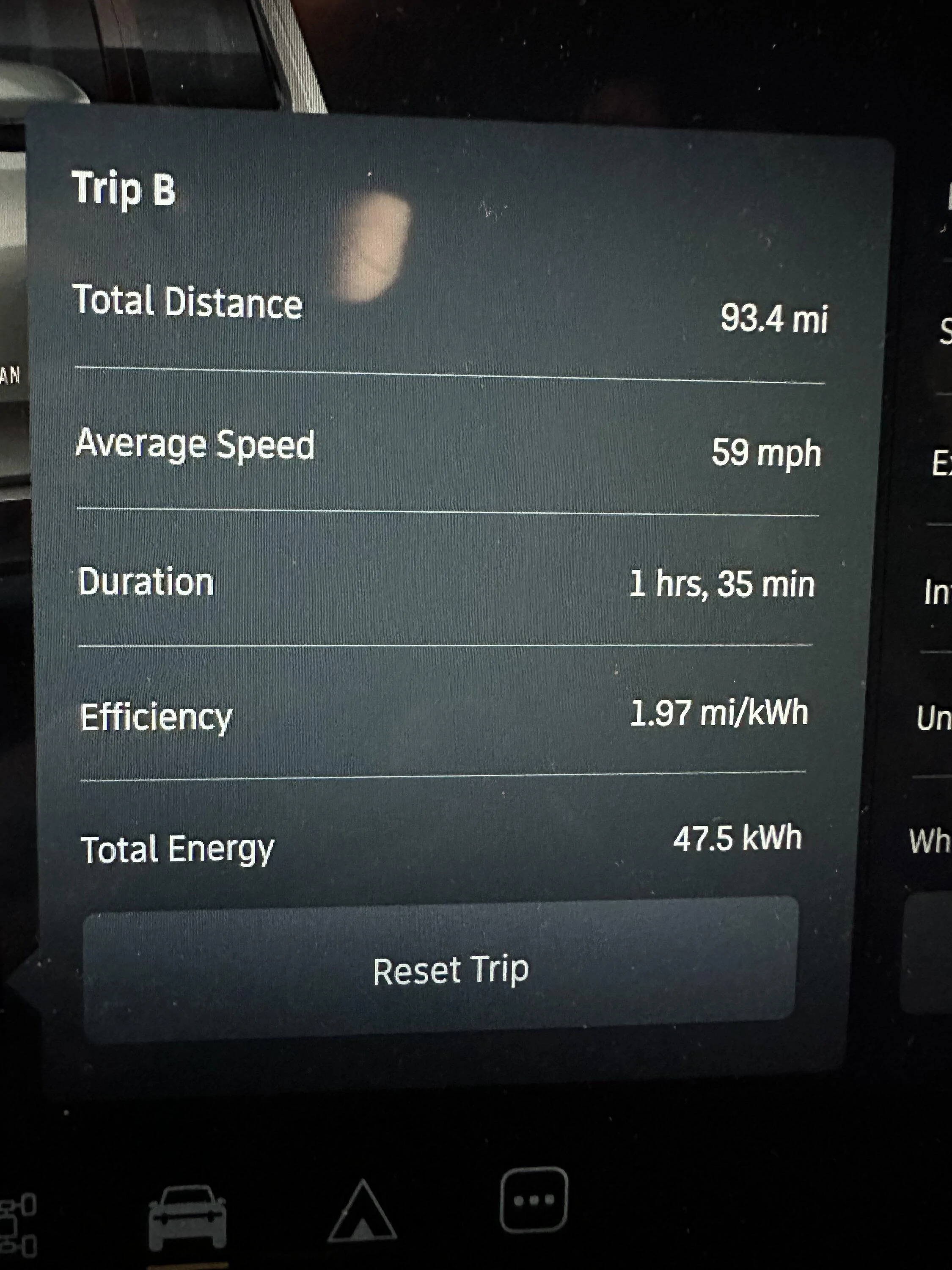

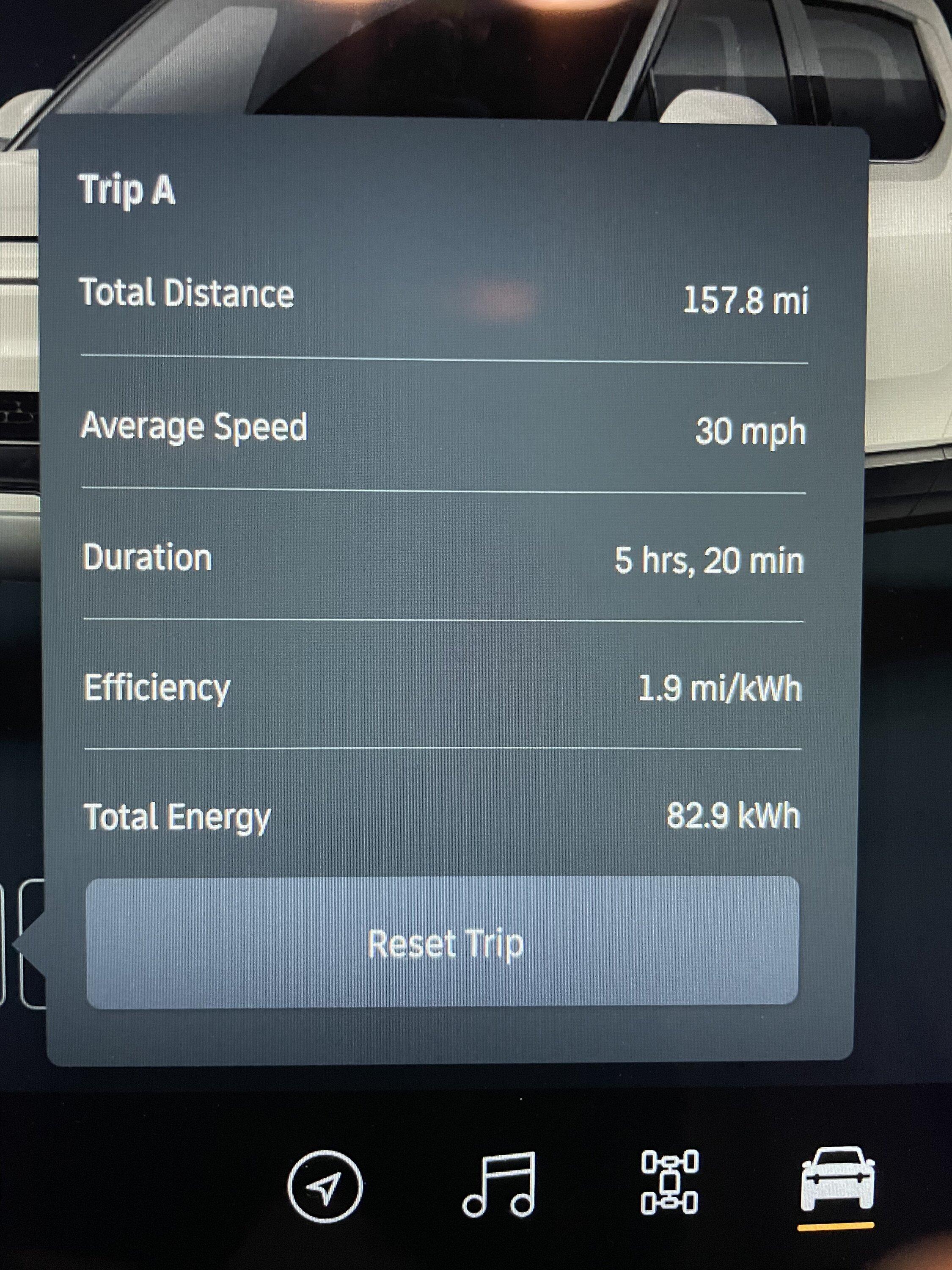

Rivian R1T R1S With temperatures dropping is anyone else already noticing range losses? 54FD1FD7-18F8-46E5-96B7-0A896115ABE8
Rivian R1T R1S With temperatures dropping is anyone else already noticing range losses? 87683D53-F517-4B3F-AD8C-1A3C4CC42EFA
Non scientific….
New EV owner in western PA.
My drive routes and style haven’t changed in the two weeks of R1T ownership.
I drive a little over the speed limit with front climate on 70. Outside temps were in the mid 70s last week and now in the 30s for highs.
All purpose mode with low suspension. Have also used the heated seat and steering wheel in the colder weather. Again, no attempt to consider range or efficiency as I’m not far from my home charger as I tool around.
I was consistently seeing 2.1-2.2 KWh when temps were in the 70s. Last few days I’m seeing 1.9 kWh with temps in the 30s.
I was charging nightly to 70% but think I will go to 85% in cold weather. I’m driving 60-80 miles a day. The one picture shows a 157.8 trip but that was the last two day’s combined (30 degree temps) since I forgot to reset during my nightly charge cycle.
Non scientific. Just my usual everyday driving style (same as my ICE vehicles). I’m keeping an eye on this……
