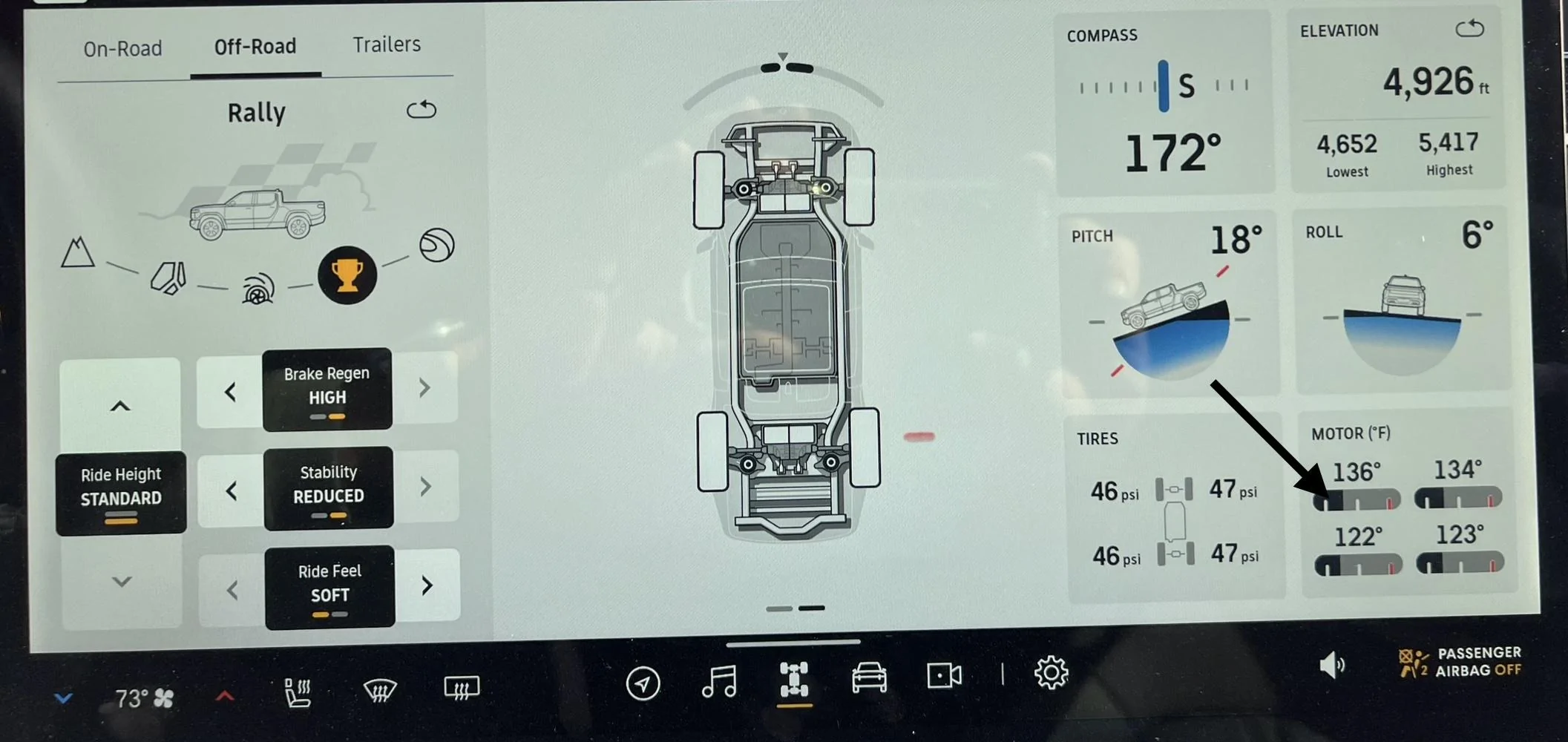

FWIW. Here is a photo I took the other day while out doing a little off roading. Note the black portion of the graphic. This will slide to the right as the motor heats up. Ultimately, in my latest case, that black portion began to turn orange/red at around 265+/- degrees. That’s what got my attention. On a closer look at this photo, I can see there is a small vertical red line at the far right of the graph. I had not notice this before. While my one motor was heating to the extent that graphic bar was turning reddish in color, it had not reached that vertical red line. This may be an indication that all was working within spec, if getting a little toasty.

So, I went out for another drive, just now. Pretty much the same scenario as before - cold night, current day temp in mid-40’s. Drove roughly the same distance, terrain and speed. This is what I got after about 7-8 miles. On the driver’s side, front motor, shortly after peaking out at 271 degrees, just shy of the red line, the motor temps dropped pretty steadily back to the normal range. This time I did not reduce the regen level, keeping it on high regen. I might also add that the vehicle efficiency was way down. I’m averaging around 2.8m/kWh over the last 1000+ miles. During these last two events, I was under 1.6m/kWh. I do realize the cold weather and cold battery didn’t help, but that was quite a drop.

Read OP’s follow up post, man. The bar turning reddish is NOT over limit indicator. The red hash marks is that limit, which his vehicle did not reach. It did not overheat. Period.
