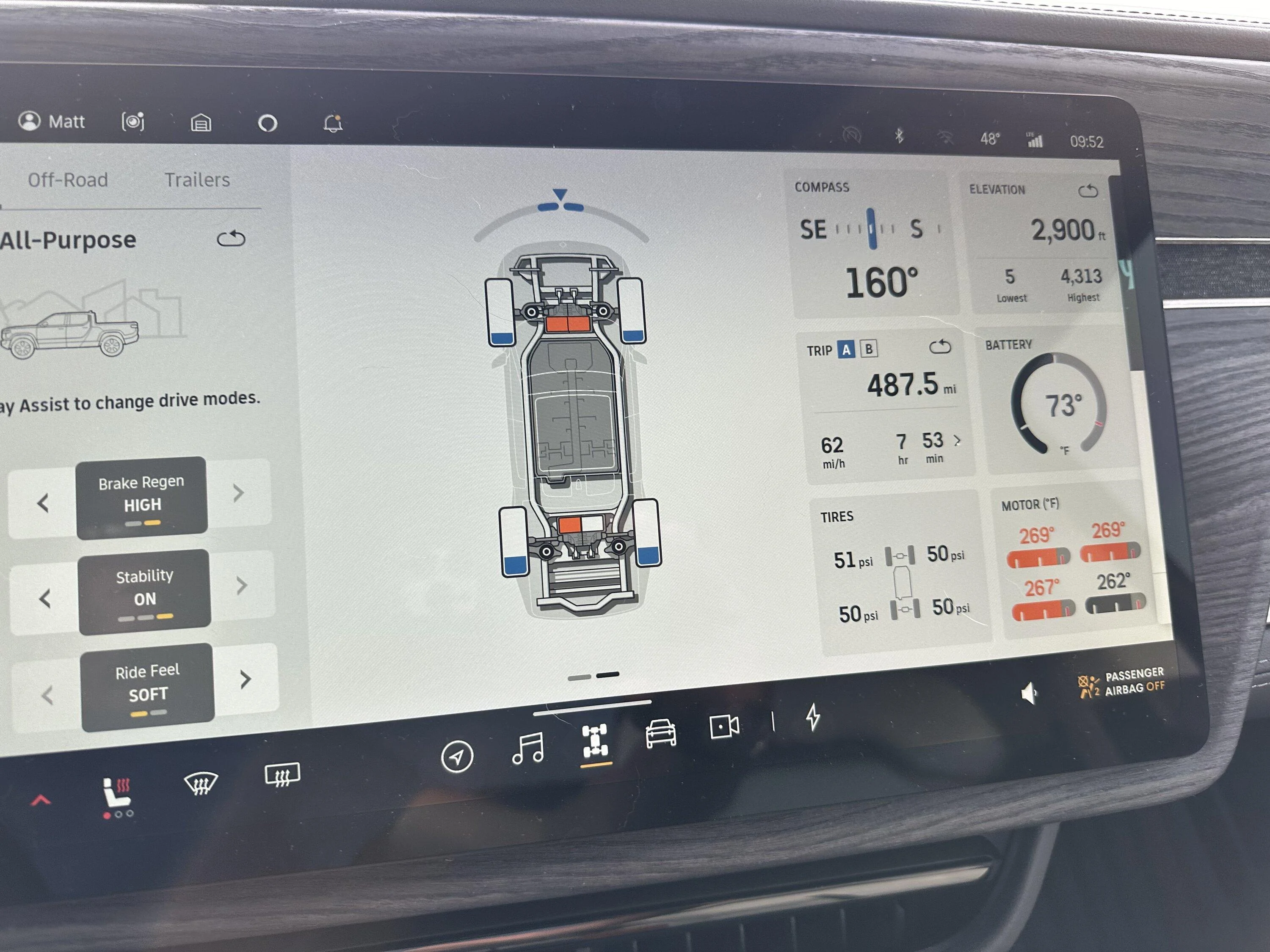

Since the last update, I've put about 1,000 miles on my R1T. 800 of that was on a trip from the Bay Area to Seattle. While watching the display driving up, all 4 motors were running about 150 degrees and the battery was in the 70-ish range.
Yesterday when I got into the truck and shifted into gear, I received a "Acceleration and Regeneration performance limited while battery is warming" message. I was only driving about 4-5 miles on this errand so I watched the display. The battery temp was about 47 degrees and immediately after pulling out of the driveway and moving, the motors had a different pitch to them and they heated up into the 200+ range. When the battery go up to about 50 degrees, the motor pitch went back to normal and the temps dropped back down to the 150 range again. My average consumption was about 1 kWh/mile. No error codes were thrown
My conclusions from this observation are that this is normal behavior when the battery is cold as the only way to warm it is to get the motors hotter than normal.

FWIW exact same thing happens while preconditioning on the way to a DCFC. Observed multiple times this last weekend.

Same here. I had been on the freeway for over an hour on the way to a charging stop. The GPS gave the preconditioning warning and a few moments later I looked at the details. In the screen shot below you can see the motors are getting warm, yet the battery is still cold. A few moments later the preconditioning notice disappeared and the battery was up to about 80 degrees. As soon as it quit preconditioning, the motor temps dropped rather quickly. Again, the motor pitch was different while warming the battery.
Later Friday the weather had warmed up into the 80s and battery temps were up above 100 before another charge stop. In this case, the preconditioning was lowering the battery temp so it could absorb charging heat. You can't view the battery temp while charging, but you can right before and after and there's a noticeable difference.
This is a smart truck and so long as it's not throwing codes at you, it appears to be operating as designed.
