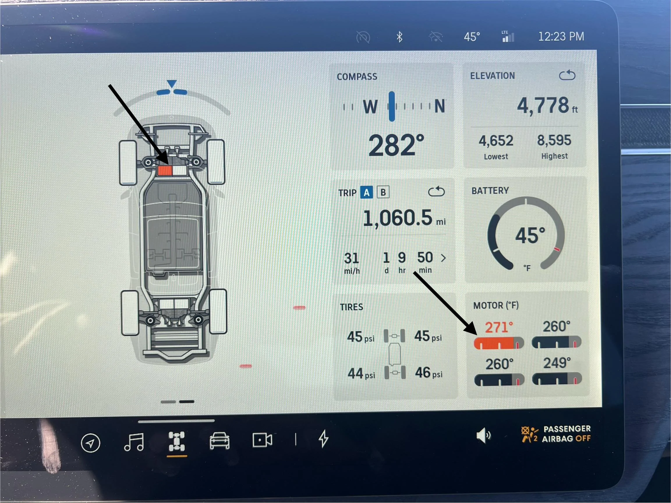

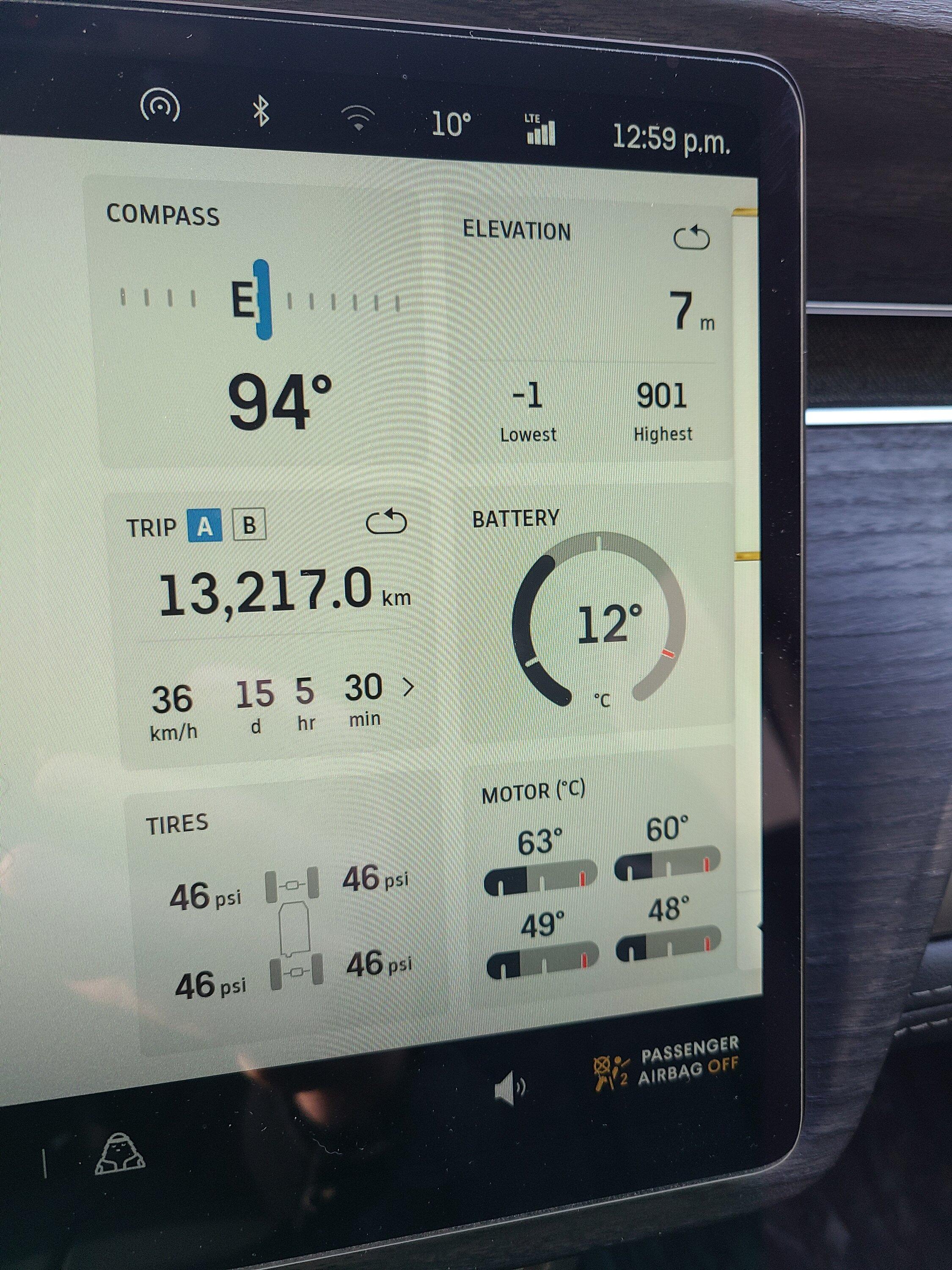

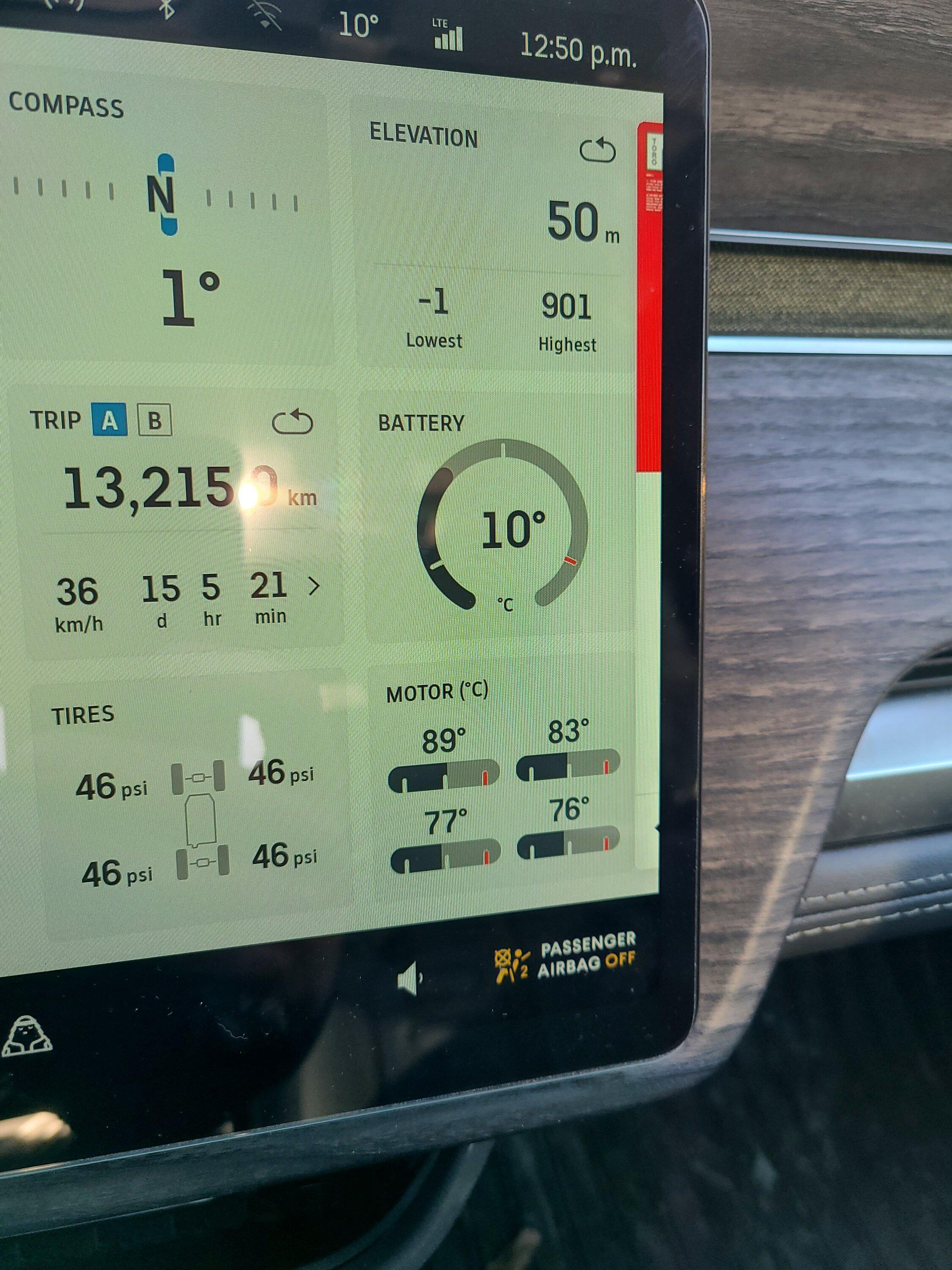

So, I went out for another drive, just now. Pretty much the same scenario as before - cold night, current day temp in mid-40’s. Drove roughly the same distance, terrain and speed. This is what I got after about 7-8 miles. On the driver’s side, front motor, shortly after peaking out at 271 degrees, just shy of the red line, the motor temps dropped pretty steadily back to the normal range. This time I did not reduce the regen level, keeping it on high regen. I might also add that the vehicle efficiency was way down. I’m averaging around 2.8m/kWh over the last 1000+ miles. During these last two events, I was under 1.6m/kWh. I do realize the cold weather and cold battery didn’t help, but that was quite a drop.
Mine has done the exact same thing. Same front left motor in the orange, and others still grey, but similarly toasty. I posted it elsewhere to help another user sleep at night.
It raises the motor temps in the same fashion until my pack temp got to 12C (Canadian Maple Syrup units) from that temp onward, all motor temps immediately cooled down to around 20-30 degrees C.
Nothing abnormal.

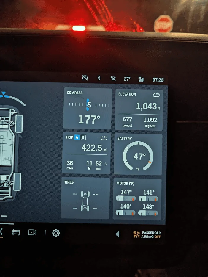

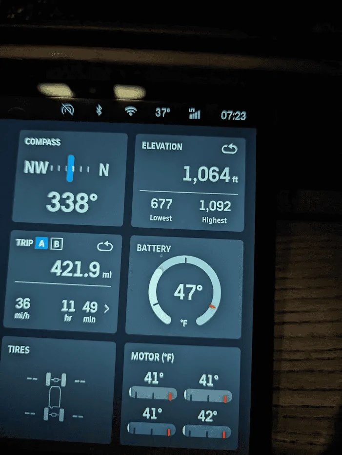

Start of my drive this morning:
Rivian R1T R1S Yikes! Overheating motors. 1698677363756
Three minutes later when I finally got out of my subdivision. 25 mph speeds.
Rivian R1T R1S Yikes! Overheating motors. 1698677419399
I didn't take any more photos this morning but the temps creeped up until the first motor hit orange at 54F battery temp, then they all plummetted back down into the low 100s. Guessing the threshold for starting this process is < 50F based on your observation and mine. I did no preconditioning and the motor temps fell every time I was at a complete stop.
I did perceive the motor noise to be somewhat different while this process was ongoing and I was traveling at a low rate of speed. But entirely possible it's just observation bias.

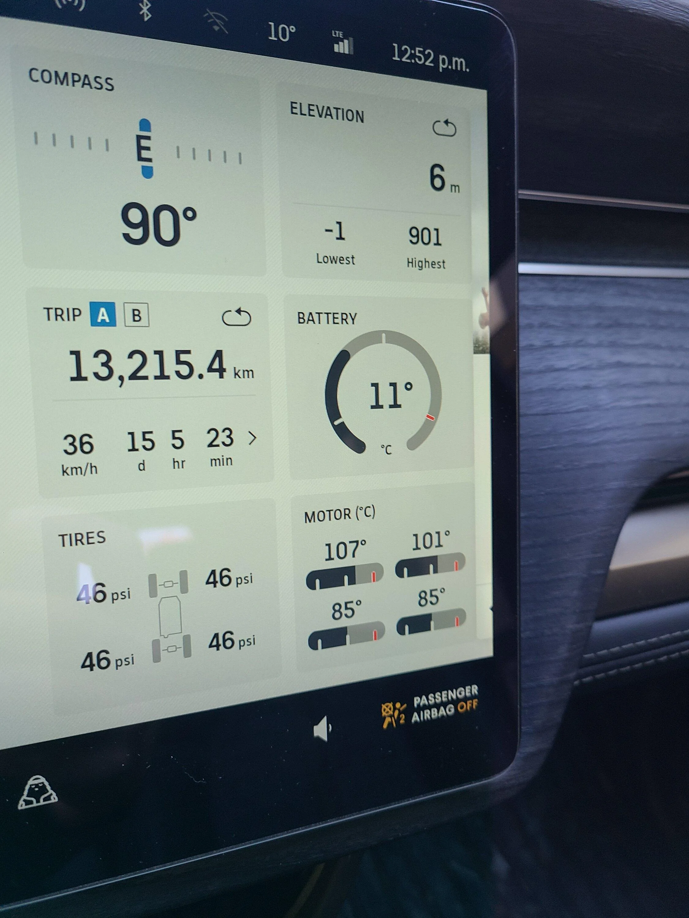

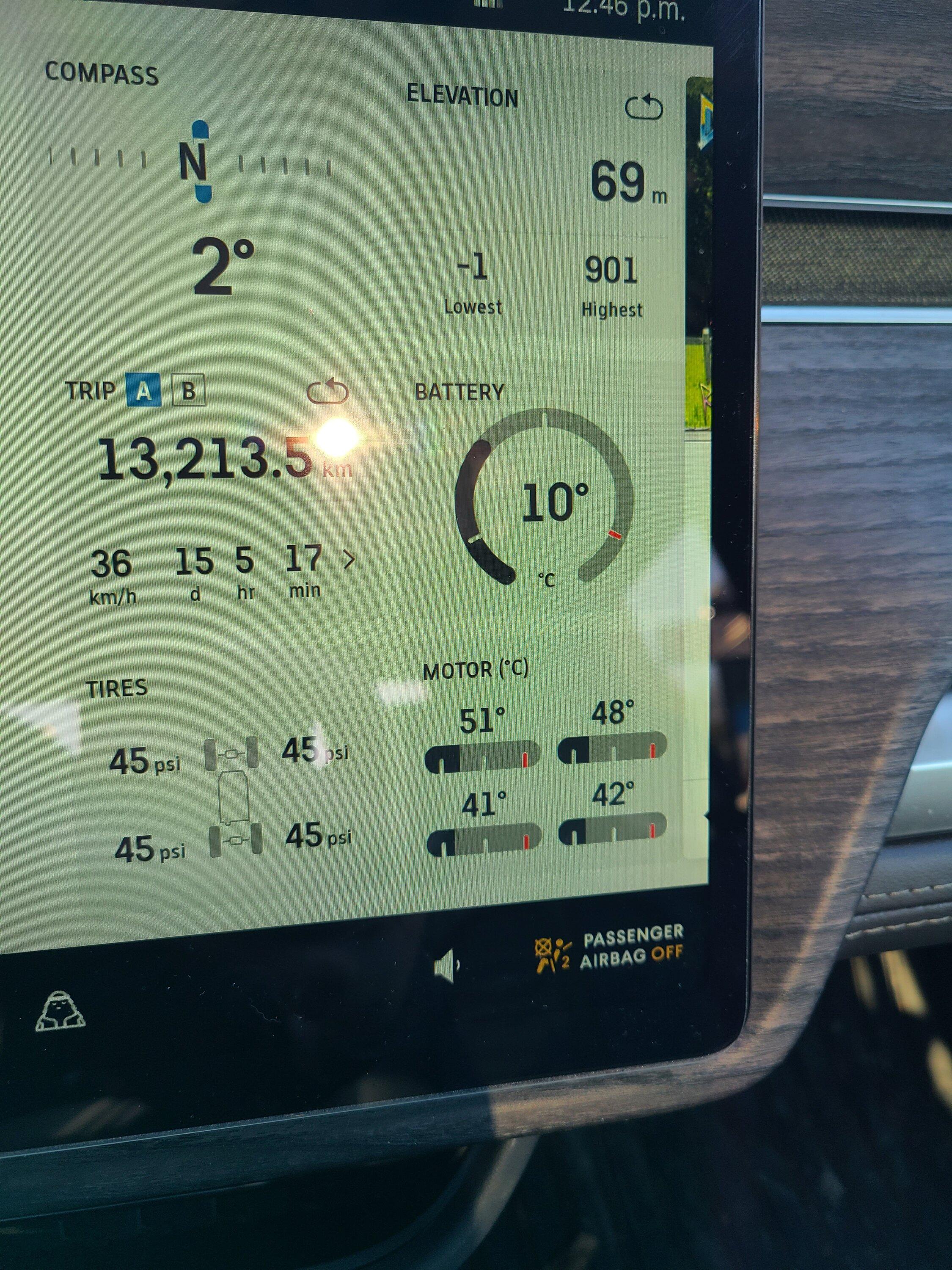

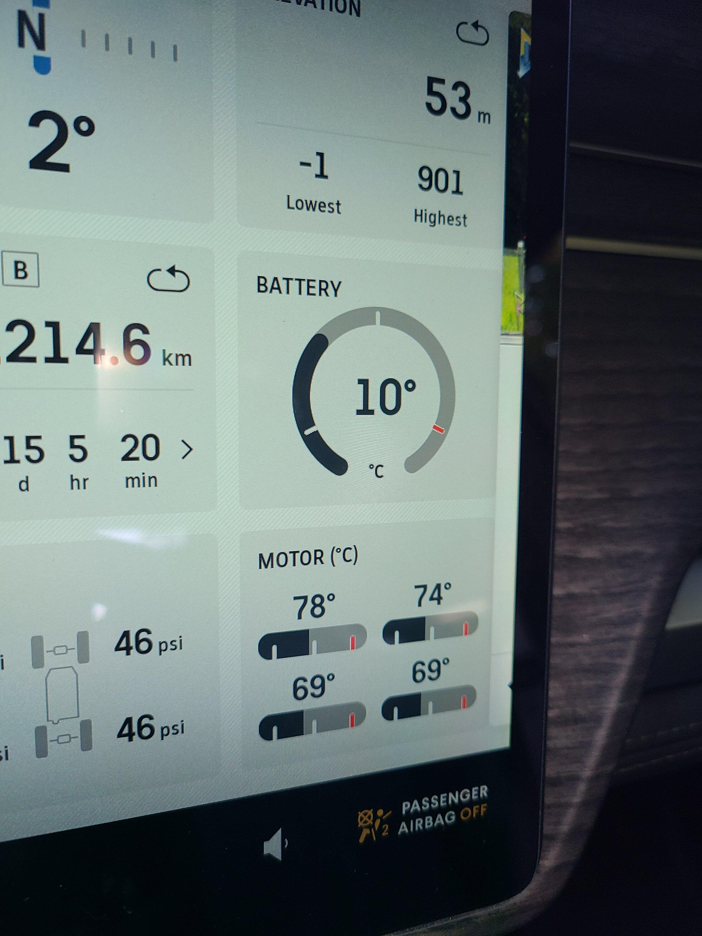

My drive the other day.
My drive the other day. Didn't hit the orange on that occasion as battery temps had leveled off prior. This was over 13 minutes of driving. Neat to see how things work, but nothing that's concerned me.
