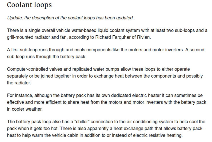

Interesting that although there is no air-source heat pump, the cabin and battery can be heated with waste heat from the motors and inverters.
For a long time there was speculation that Rivian would exclusively rely on PTC heaters that would suck range in the cold. Nice to see that they were able to scavenge enough heat to avoid that.
I don't know about the speculation but the video seemed to reflect precisely how the system was described by Richard Farquhar back in Nov 2018.
