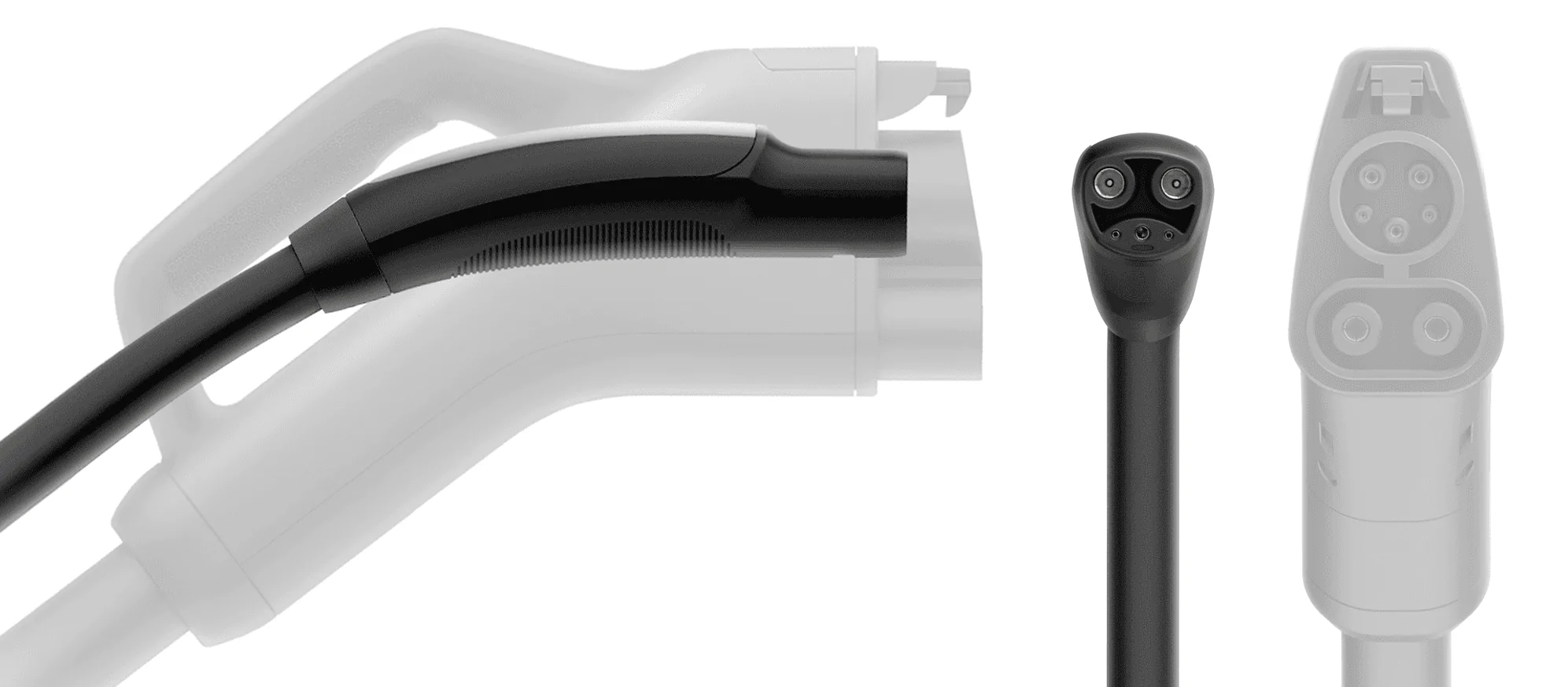

Tesla is opening up their proprietary charging solution,
Opening the North American Charging Standard | Tesla
Hopefully this will improve the CCS standard, or Tesla will get more to adapt to their standard. Whatever it is this is a good move (whatever their motive is).
Rivian R1T R1S Tesla opens up their EV connector design to the world (North American Standard) NACS-Blog-Image-02

After using a Tesla SC and charging with their cables, I can say going to the other end to use those CCS cables terrifies me. The Tesla SC cables are no larger or heavier than the L2 Charging cable I have in my garage.
What type of magic or voodoo Tesla does to get those cables slim and the charger so small, CCS needs to adapt to it.

3. Other Considerations 3.1 On-Board Charger DC Voltage Withstand Tesla’s implementation has the AC input of the on-board charger directly connected to the fast charge link. With this implementation, DC high voltage will be applied to the AC input of the on-board charger whenever DC fast charging is active. The on-board charger must be designed to withstand this DC voltage and must not attempt to convert power when DC fast charging is active to avoid damage to the on-board charger power converters. The maximum DC voltage that the on-board charger must withstand can be derived as the greater of maximum pack voltage and maximum voltage seen during the DC charging external isolation check If the on-board charger cannot meet this voltage withstand requirement, an alternative option is to separate the on-board charger from the fast charge link using relays or contactors. Failure modes of DC EVSEs must also be considered when choosing the maximum withstand voltage. Tesla has encountered situations where DC EVSEs applied higher than expected DC voltage during external isolation testing, caused either by vehicle or EVSE malfunctions, resulting in damage to the on-board charger or other components connected to the fast charge link. An example of this is EVSEs rated for maximum voltage supported by the CCS standard unexpectedly applying this maximum voltage to a vehicle advertising it does not support this range. While it is not required to ensure there is no damage to components due to this failure mode, manufacturers should consider this malfunction when designing the system and at minimum ensure the failure is contained and does not pose safety hazards.
This is exactly why I prefer the CCS method. I don't like the way Tesla exposes the OBC to the external HVDC. I think it's bad engineering.
