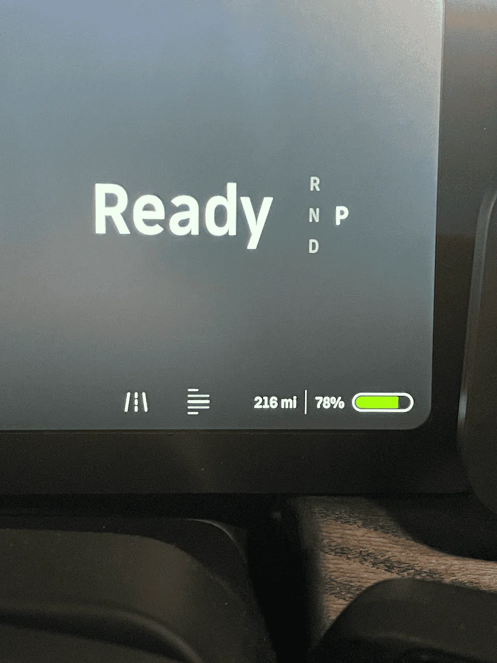

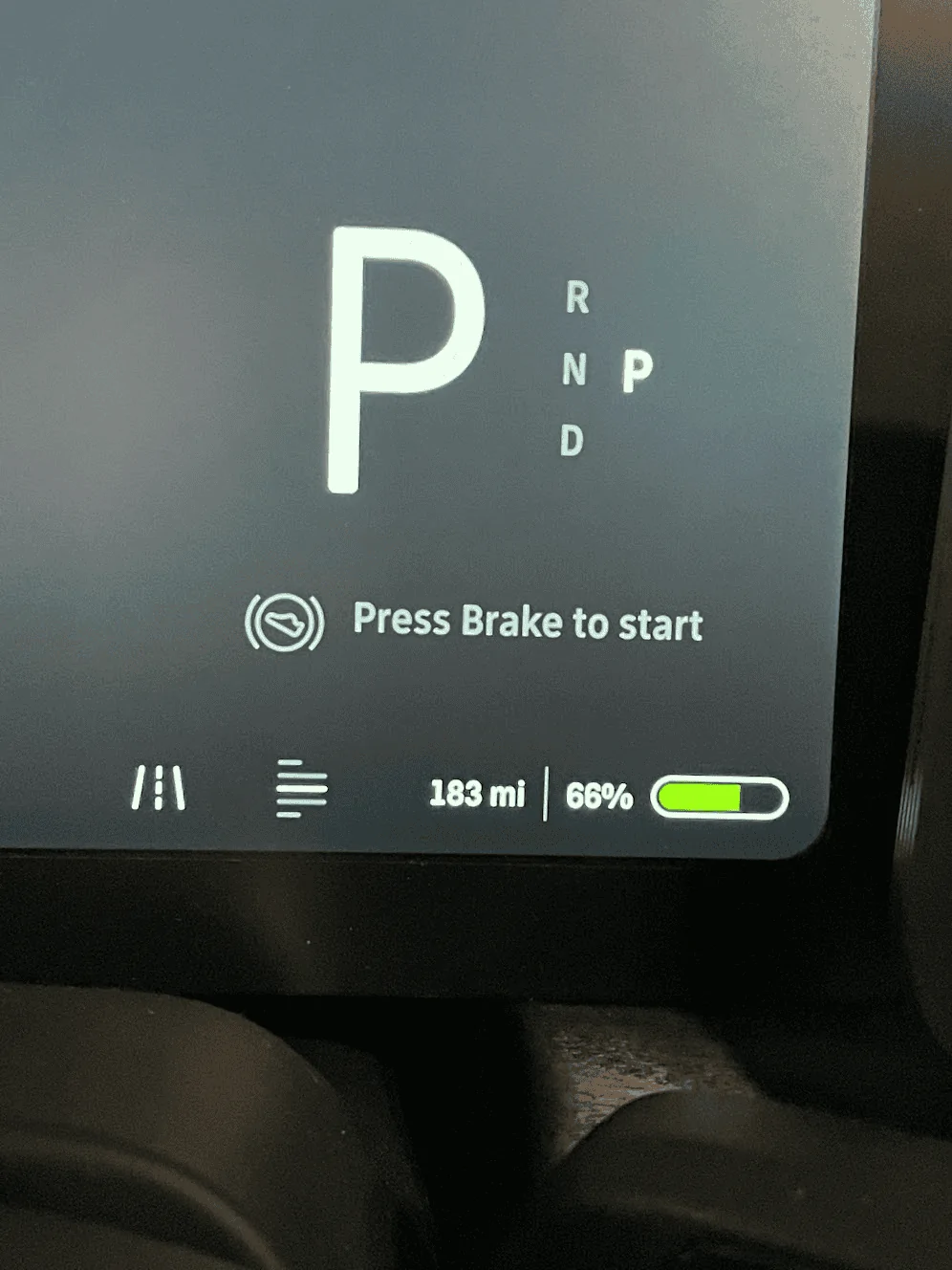

I've seen a lot of people post about battery loss while parked for extended periods so I wanted to give my recent experience for a benchmark. I've been on travel the last 10 days and decided to use this time to test what I can expect for future trips I may have. So background, my condo building garage does not have any means of charging (not even regular outlets) so all my charging the last 5 months of ownership has had to be at public chargers, luckily there are numerous of them readily available within a few blocks of where I live. The vehicle is in Colorado however it was left in an underground parking garage with relatively stable temperature this time of year.
Vehicle Setting and Stats
R1T - Vin 10XXX
Gear Guard: Off
Camping Mode: No
Vehicle Drive Mode: All Purpose (I don't think this makes a difference)
Ambient Temperature while Parked: 40-50 Degrees
Rivian App Usage: Two Check-ins, Day 3 and Day 7 (I unfortunately did not document range on these check-ins, it was more just to see where things were at to make sure the truck wasn't rapidly draining)
Starting Charge State and Range Day 1: 78% & 216mi
Ending Charge State and Range Day 10: 66% & 183mi
10 Day Charge State Loss: 12%
10 Day Range Loss: 33mi
Average Loss per day: 1.2% & 3.3mi
My Thoughts - I was pleasantly surprised with these figures given the other stories I've seen. While I think these numbers could be better as you compare to other manufactures and their minimal range loss while parked, for Rivian this seems to be closer to ideal today. I feel there is one main factor for why this number may be better than what other Rivian Owner's have shared - stable ambient temperatures - the truck being parked in an underground garage where temperature fluctuations don't really occur I feel could be a big factor in the battery temperature remaining stable.
I do have one other unique thing that may play a role but I have no facts to support it beyond just my own hypothesis. I have never set up gear guard - in the 5 months of ownership I have never gone through the process of setting up and activating/turning on gear guard. While I know you can turn off gear guard and that surely makes a difference while parked long term, I feel never setting it up could also play a role. Again, there is nothing to support this since I don't know the backend of how the Rivian computer software works but having never activated this feature it could be one less process the computer has to go through while it boots, checks status, and reports home.
In the end, I am happy with how well it did over these 10 days and while there is room for improvement hopefully with future software updates it does give me far more confidence for long term trips I may have in the future.
Day 1:

Day 10:
Rivian R1T R1S Battery Vampire Drain Test for R1T: 10 days parked unplugged = 1.2% per day loss. 1671393254062
