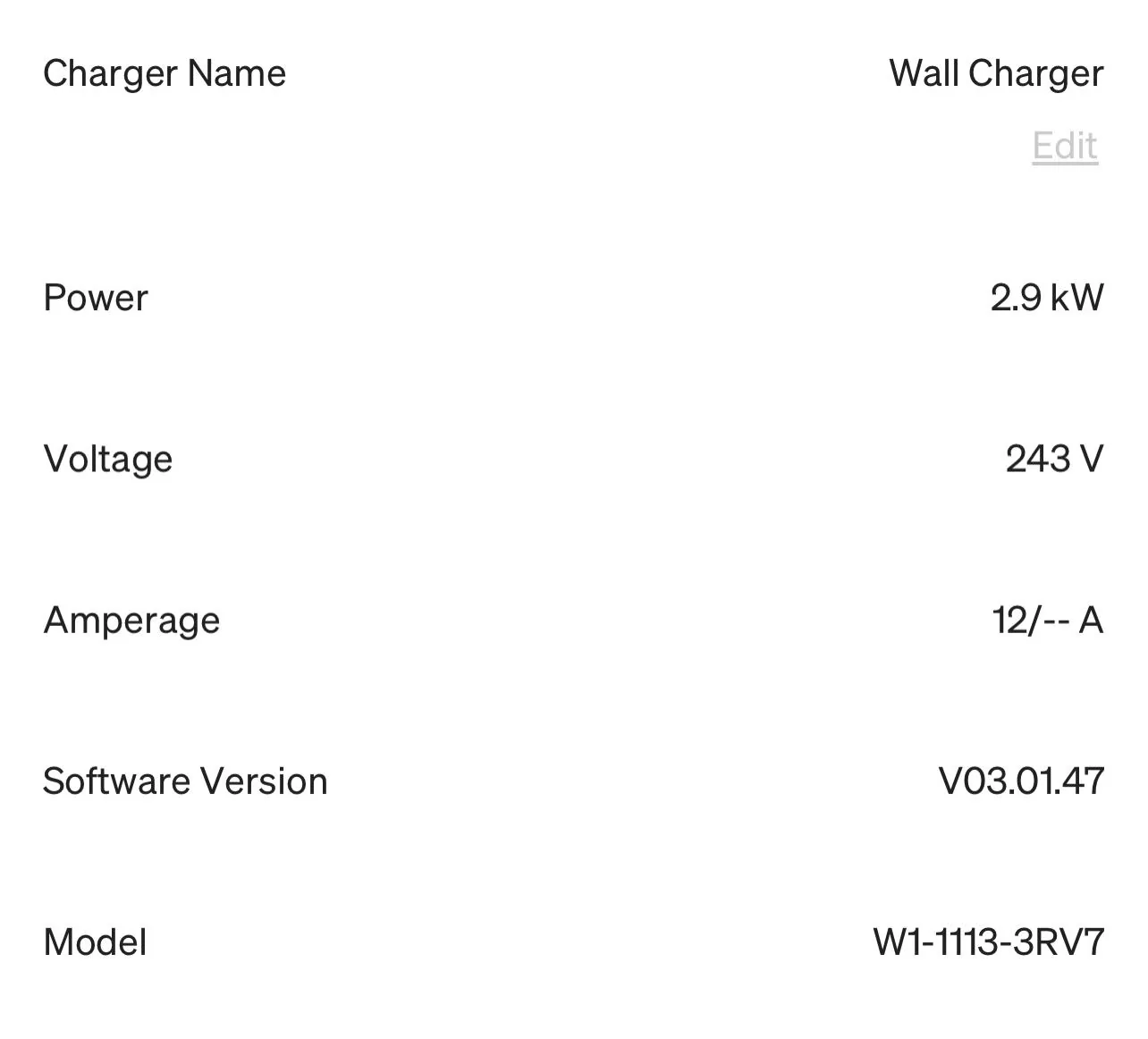

According to my app, my Rivian wall charger is only pulling 12A which I expected to pull a lot more. Showing 5mi/hr charge in truck/app. Thoughts?
Setup:
- 6AWG run ~ 15-20 ft from main breaker
- 60A breaker
- Default 48A (max) switch setting inside charger box; hardwired
- not much at all running in the house, 200A service
- R1S battery at 23% SOC (after decent driving w AC on)

You don't have it turned down inside the vehicle correct?

Call Rivian and tell them what is going on and ask them to reset it.

Check the DIP switches inside the box. That said, I just posted a similar thread a week ago. My box had been installed with a 50A breaker because that was all our electrician had on his truck. When he came back with the correct 60A breaker, we had to open a ticket with Rivian to have them update the EVSE to the correct output.
TL;DR. Check DIP switches. Open ticket.
See thread: https://www.rivianforums.com/forum/...rger-only-putting-out-40a-instead-of-48.15324

DIPs switches are in the maximum 48a setting

If the device was powered on before the DIP switch settings were changed, it retains whatever that rate was as a maximum until Rivian resets it remotely. Since it ships at 12A that's what happens.

I never moved the DIP switches but Rivian looking into it. Thanks guys!

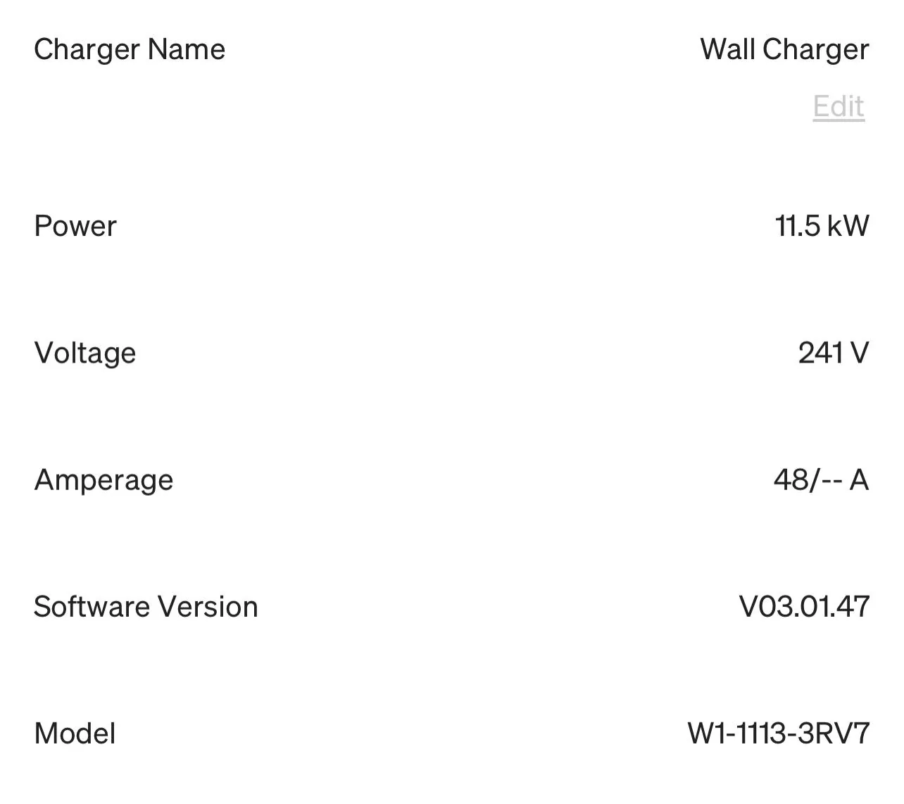

Texted my guide and they re-booted the charger and now showing 48A. I don’t understand why this has to be manual and doesn’t just checked the switches on boot up.
