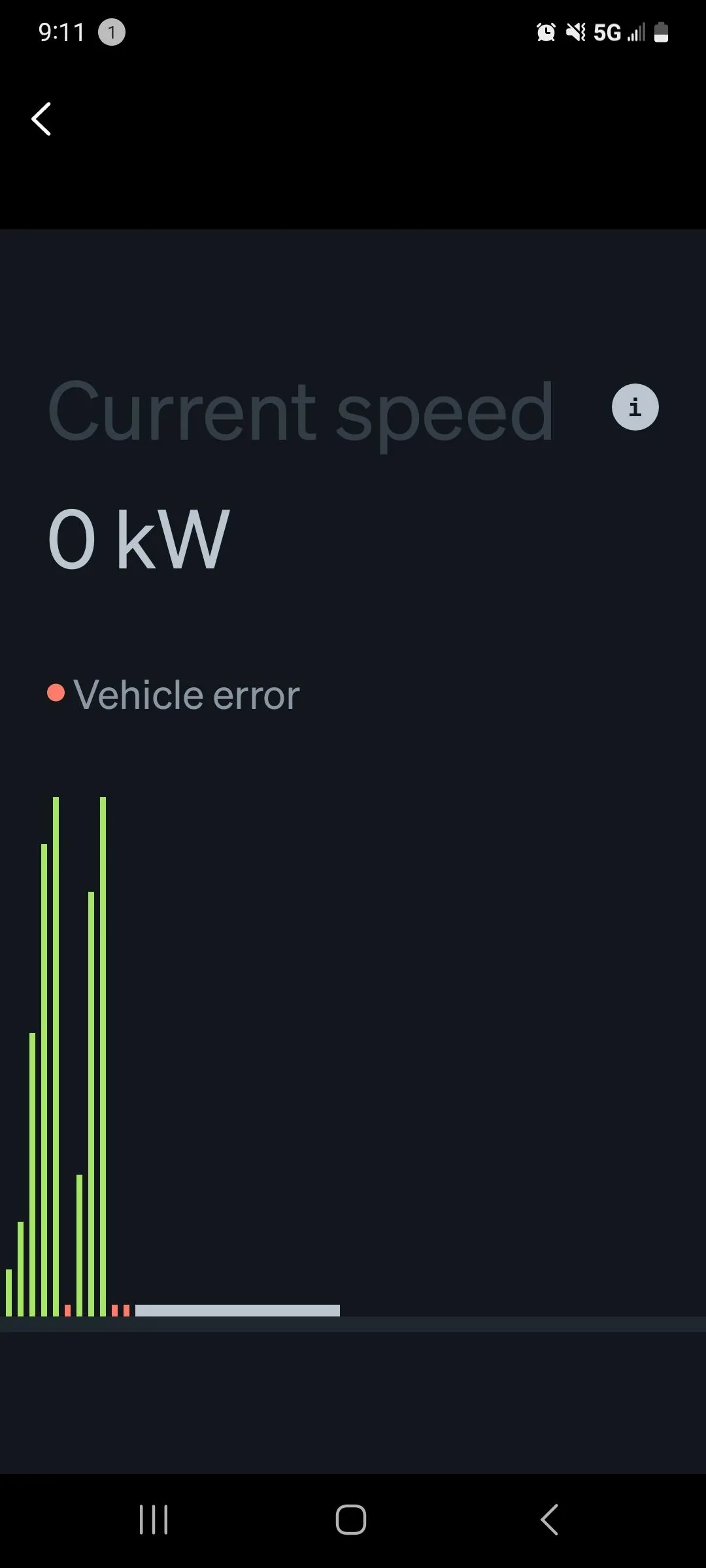

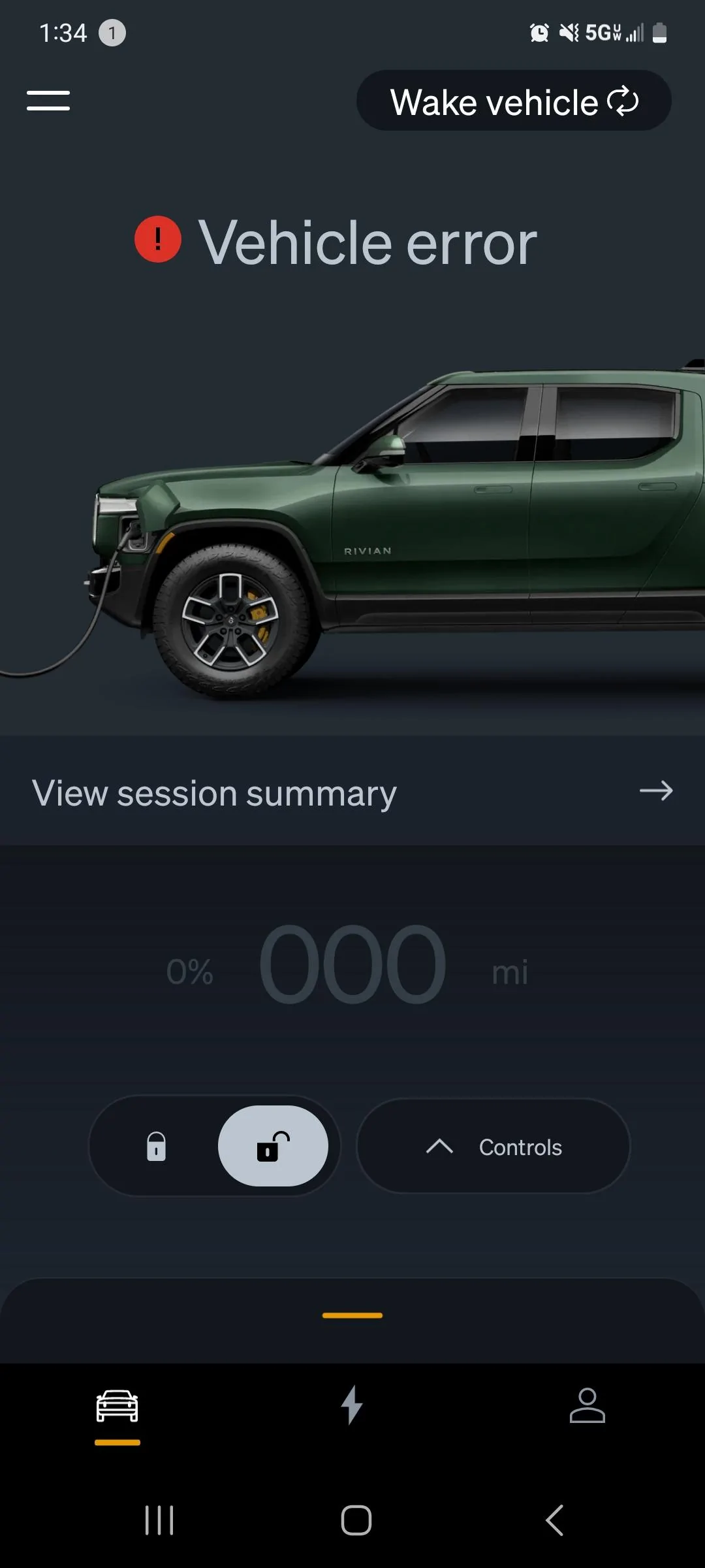

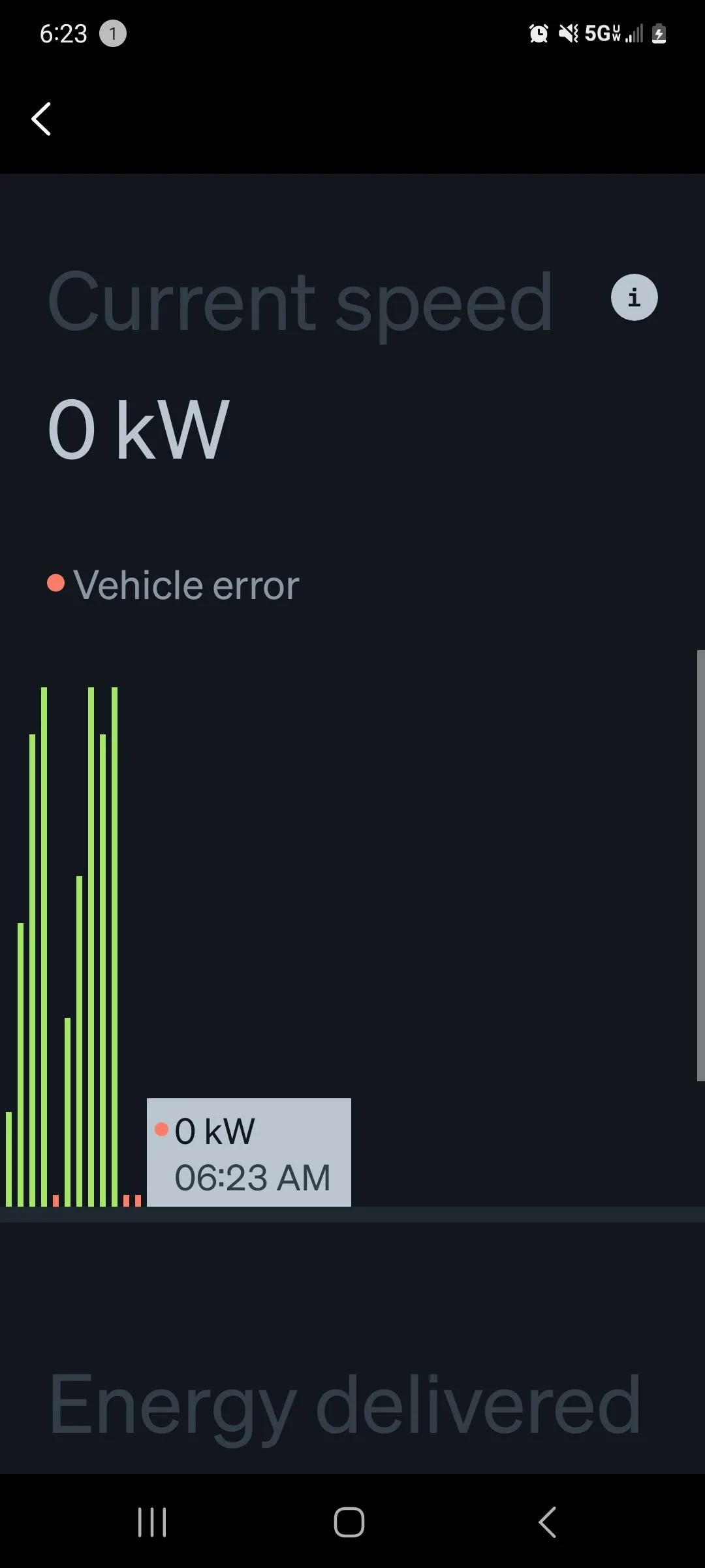

My R1T started having this problem on the 11k W Rivian home charger about 3 weeks ago, after charging reliably at 48 amps at home for the first 9 months I owned the truck. Doesn't happen on the 6.6 kW Chargepoint chargers at my work, or on any Level 3 chargers I have tried.
I opened a service ticket and their initial recommendation was to reset the truck and the charger, which made no difference. As a result of this forum, I tried reducing the amperage from 48a to 32a, and that seems to resolve the problem, but charging time is longer. I tried to bump up to 40a, but tripping cycle resumed. Current open service ticket.

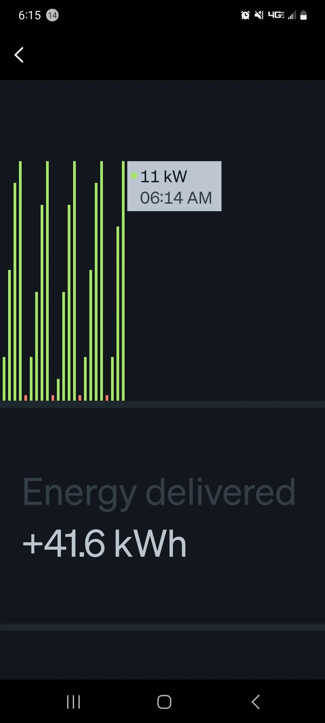

I'm having the same issue on my home charger. Alternates between charging and "charging stopped by vehicle"
i only added 18% in the last 10 hours
