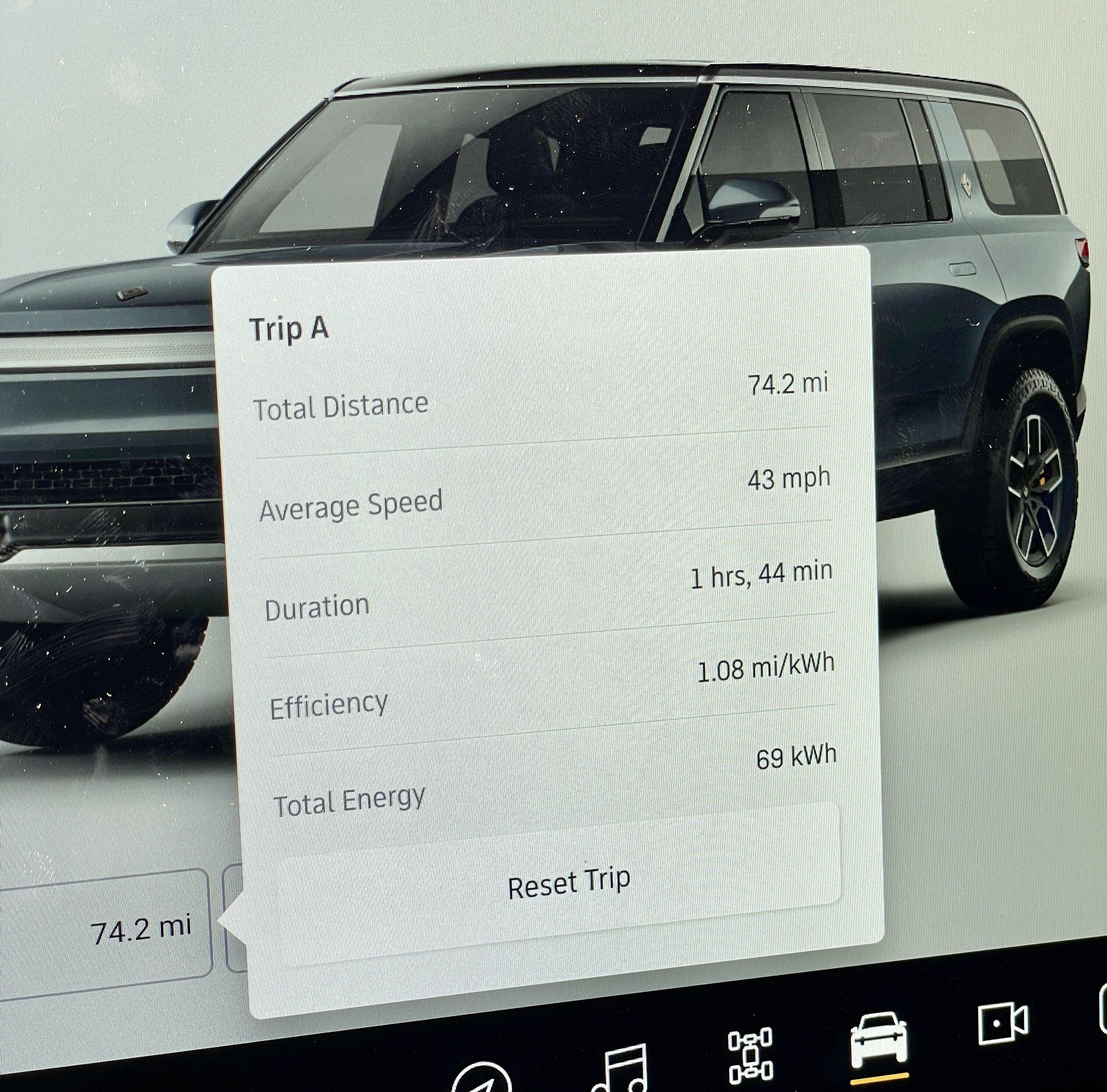

Step 3: road test at 60mph manual cruise control-loop style test up and down Hwy 101-mostly flat, with elevation changes.-74.2 miles
Results:
-R1S did well, air suspension managed the weight and seems solid
-Cameras are awesome for checking on things and maneuvering in tight spots
-Averaged 1.08mi/kWh (not surprising, but quite low)

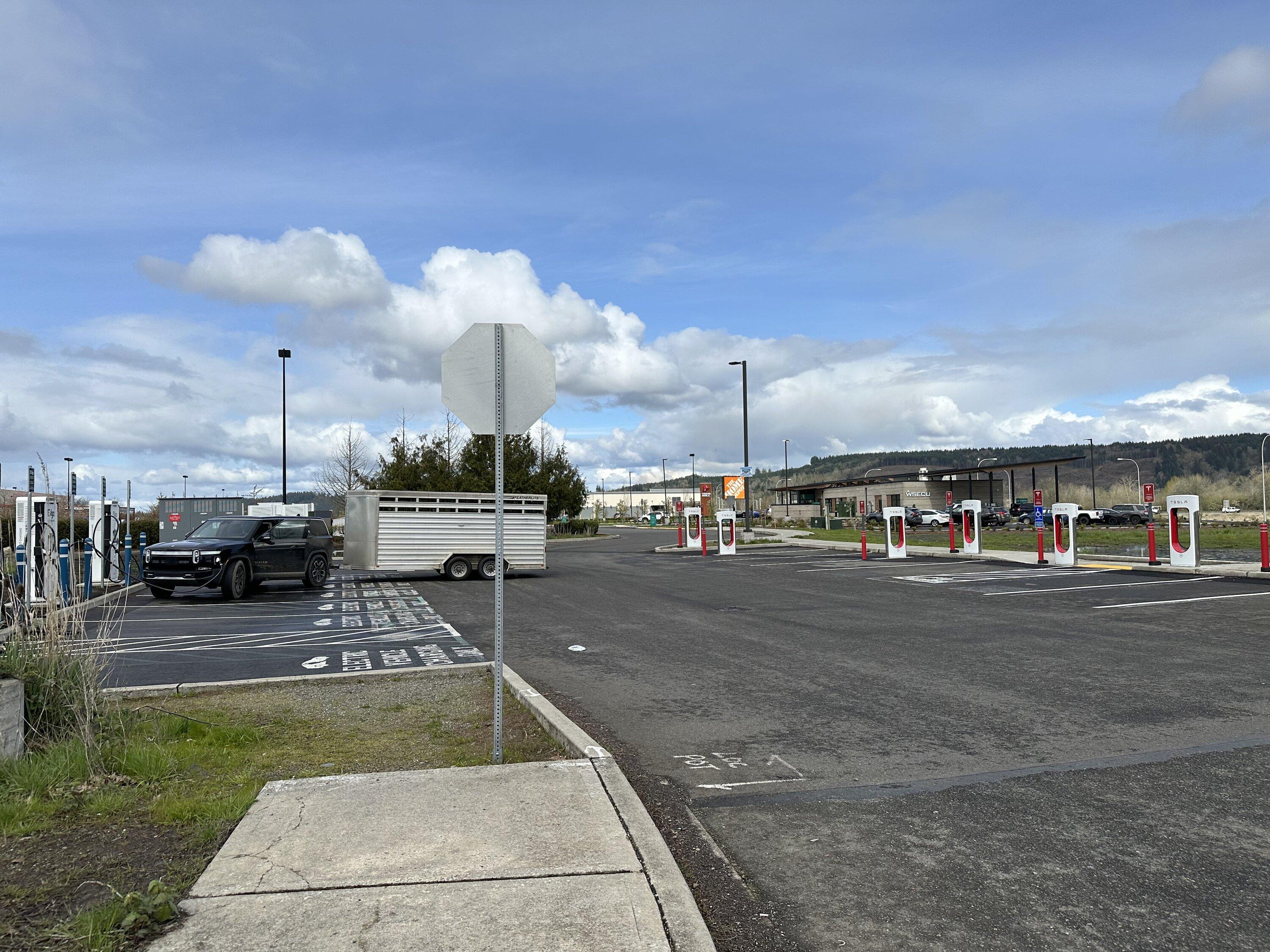

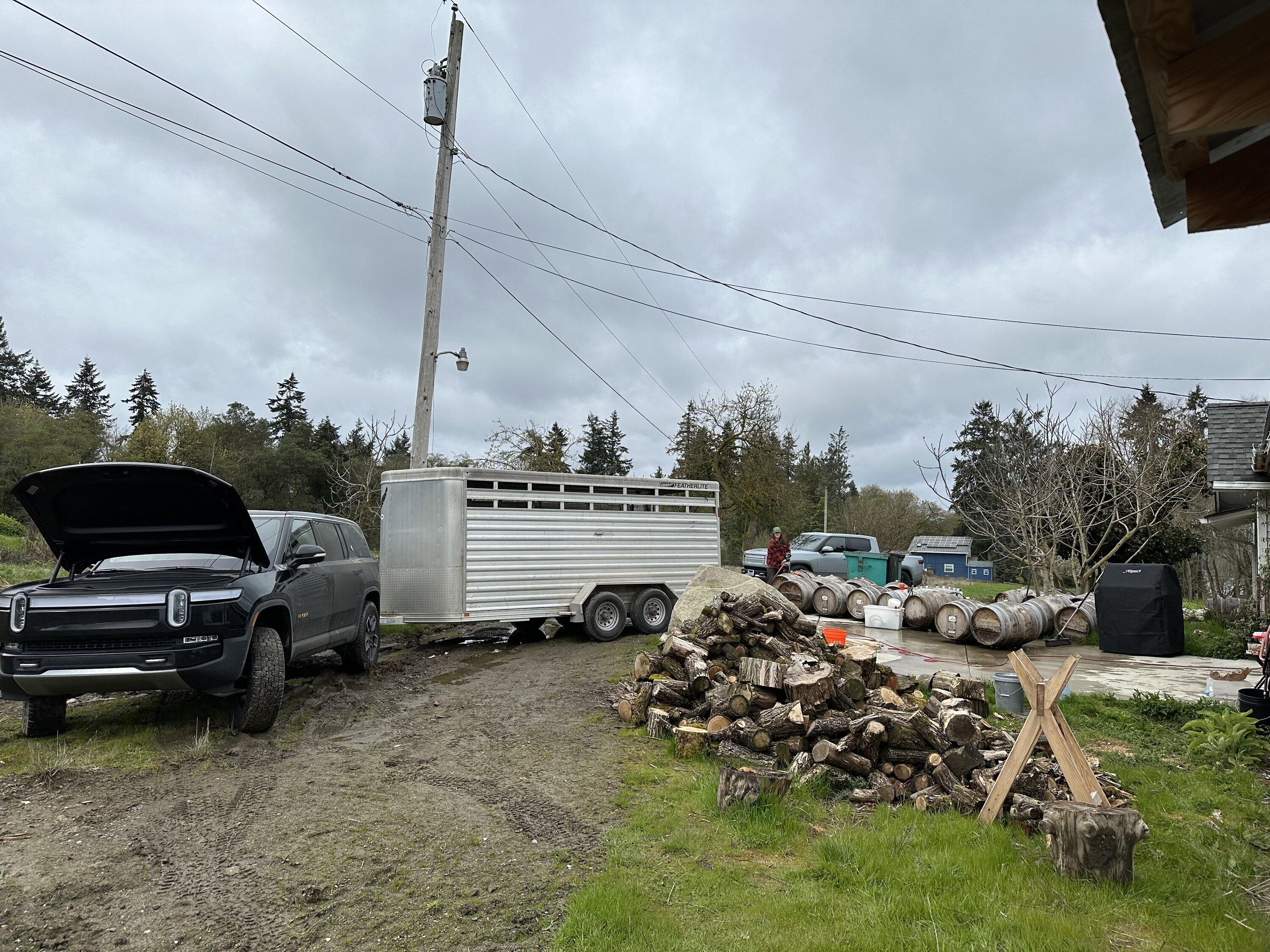

Thank you for the detailed posting. We have done a fair bit of towing now with our R1S. This week we made a couple of trips towing a 16 foot stock trailer loaded with about 8000 pounds of cargo (barrels of wine). Total loaded trailer weight was a little over 10000 pounds on the scale for both trips. I realize that is far in excess of the rating, but the Rivian handled it fine. This is basically a one time tow operation for us as we are moving our farm and winery. Normally we haul livestock, hay and feed and are towing more in the range of 5000 pounds loaded. I didn't get the trip data as I haven't even looked at that feature of the Rivian, too busy working/loading/driving. We have one final trip to complete with a similar sized load, I will try to capture better trip data. The travel was mostly on I-5 in Washington. Trip distance is 165 miles each way. We left with about 80% battery each time and charged once each way about midpoint. I don't think we could have made it the full distance without charging, but almost. Didn't want to risk it as the final 40 mile leg is far from any services or cell coverage. I will try to post more in depth trip details later. We LOVE the vehicle. Rivian rocks! Oh yeah, we also got stuck in the mud towing the trailer out into the field with a load of hay last week. I will add a post about that later. Cheers!
