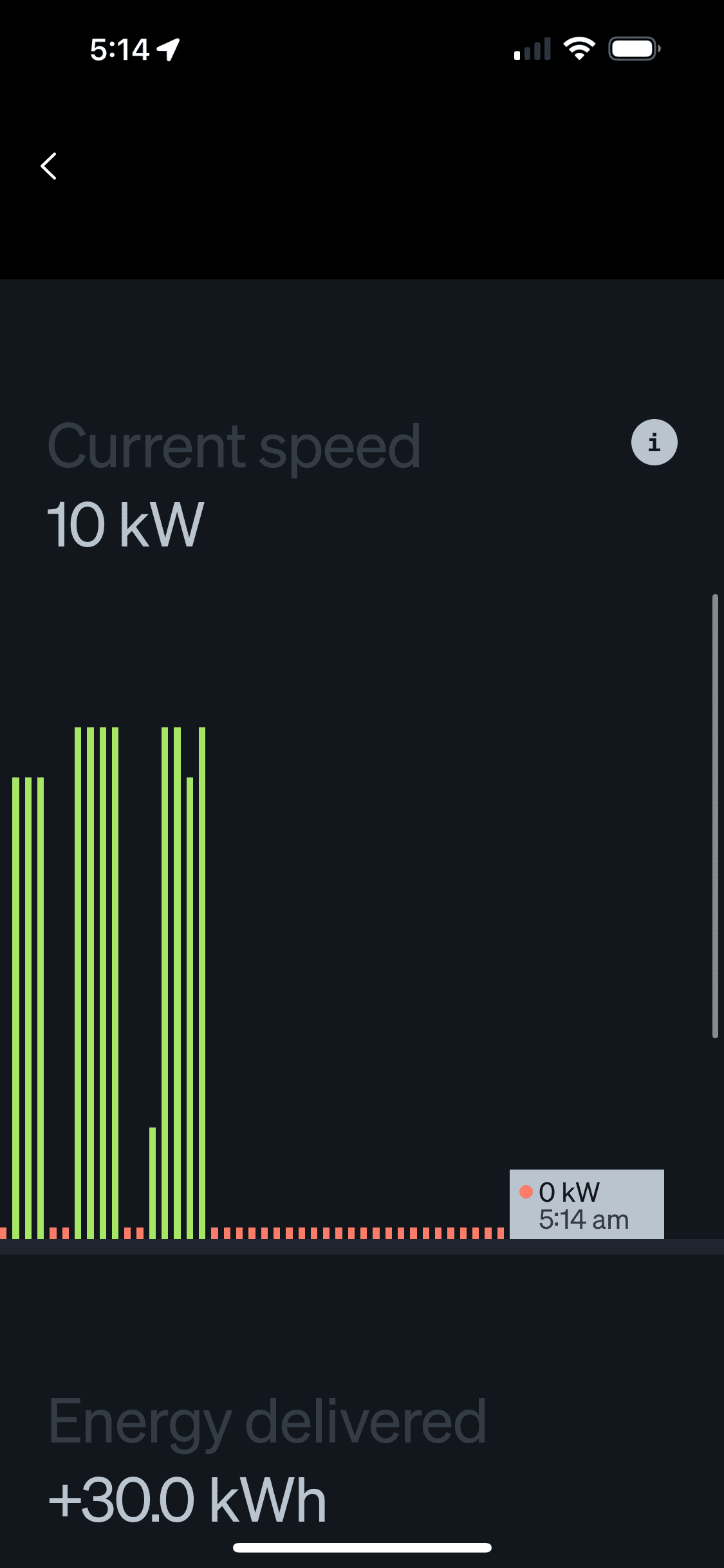

I upgraded to 2023.10.1 last night, drove the truck today, and when I returned home plugged in expecting it to charge at the scheduled time. But I noticed on the app it said "vehicle error." The Rivian wall charger (48amp) showed red, so I unplugged and replugged. Either the truck would not recognize the plug at all, or it would give an "unplug try again" error on the dash. Tried several times. Did a hard reset, and still would not recognize the plug. But 5mins later, it started charging.

This happened to me as well. I would plug in and the car would start charging normally, then a few minutes or an hour later the Riv would throw a "vehicle error." Happened throughout the night. Oddly enough, though, when I "woke" the vehicle through the app or by walking by with a key, it would start charging again. I entered a ticket with a bunch of screenshots and did a hard reset. I'm going to try a nice slow reboot of the charger before trying to charge tonight. See also this thread for similar discussion: https://www.rivianforums.com/forum/...-question-using-rivian-charger-at-home.11043/
