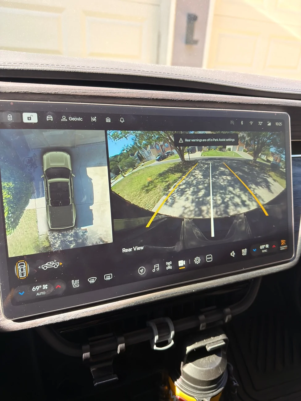

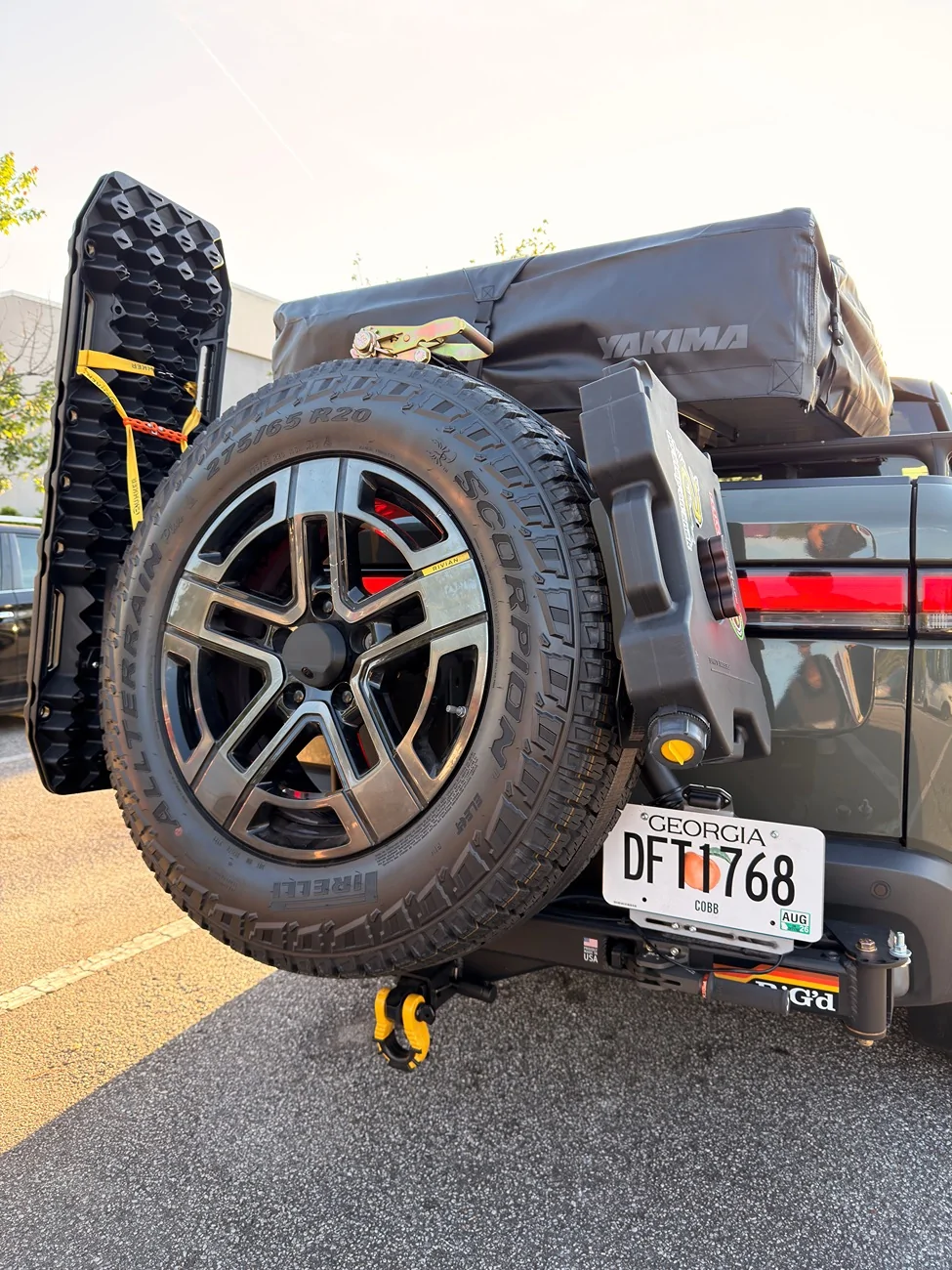

@Riviot Made an account here just to thank you for the outstanding work on this.
Long story short, I have a Rigd Ultraswing on my R1T and did not want to remove my rear bumper to relocate the camera. I bought (what was listed as a Gen 1) camera off eBay, plugged it in and it did not work. After freaking out for a week, I found your thread, matched the part number to what you had, bought another camera and installed it. IT WORKED. I figured eBay sent me a Gen 2 R1S camera.
