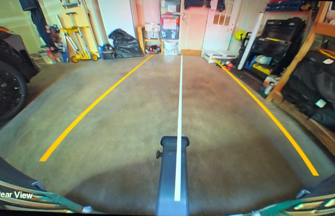

I would expect it to need drivers for new version at minimum. But if it works, even at lower res, it should be an improvement because of better sensor quality.
Just from the water logged camera to this one, it's a marked improvement. Every time I put it in reverse, I cream a little. I can see again!

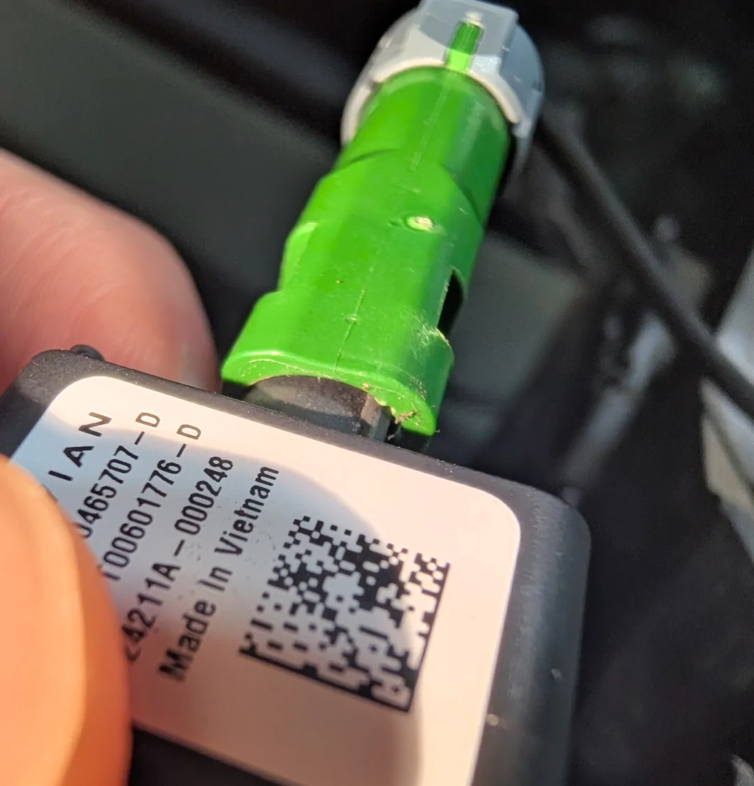

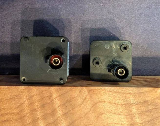

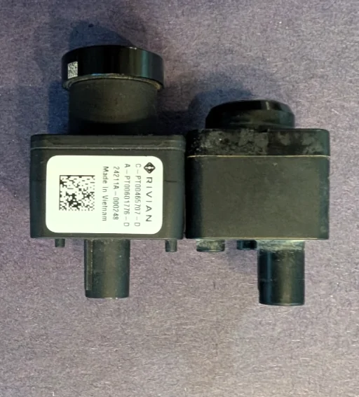

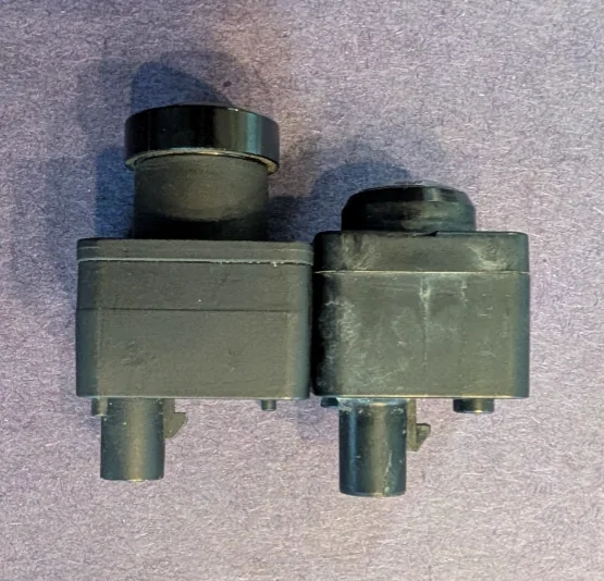

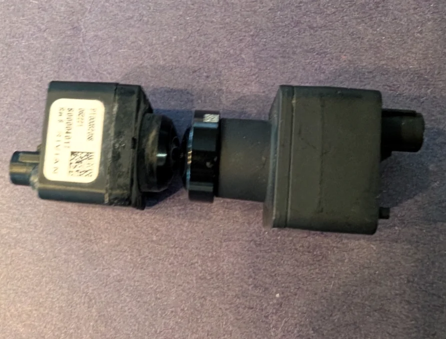

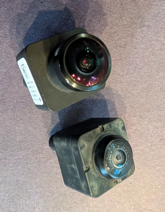

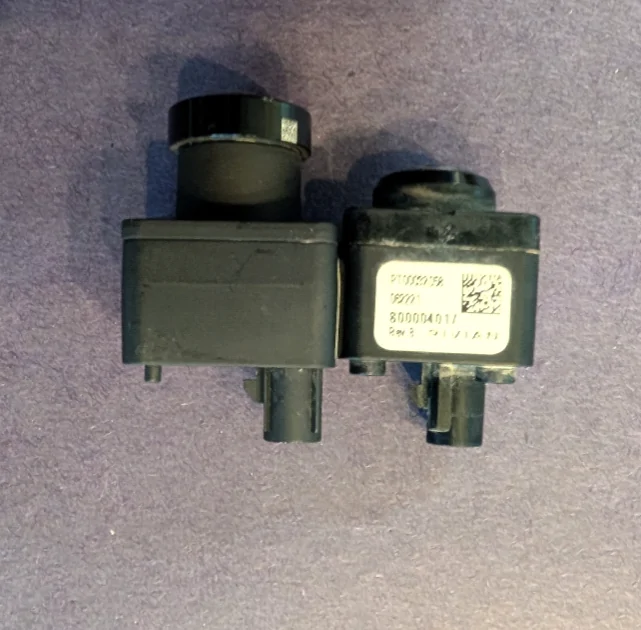

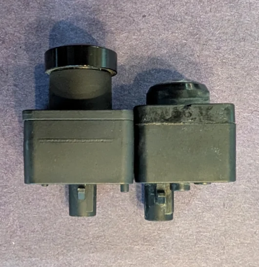

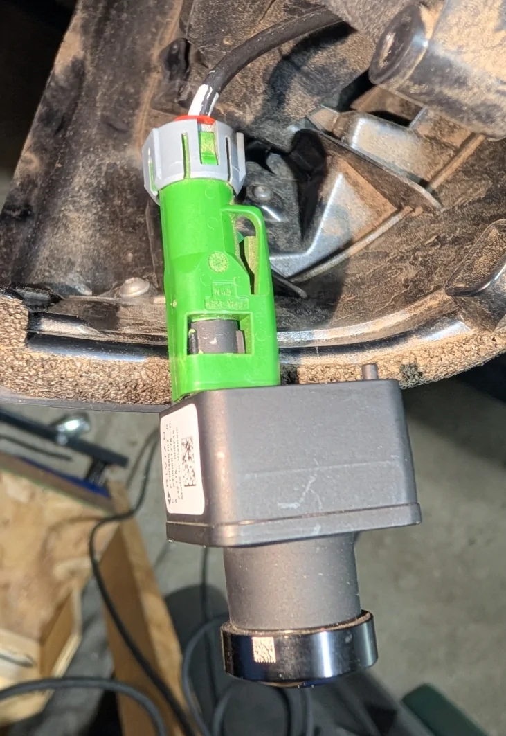

It's here! It's here!
But my dumb ass started an update as I was unpacking it, so can't pull off the sideview mirror and test yet.
These are so different, I think it would be difficult (not impossible) to retrofit a bracket. Might even need to bore out lens holes to fit.
I, for one, really appreciate you taking one for the team to reverse engineer this!

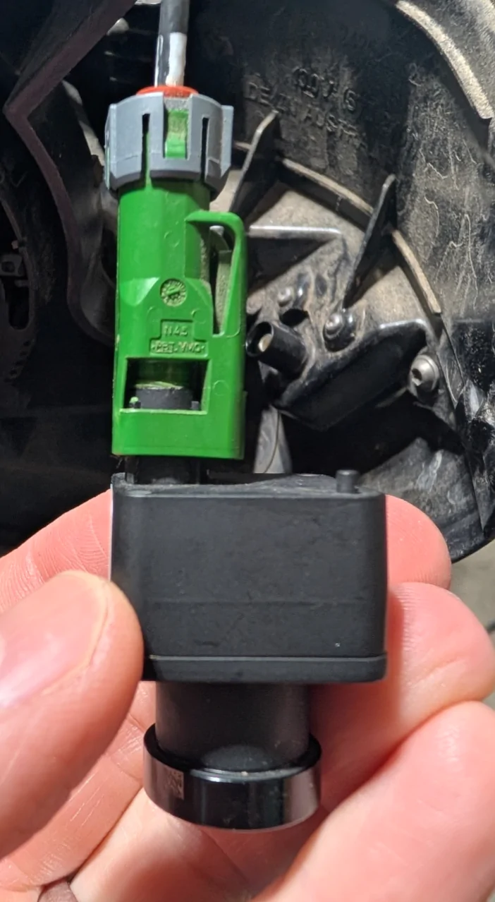

She fits! Had to really jam it in there, but finally got it to squeeze in. Now letting it sleep cycle to try and load.
Lots of resistance at first.
Rivian R1T R1S DIY Gen1 R1T rear bumper camera replacement 1000008650
You can see the little part that's different and makes it harder.
Rivian R1T R1S DIY Gen1 R1T rear bumper camera replacement 1000008651
BAM! Finally married.
Rivian R1T R1S DIY Gen1 R1T rear bumper camera replacement 1000008652
Rivian R1T R1S DIY Gen1 R1T rear bumper camera replacement 1000008653

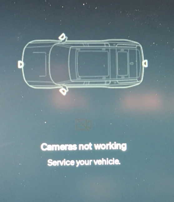

Alas... After much fiddledicking, no dice.
Rivian R1T R1S DIY Gen1 R1T rear bumper camera replacement 1000008648
There was a moment where I thought, "Oh man, is it going to work?!" But they immediately crashed. I gave them a couple cycles, nothing. Plugged in the original, sleep cycle, and it works fine again.
You can't say we didn't try! Now, who wants a practically new Gen2 camera for $100 donation to my favorite charity?

Dang. I wouldn't have minded the higher-res Gen2 camera on the back. Thx for trying!
