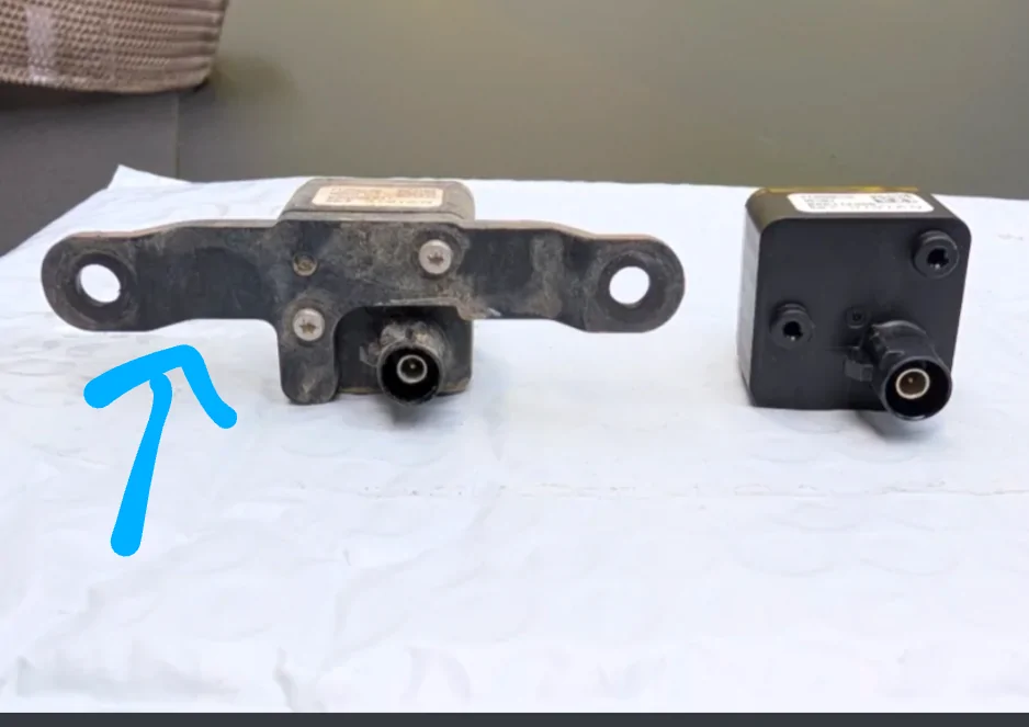

@Riviot different adapter as in the wiring adapter is different, or camera mount? Figured I would be reusing the mount from the original camera.
When you buy the actual part numbers from Rivian for each location, they come mounted to adapters for the camera to fit into the specific area (blue arrow in the pic below). The actual cameras are all the same (to the right of the mounted camera). With the right torx, you can remove them and move it over. Saved me like $200 between a "mirror" camera and a "bumper" camera. The difference was literally that adapter plastic.

Perfect. That's what I assumed. Just need to get a camera and I'll transfer that mount/adapter to the replacement camera. Thanks for the help.
Next I'll need to figure out the front bumper removal process.
