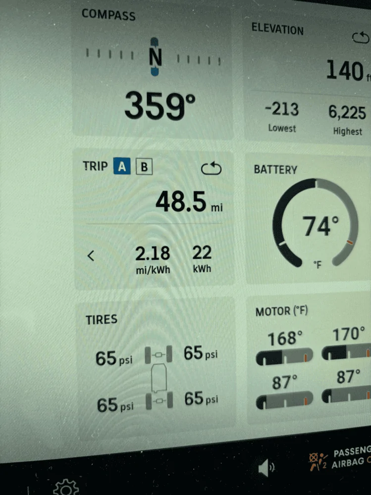

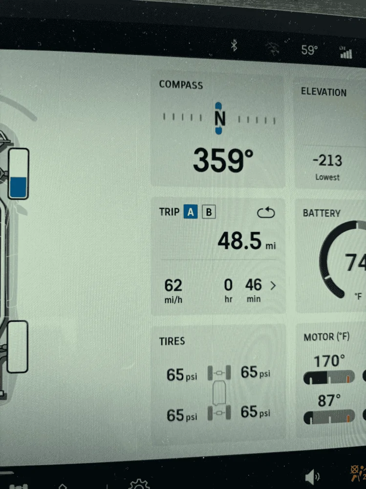

Haven’t read this entire thread as it’s gotten long and veered of course a couple times, but if anyone is looking at Cooper Discoverer ATP II tires, here’s my results @70mph in conserve mode.

Rivian R1T R1S 20" tire recommendations D1BD6702-0BA6-4F95-86DA-279711CDA298
Rivian R1T R1S 20" tire recommendations 49435216-D2F1-4C07-A395-D1E129E594B5
This was a second test at 60psi cold up from 50psi which was identical at 2.17.
The tires have an aggressive looking sidewall, but a fairly tame tread pattern and are quite on the road, but should still be somewhat tough off-road. At $305 a tire I couldn’t see buying the OEM noise makers again, and am very happy with these tires. As in my past experience the people at discount tire took good care of me and my truck. ✌
