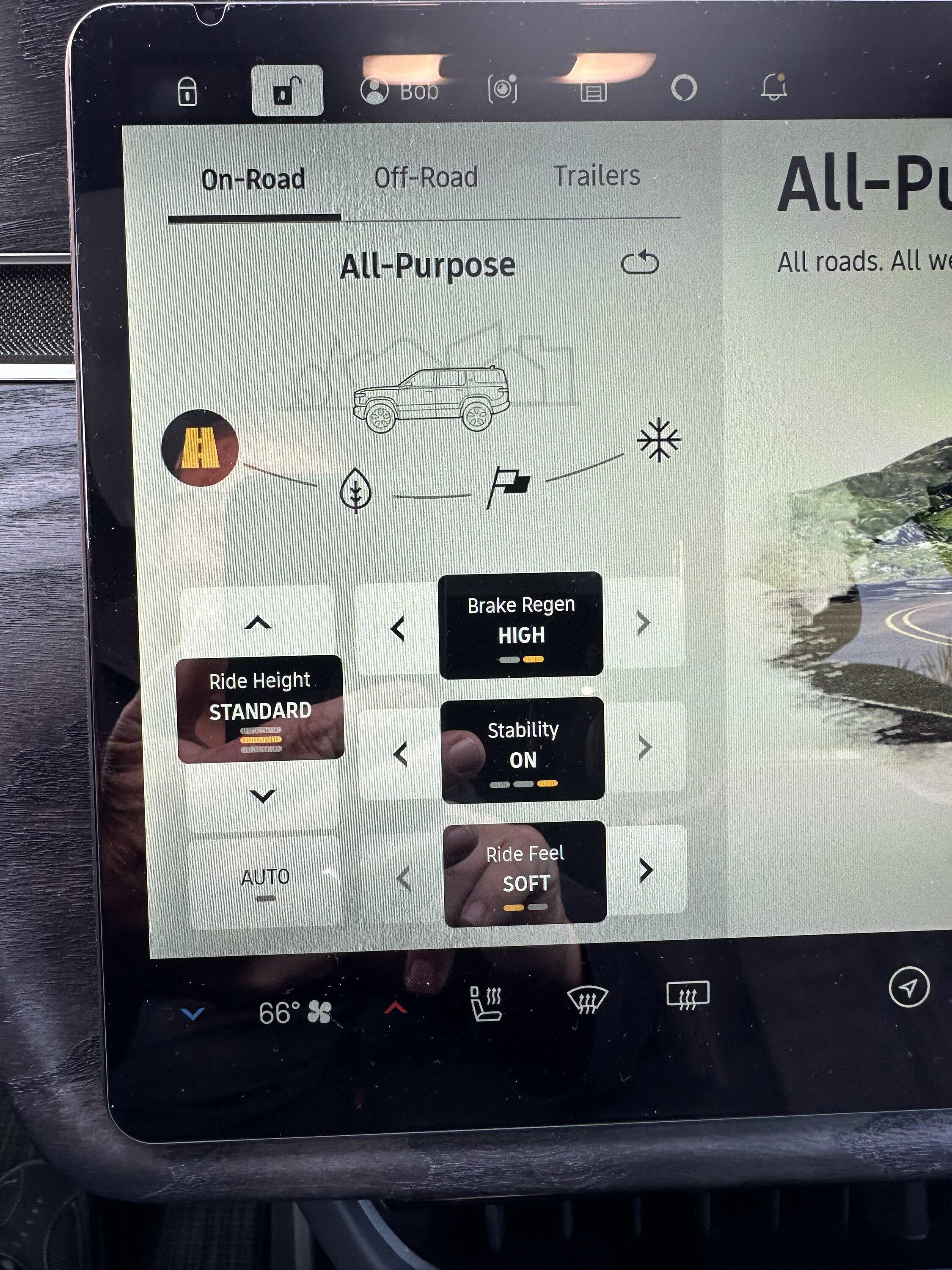

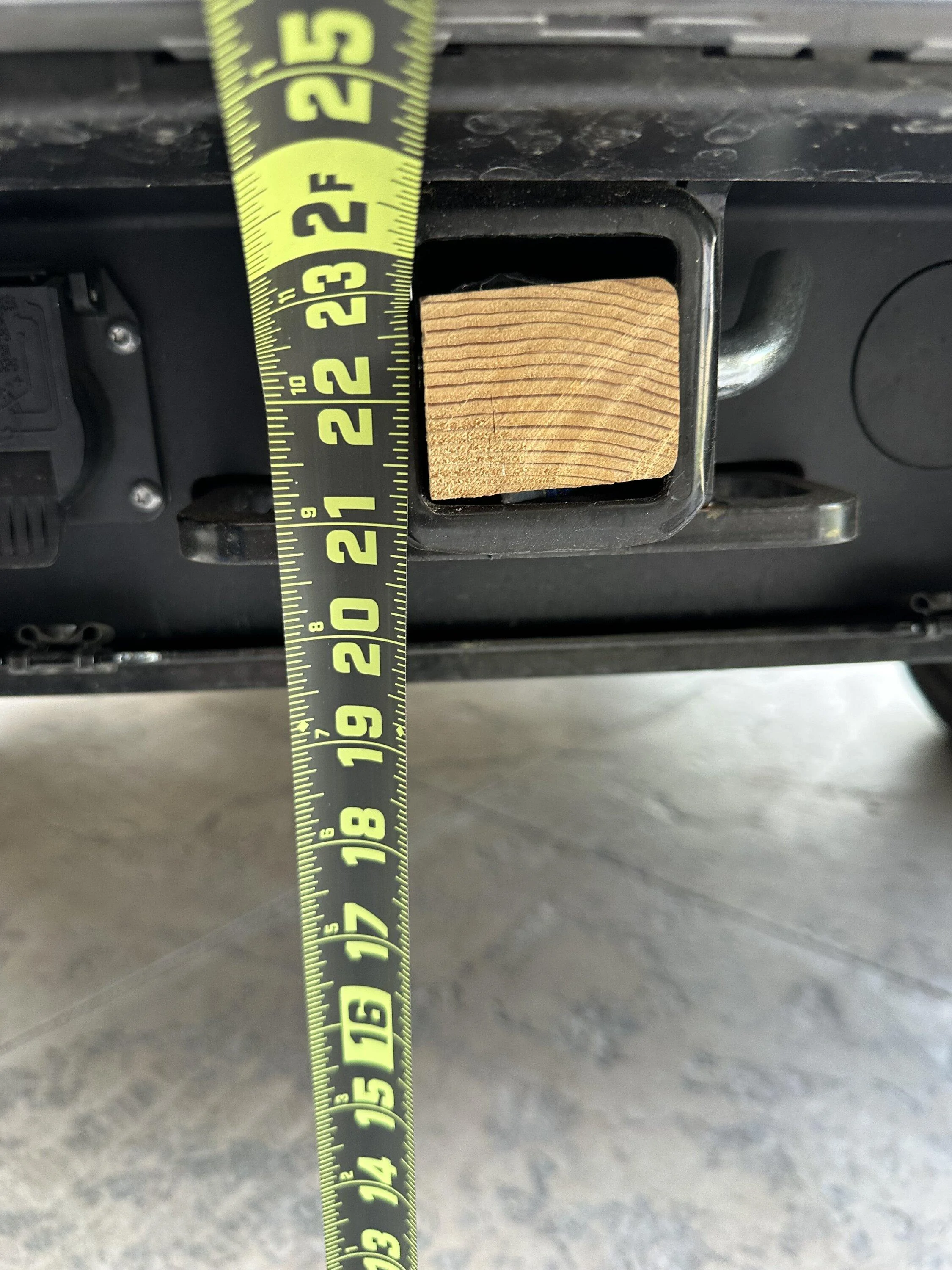

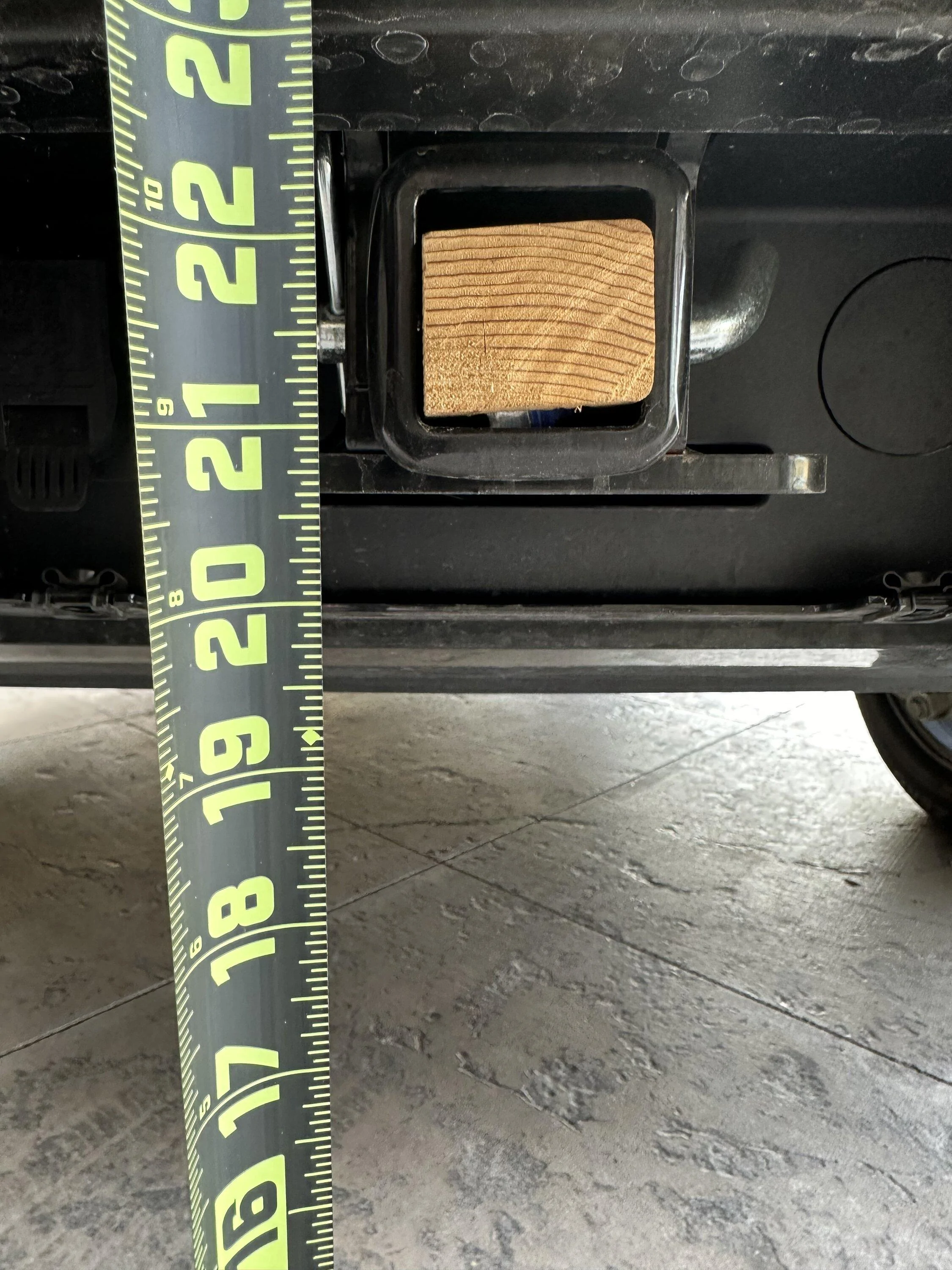

I can measure it, what ride height? I have 22s on my R1S.
7,446
12,753
7,446
12,753
What is the setting difference between the two? I see 22” and 23”?
Ignore the top picture, it is the angle taken, both pictures are 21 inches to the bottom of the receiver.
Ok thanks.. I think the calcs use the top of the receiver, but if its 21 to the bottom, its 23 to the top. Very helpful.
