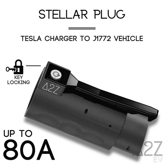

Not sure if you have a Tesla charger at home but you can use a level 2 Tesla charger at home with your Rivian if you get a Tesla to J-1772 adapter like the A2Z Stellar Tesla to J-1772 adapter. This is the same adapter you will use for Tesla destination chargers commonly found in hotels / Parking lots / Shopping centers and Airbnb. This is a much better option than using level 1 charging.
Also one more tip I would recommend is set your vehicle to lock only at home so it doesn't unlock when in close proximity and waste energy especially on level 1.

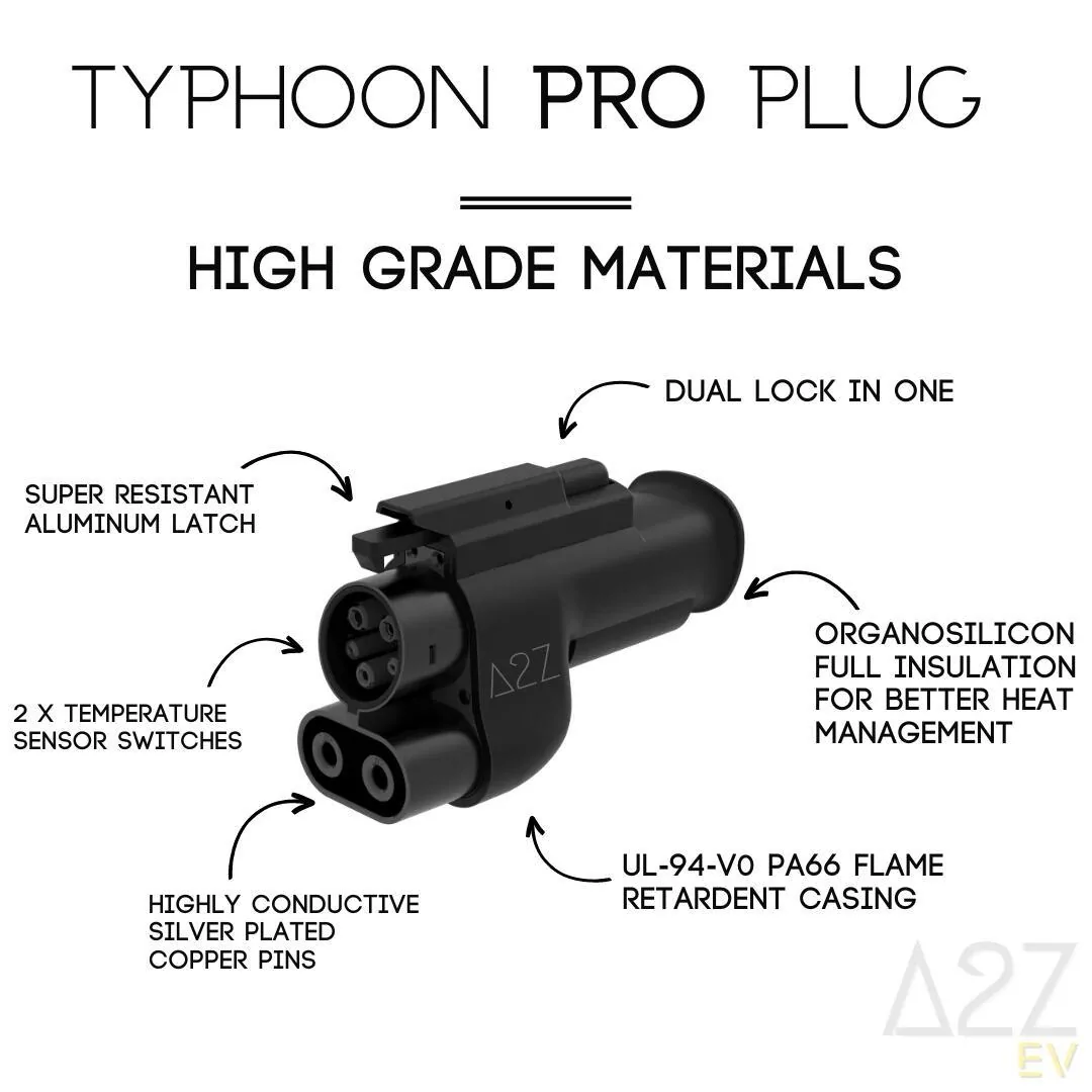

You will need the DC Level 3 Typhoon Pro adapter to charge your Rivian at eligible Tesla Superchargers.
You can bundle the A2Z Stellar AC Level 2 Tesla to J-1772 adapter for $75 additional after discount by using the drop down on the Level 3 Typhoon Pro adapter page to get both adapters.
Feel free to use the below links or forum discount code "RIV" to save on products sold on A2Z website and get free shipping.
