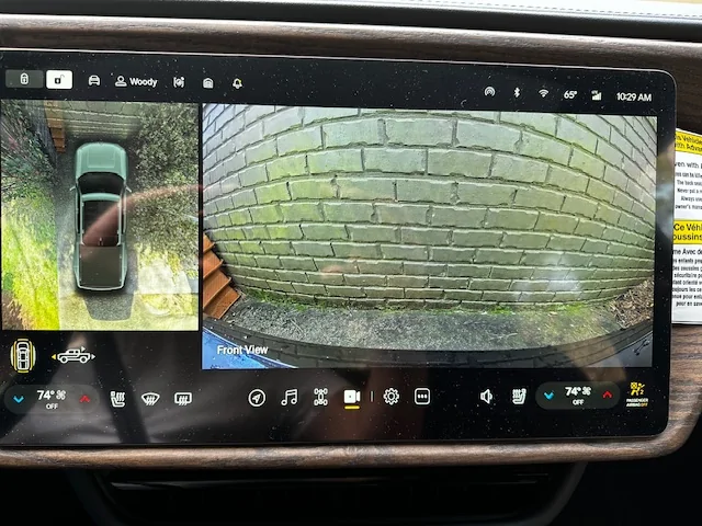

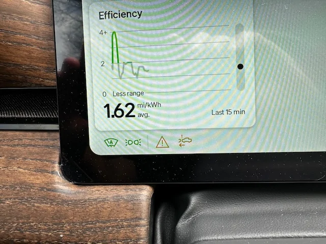

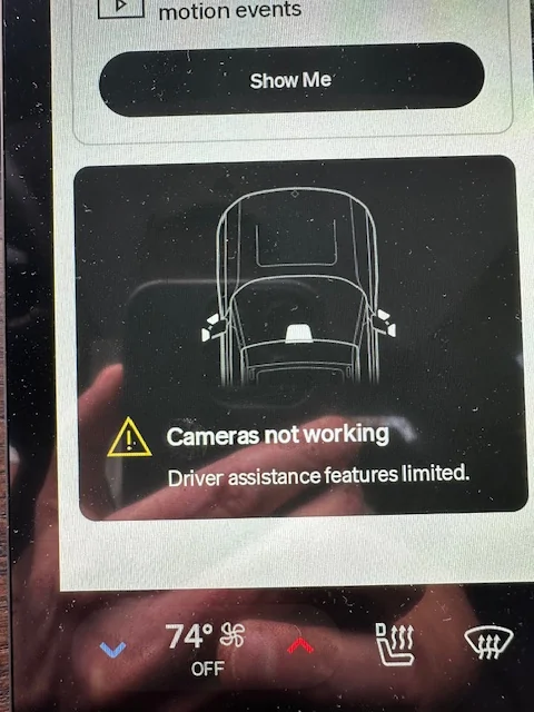

I took my R1T in for service on 3/4 for the same issue that resurfaced today. Nothing was found. Today's (3/7/26) alert said that cameras not working - Driver assistance features limited. So i took a pick of the warning icons, alert message and a picture showing that my cameras appear to be working. I know that simply walking away and coming back will usually fix the issue - but how many times do you do this before requesting a repair service. Also, strangely enough, on my delivery day we had to reboot the computer as the ADAC systems were offline - foreshadowing perhaps. Any thoughts would be greatly appreciated. New service appt 3/16. I documented the alert - noting the time and pressed my profile name to computer the alert - but it didn't seem to do anything - also pressed the hazard button for 10 sec as well. Let's see if they can find something when it goes back in for service.

FWIW, the camera view you see on the screen is from the bumper, and the ADAS camera is at the top of the windshield. They are not the same camera.

I had a similar experience with my 2025 R1S. It turned out that the radar detectors inside the rear bumper were not securely attached. I would randomly get similar warning alerts.

Being that it is so new, i bet there was a factory install issue. I had a similar experience when i picked up my 2025 R1S in August 2024. Multiple random 'camera not working issues' coupled with drivers assistance features not working, etc. Many trips to the SC to calibrate cameras, etc did not end up solving the issue. Strangely, as colder weather started to set in through fall/winter it seemed to be getting worse. They ended up tracing the wiring, continuity checks, and it was at the shop for weeks, a month this time around. They found a bent pin in a connector in the camera circuit in my drivers side mirror, apparently, as the weather got colder it was enough for the pin to lose contact even more frequently. They replaced the drivers side mirror, and it has been completely fine since. But the first 6 months of ownership were rough while they were trying to figure out what was wrong. To the point my wife was asking me when we were going to get rid of it. To Rivian's credit, they did not give up trying to solve the issue.

Curious, When driving do you see all the cars around you or do you only see the lead car in front of you?

Good Q - As i can recall - I did not notice any differences on the screen - so i will keep a look out - I just hope I get a better result than 6 mos. in the shop - which his post (and others) may just help me - as I plan on informing the service advisor the solutions that have been mentioned here. Hopefully a few more get posted so they can track down these issues one by one until they find it. I will keep you guys informed.
