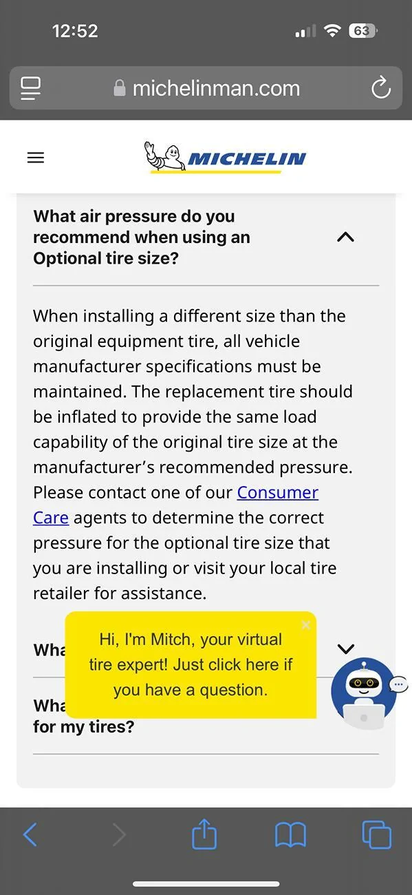

80psi is max psi for new tires. I'm looking for the correct air pressure to ensure proper tire wear.
I have the LTX MS2 on my truck in the same size, and the shop set them at 48. I upped it to 50 but need to do a chalk test to verify it's the right setting.
From an efficiency standpoint, they're great, and wear so far has been normal over 2k miles.

Anyone know what the proper air pressure would be for 275/60R20 tires on my R1T? I'm going with a slightly smaller tire than stock and wanted to know the correct tire pressure.
When I installed my Nokian One HT’s I contacted Nokian with the exact same question. They got back to me right away with a table of tire pressure vs load weight — with the caveat not to go below Rivian’s recommended pressure.
Looks like you've given up taking feedback from the forum.
As many have said, the max load case is the highest rated tire pressure. In terms of what's best, its a tradeoff.
Your ride will be better at lower pressure than high. Your rolling resistance is lower when the pressure is higher (better range).
EVs are sensitive to tire pressure more than ICE vehicles. So I have the same tires in a different size and lower load index (mine is 275/50/22 115). Michelin makes a tire in 119 load index but that tire weight much heavier and I didn't want the consequence of heavier unsprung weight that reduced the range, since I never come close to the max load.
For your case, as someone pointed out, I would start at 48psi and if you tow or have heavy load in the bed, increase the rear tire pressure at that point.
