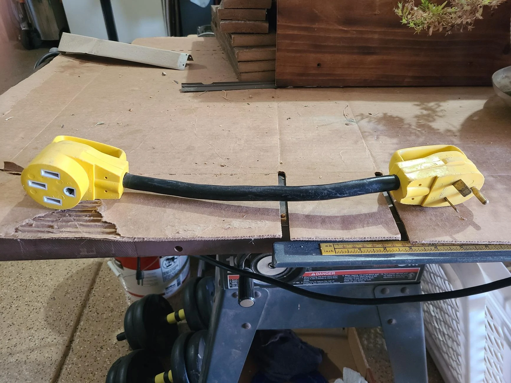

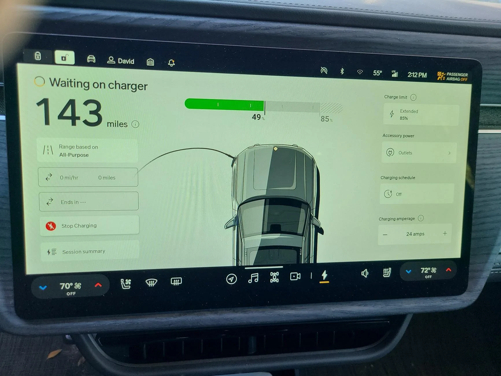

Hi again. So I tried the power adapter I used with my RV (see image) and set the amps to 24A and my R1T just sat there saying "Waiting for Charger" (see image - upper left) for about 5 mins then quit. I assume this means I don't have an "EV-specific adapter". Before I buy another, can you confirm this assumption?
That is correct - if you use it with your RV, then it's not wired the way that it need to be for use with an EV.
You’re correct as far as I understand it. The wiring for an EV specific TT-30 to 14-50 adapter is different in order for the EVSE to see voltage on both the hot pins of the plug.

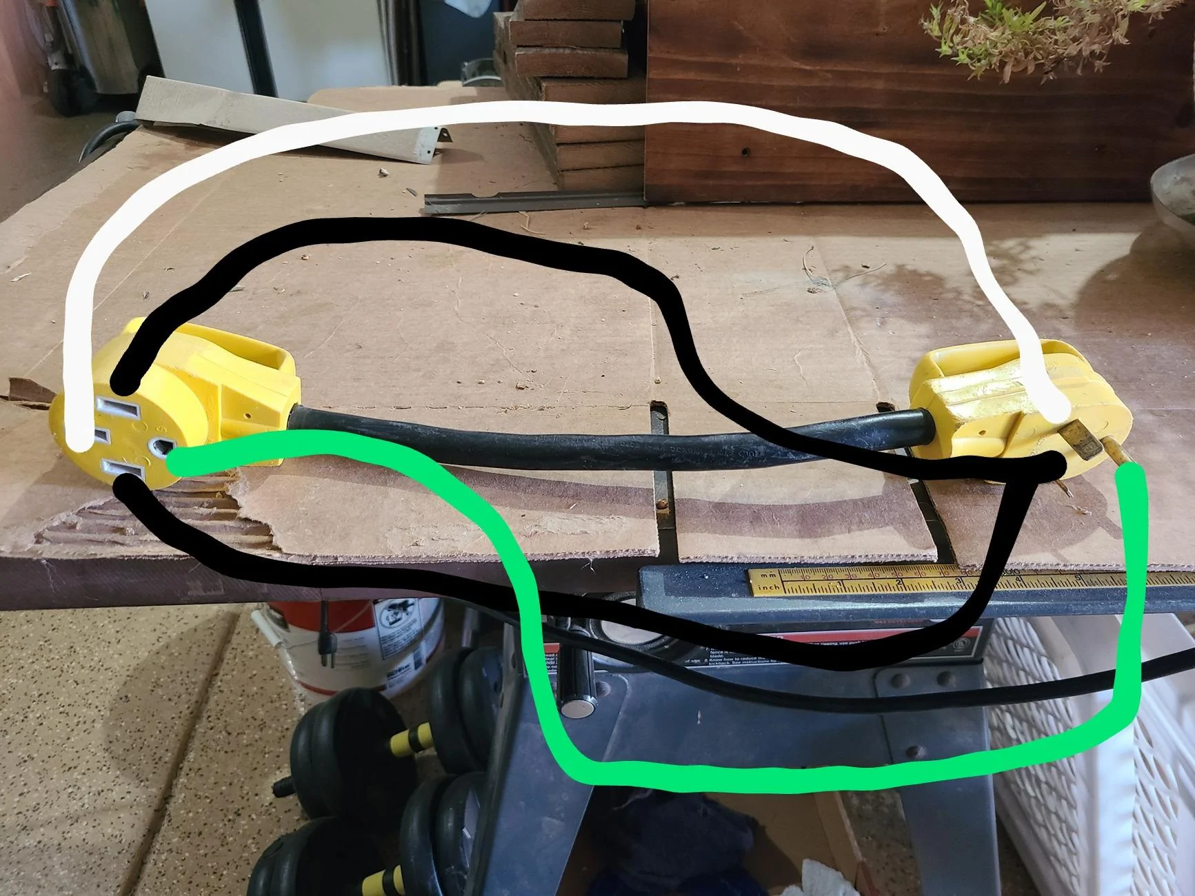

Wired for an RV:
Rivian R1T R1S 30 AMP 120 V charging 1000004503

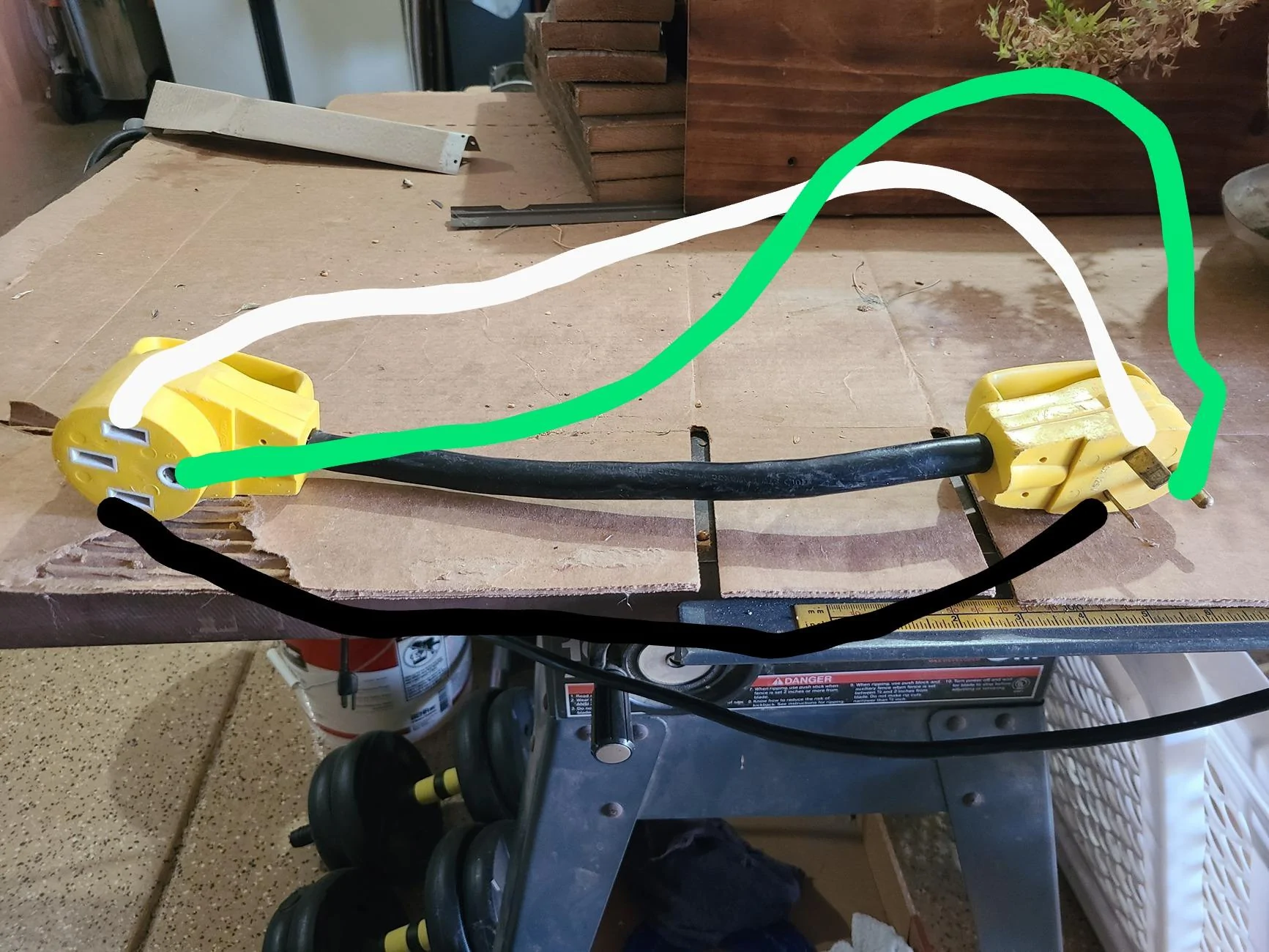

Wired for an EV:
Rivian R1T R1S 30 AMP 120 V charging 1000004502
