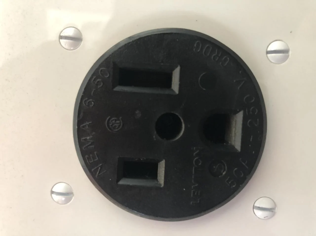

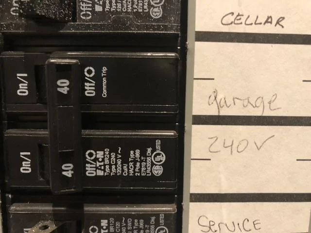

One last question: We built the house 8yrs ago and I had them put the outlet in the garage, but at the time didn't specify anything but 240v. The fuse is 40amps. I have never ever used this outlet. Do I need to have an electrician at least inspect it for anything before I go charging my pricey new SUV? Or is it all pretty standard as far as wiring size, etc. and will be just fine.

If it's got a 40A breaker (and assuming you used a licensed electrician and everything was permitted and passed inspection) then you can safely charge at up to 32A, which is the max the included Rivian Mobile EVSE can charge at, anyway.
If you're going to buy a different EVSE then you'll just need to configure it to limit charging to 32A.
If you want to see if you can swap out for a larger circuit breaker, then you would need to ensure your panel has the capacity and check the wiring size and material, first.

I wouldn’t worry about it, just plug in and charge. EVSEs and car chargers have circuitry to detect weird electrical problems and will simply not charge if it detects anything squirrelly.

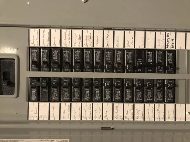

Hopefully it's a breaker panel on a new house, more a fuse box...
How far is your plug from the panel? If it's a short run, they could've gone thick. I'd suggest asking the electrician to either 1. Verify thickness, if short enough run and thick though gauge, you could replace the plug or hard wire in at a higher amp. Or 2. Just do a new (shorter) run from the panel with 60amp breaker and hardwire.
I highly suggest ChargePoint Home Flex, I love mine. 60 amp breaker, hardwired, 6 foot run from the panel. But I have propane water heater, oven/range, and furnace, so plenty of room on my 200amp panel.

Just for additional info here’s some pics:
Rivian R1T R1S 40amp 6-50 outlet charging 26E892C4-E62C-4906-8738-2AAFC982F75C
Rivian R1T R1S 40amp 6-50 outlet charging 8F5600EE-FF46-4442-909A-B8BD5D6A30F0
Rivian R1T R1S 40amp 6-50 outlet charging 6AF0B615-70DB-4B3F-BE6B-40BDC61F249E
