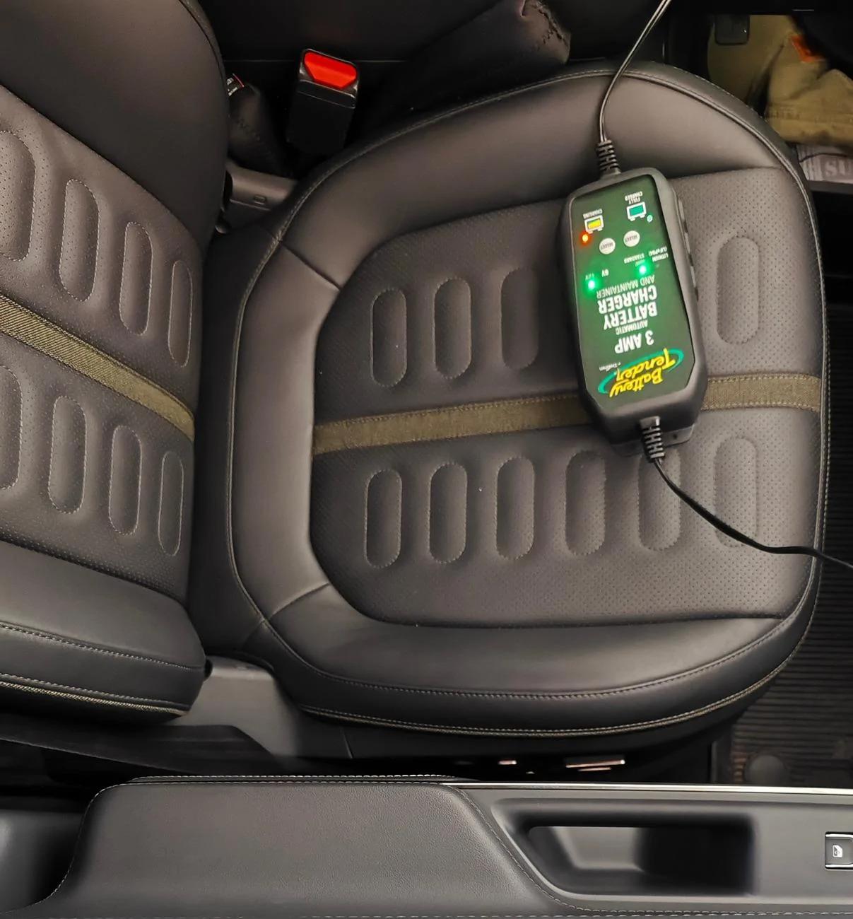

3-amp Tender:
Rivian R1T R1S Vampire Drain Fix: How to solve in under a minute (indoor or outdoor) IMG_20250323_141917~2

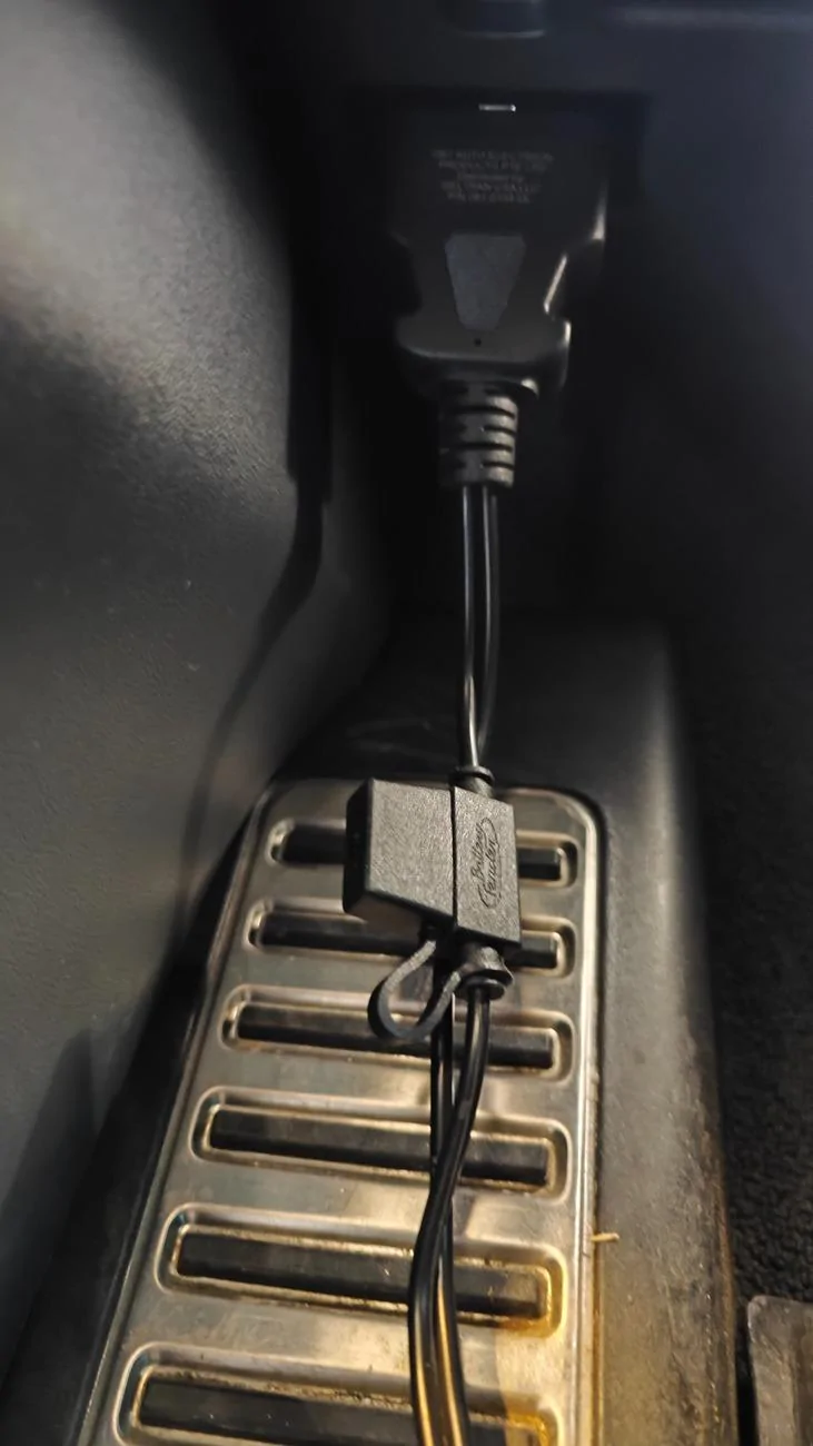

OBD connector (this fits into the driver under-seat storage bin for quick access BTW):
Rivian R1T R1S Vampire Drain Fix: How to solve in under a minute (indoor or outdoor) IMG_20250322_143929

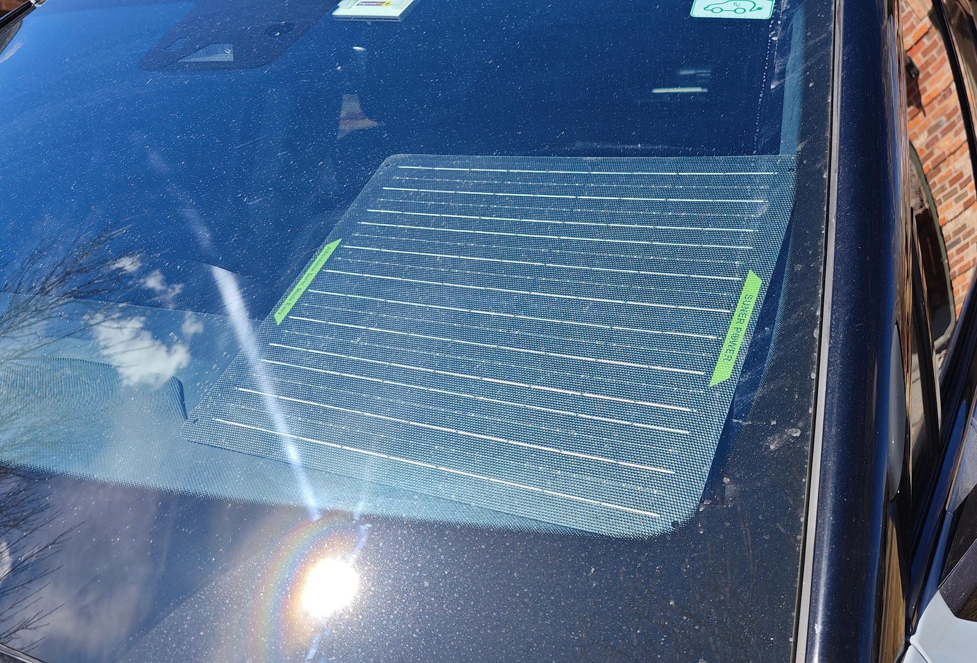

30-watt solar panel that rests on the dash and tucks in neatly behind A pillar, with no additional mounting needed:
Rivian R1T R1S Vampire Drain Fix: How to solve in under a minute (indoor or outdoor) IMG_20250322_123615~2

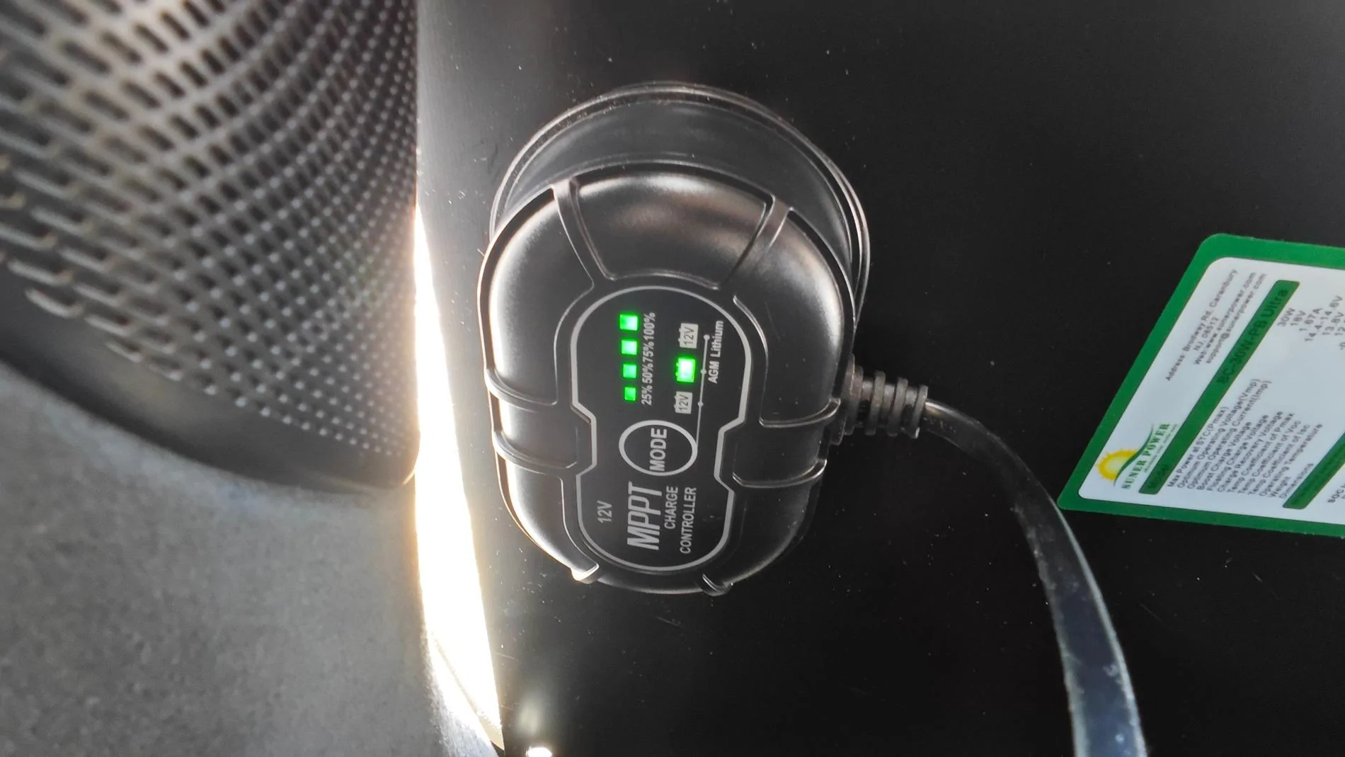

MPPT unit behind the solar panel, which shows how much charge the 12V has, and blinks when charging:
Rivian R1T R1S Vampire Drain Fix: How to solve in under a minute (indoor or outdoor) IMG_20250322_123335
