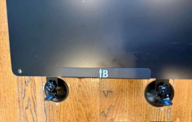

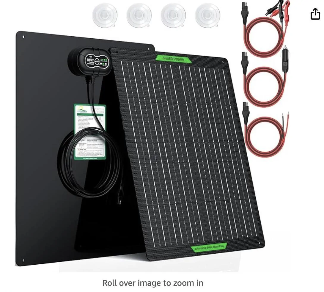

First, I want to thank all those whose research and testing have led us to at least a Rube Goldberg approach to mitigating the vampire drain loss of our trucks. I went with a 30w solar cell as I may not have good light all the time, and a 20w might not be adequate. I planned to mount it on the roof to get the maximum exposure to the sun and the slightly larger size wouldn't be an issue. I also realize that the tinted roof may limit the energy output but all my windows are tinted and my windshield is typically pointing away from the sun so the roof was my best option. I haven't done any extensive testing yet so this is more of a POC type thing at this point.

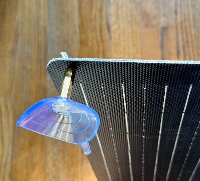

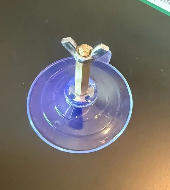

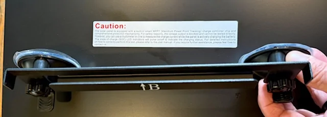

The cell I ordered came with suction cup mounts but I didn't think they'd be adequate for my semi-permanent installation. So I looked for options. I ran across this Starlink mini mount. I thought with minimal modification it would work and it seemed pretty robust. They are much easier to take down than the included suction cups. I've posted pictures below of the mount and the suction cups that came with the scell.

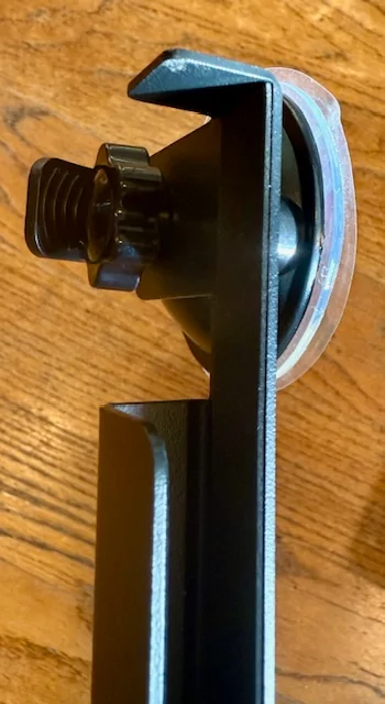

Once I got the mount, I realized I could basically get by with doing nothing but slightly bending the cell to slide it in. That is my temporary solution, and I found some foam core board that I will cut ti fit in there and slightly bend or file down the outer tabs, and I'll be done.

I bought this solar cell battery maintainer.
https://www.amazon.com/dp/B0DHD3GRSF?ref=ppx_yo2ov_dt_b_fed_asin_title&th=1
Rivian R1T R1S Vampire Drain solar cell mounting option 1743430678953-sl
Then I paired it with this Starlink mounting bracket to mount it on the inside of the roof.
https://www.amazon.com/dp/B0DSVTPQ34?ref=ppx_yo2ov_dt_b_fed_asin_title
Rivian R1T R1S Vampire Drain solar cell mounting option 1743430800438-r
Here is the mount on the cell.
Rivian R1T R1S Vampire Drain solar cell mounting option 1743431776791-y

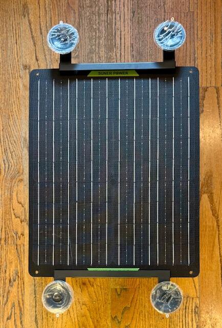

A few photos of different angles.
Rivian R1T R1S Vampire Drain solar cell mounting option 1743431818282-i9
Rivian R1T R1S Vampire Drain solar cell mounting option 1743431843683-b2
Rivian R1T R1S Vampire Drain solar cell mounting option 1743431862271-bz
Rivian R1T R1S Vampire Drain solar cell mounting option 1743431877018-k8
Suction cup that came with cell, separately and mounted.
Rivian R1T R1S Vampire Drain solar cell mounting option 1743431933142-kg
Rivian R1T R1S Vampire Drain solar cell mounting option 1743431946403-c

Be weary of the suction cups if you plan to leave your truck over several days. Pollen, Dust, and Dirt will affect their ability to stick to the vehicle. I'd also be concerned about wind if one or two of those suction cups come loose
Even if inside my experience with suction cups is pretty bad.
I'd either tape to the glass, prop the panel up somewhere, or if you want to build something build an x with plastic poles or something and have them slot into the spot where the headliner and glass meat. The sun shades have little flat clips that slot into this space. So just need to get a very flag piece of material on the ends like that to hold this x frame up.
(Edit actually two rails might be better than an x)

I currently have it mounted under the pano roof. I cleaned the glass thoroughly with glass cleaner. I'll see how it holds up. I like that it is out of the way and I don't have to move it all the time.

Good luck - did you moisten the cups at all before sticking? (yes I know how that sounds).
I have the same setup but just putting the panel on the dash for now. It's been working, but would like a semi-permanent setup and the glass over my head would be fine with me. I have a similar setup in an ICE car I don't drive much, but haven't had good luck with the suction cups once the car interior heats up.
Yes, I always lick it before I stick it. :cool:
I'll find out about heat over the next few days. It was already in the 80's here and cabin temps were in the 90's according to the app.
