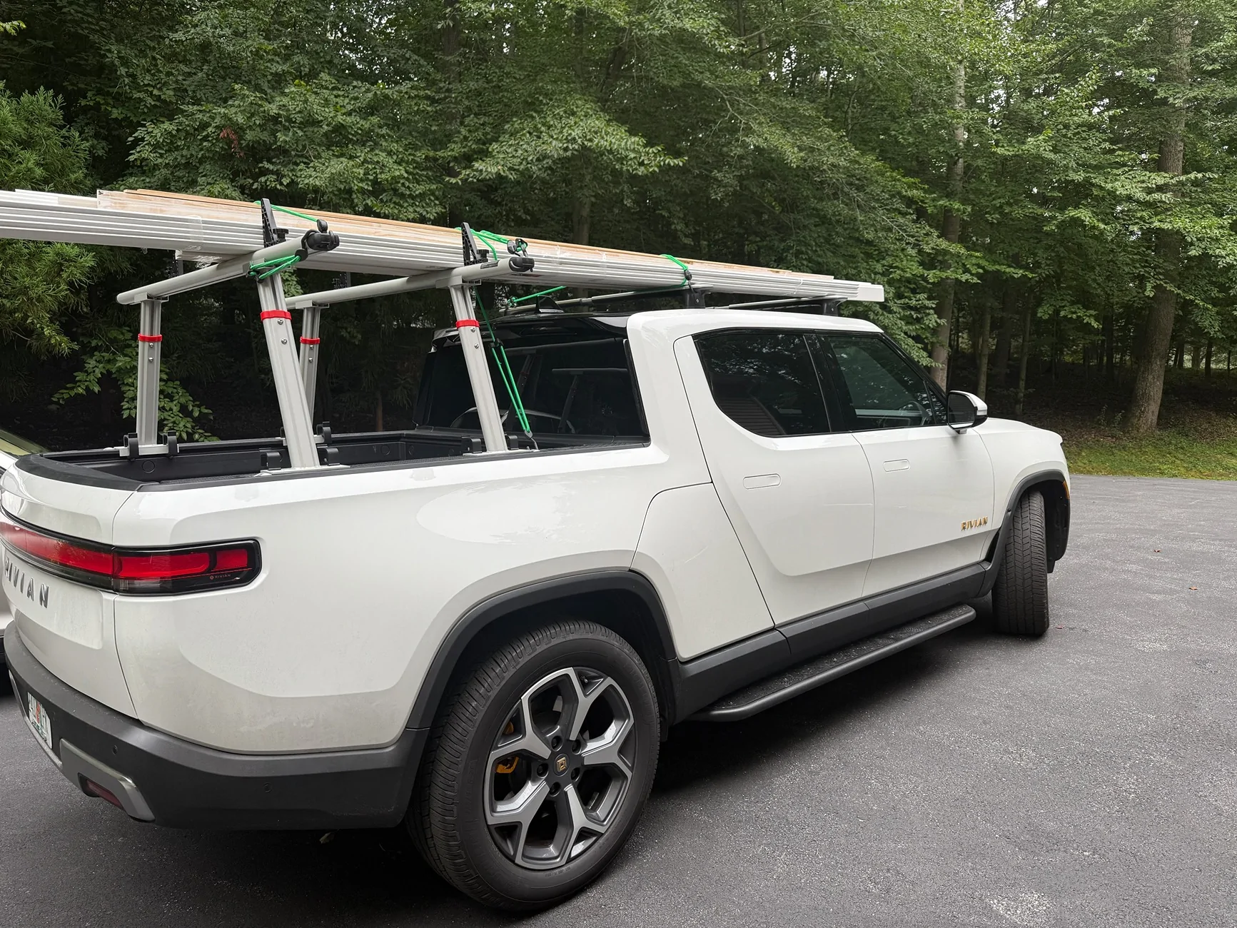

For those of you that use their R1T as a truck and are looking for a cheap rack, here is an option that fits. Not tremendous quality, not the simplest instructions, some tweaks needed to make it fit BUT it will do the job to carry long pieces of lumber and requires no permanent modifications to your truck. I wouldn't trust it with the rated 500-800 pounds but it is sturdy once installed. The key part is to install the C brackets upside down. You will not be able to use your retractable cover and/or use the channels for the cover however, the rack is easily removable once setup and easy to re-install.

Can't beat it for $200!
Bought at Home Depot: Skyhalo Truck Rack 800 lbs capacity 19-34" adjustable height. (I think is made by Vevor)
Internet # 331830930
Model # PKHJLXJB71INCO9JWV0-0718

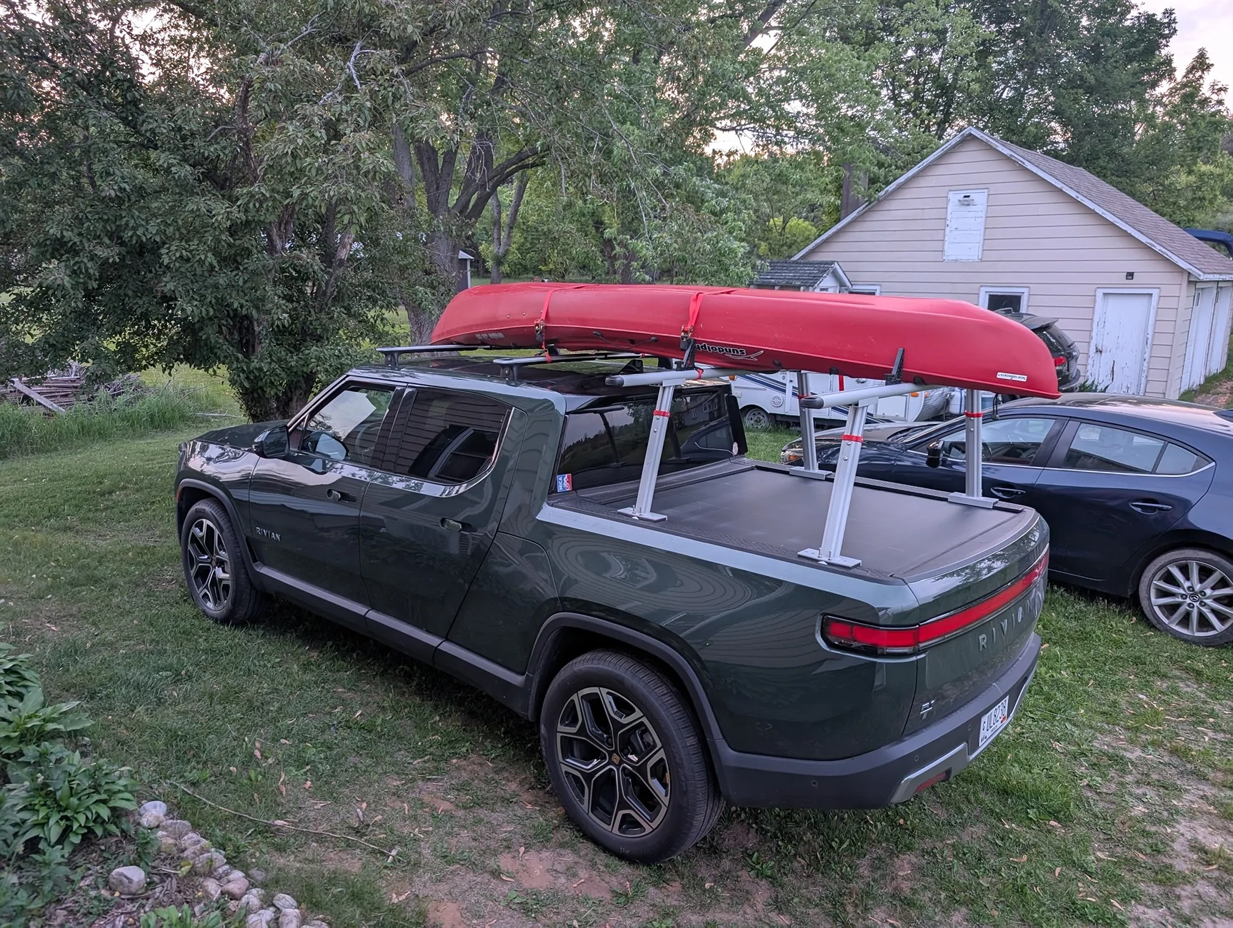

Can't beat $200 and it seems pretty decent quality! I ended up grabbing a Built Right rack from someone on the forums here, no way I'd pay the retail $1500 for it, but it's sure nice to have.

Here's the rack loaded in one of many trips to Home Depot. Worked well

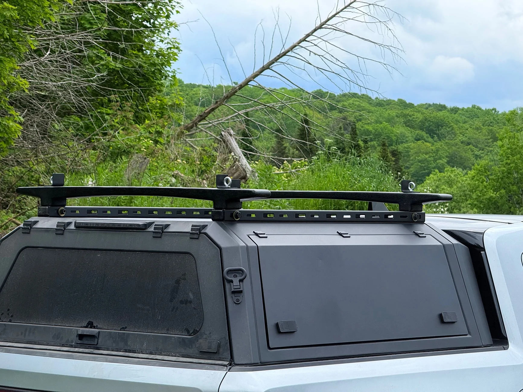

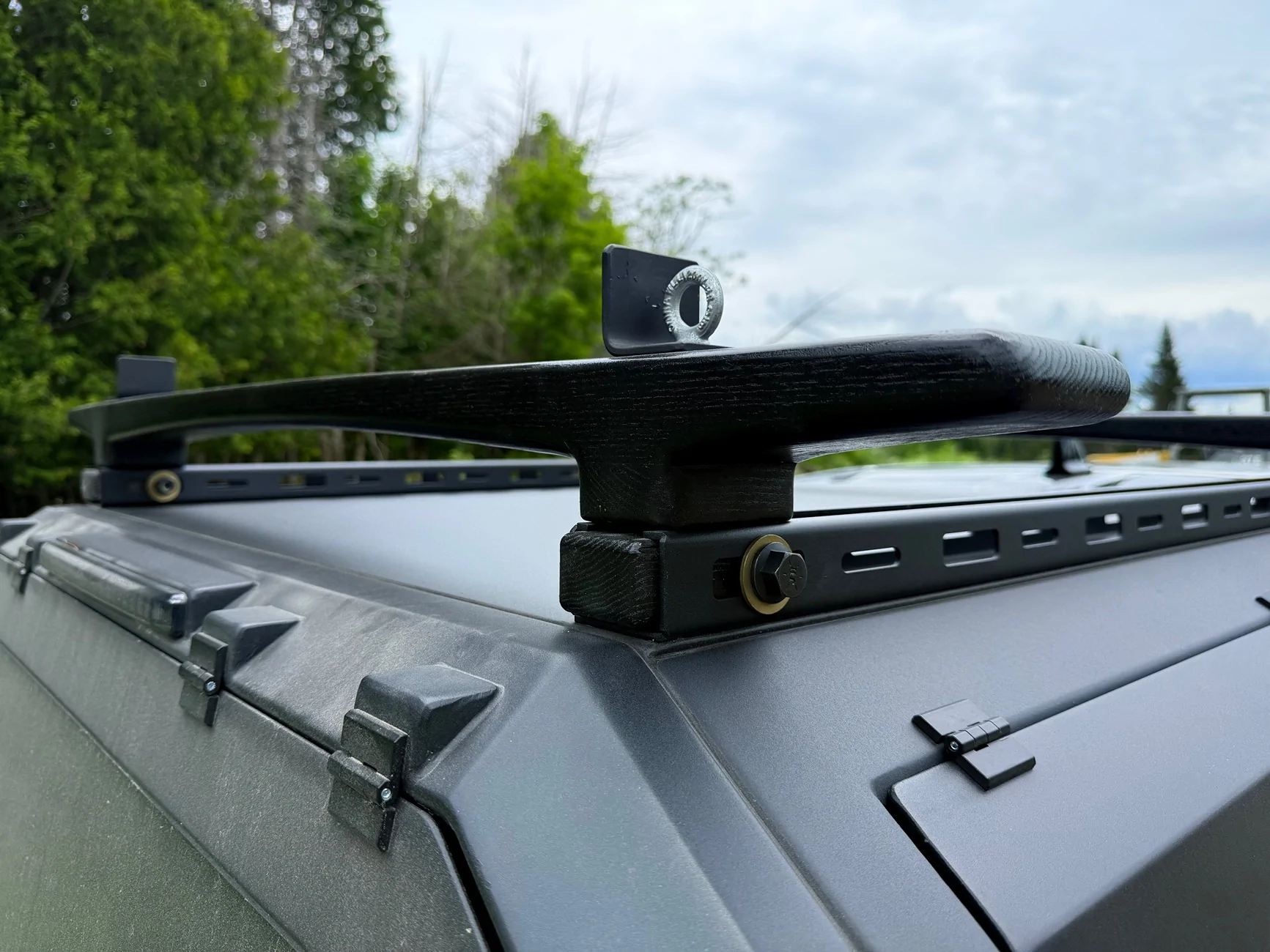

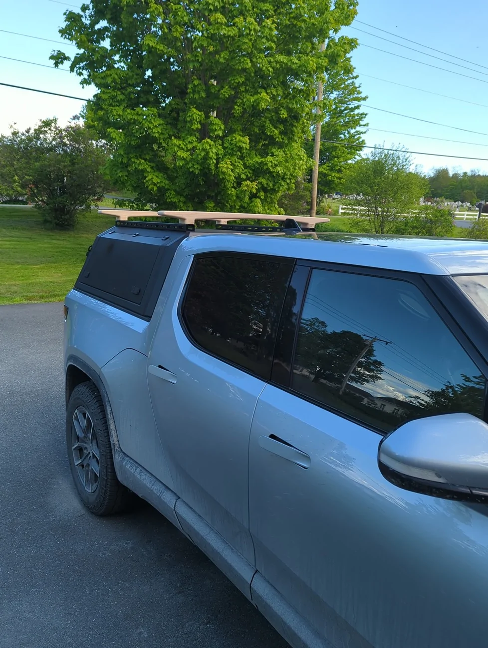

This cost a lot more, but I set up our builder/facilities maintenance person with a cap that he made a rack for. It’s significantly improved the utility of the truck we lease for him. These photos were from just after he made the racks. He now leaves a crossbar on the rear of the roof and made the wooden racks so they would line up with the Rivian rack.
If I’d seen an affordable option like yours we may have done that instead of spending $2k on the cap 😂 but it is sweet, and useful for other reasons.
Which cap is this? Who makes it?
Wow, those are some beautifully made wooden racks! I was thinking about making a wood one too as I couldn't find a cheap rack. I don't have the wood skills to make them that nice. Lucky me after weeks of looking, I found this solution that works.

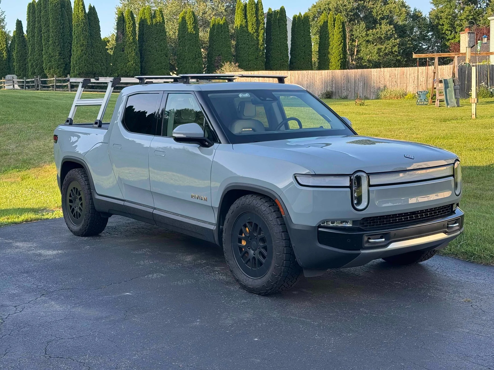

I don't have it installed right now, but I just used 30mm square u bolts, with a short unthreaded length, these are the ones:
4Pack Square U-Bolts 1-1/4"(30mm)... https://www.amazon.com/dp/B09MHX4QXJ?ref=ppx_pop_mob_ap_share .
Then I bought these cheap black cutting boards and cut into smaller rectangles to fit the base of the rack, notching out where the cross bar mount is since that sits proud of the bedrails. I think it needed 4 layers of these thin ones to clear. They are the same width as the rack baseplate.
Begale 6-Piece Small Plastic... https://www.amazon.com/dp/B08MZRDRL2?ref=ppx_pop_mob_ap_share
If you center the rack on the cross bar mounts, the gear tunnel and tailgate buttons are not blocked.
