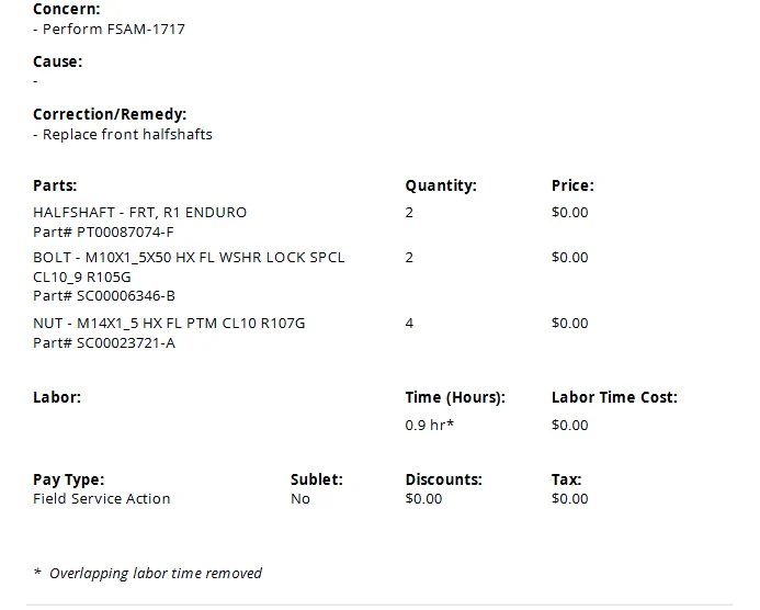

You ever schedule something simple like an alignment and drive out with a brand-new front end? That’s how this story starts.

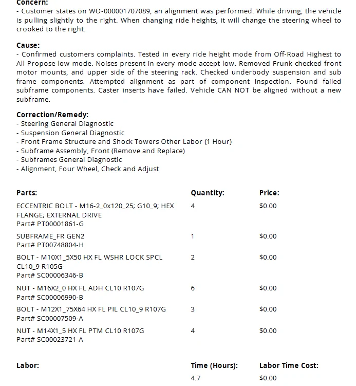

I booked a basic alignment for my 2025 Rivian R1T. When I arrived, Rivian added a Field Service Action for the half-shafts (FSAM-1717). No big deal, I figured it’d take a day. But once the work was done, the truck still pulled to the right. Even stranger, the steering wheel started sitting crooked when I changed ride heights.

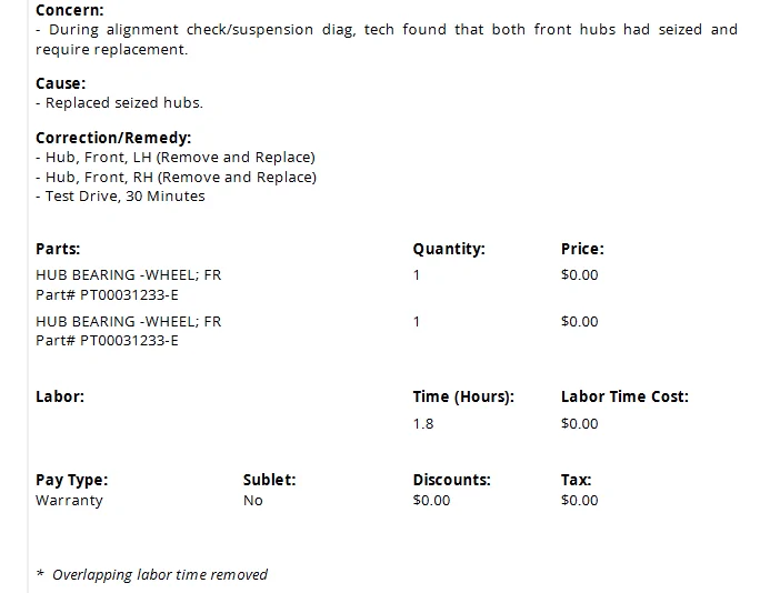

A week later, I was back at Rivian Fife for a deeper inspection. The techs dug in and found the real issue: failed caster inserts inside the front subframe. Turns out, you can’t hold an alignment when your subframe geometry is off. The only fix? Replace the entire front subframe.
While they were in there, they also replaced both front hubs that had seized, but that word was not correct for them to use. When they try and rotate the hub and if it does not freely spin, they tend to replace them now. Everything was covered under warranty, and I drove away with a brand-new front end and a perfectly straight steering wheel.
