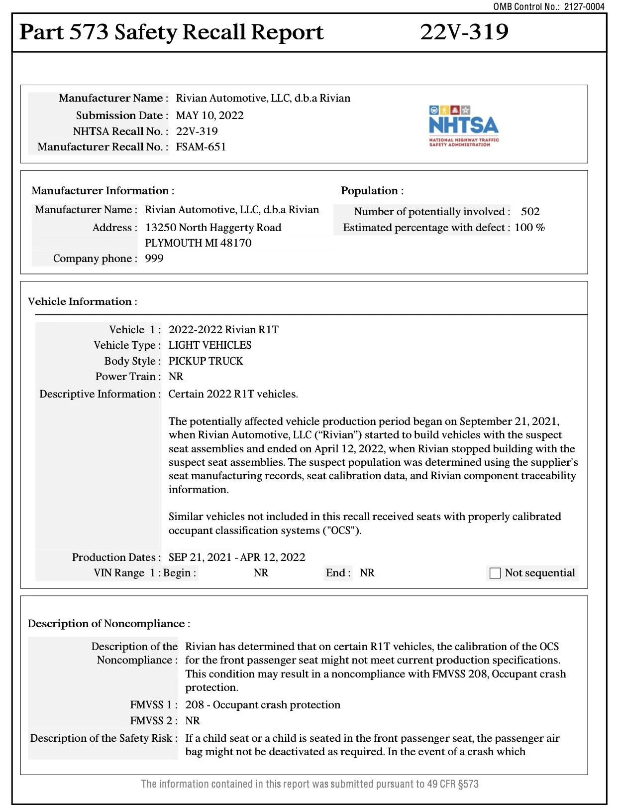

I can say as someone who is experiencing issues with this and logged it with support about a month ago, this is likely just a bad sensor.
I wouldn't consider that a production issue but a typical supplier issue.
Bad sensors happen.
To be clear I dont KNOW that is that case but it seems likely. Needing to replace the entire seat seems counter to my assumption but hey I dont work at Rivian.

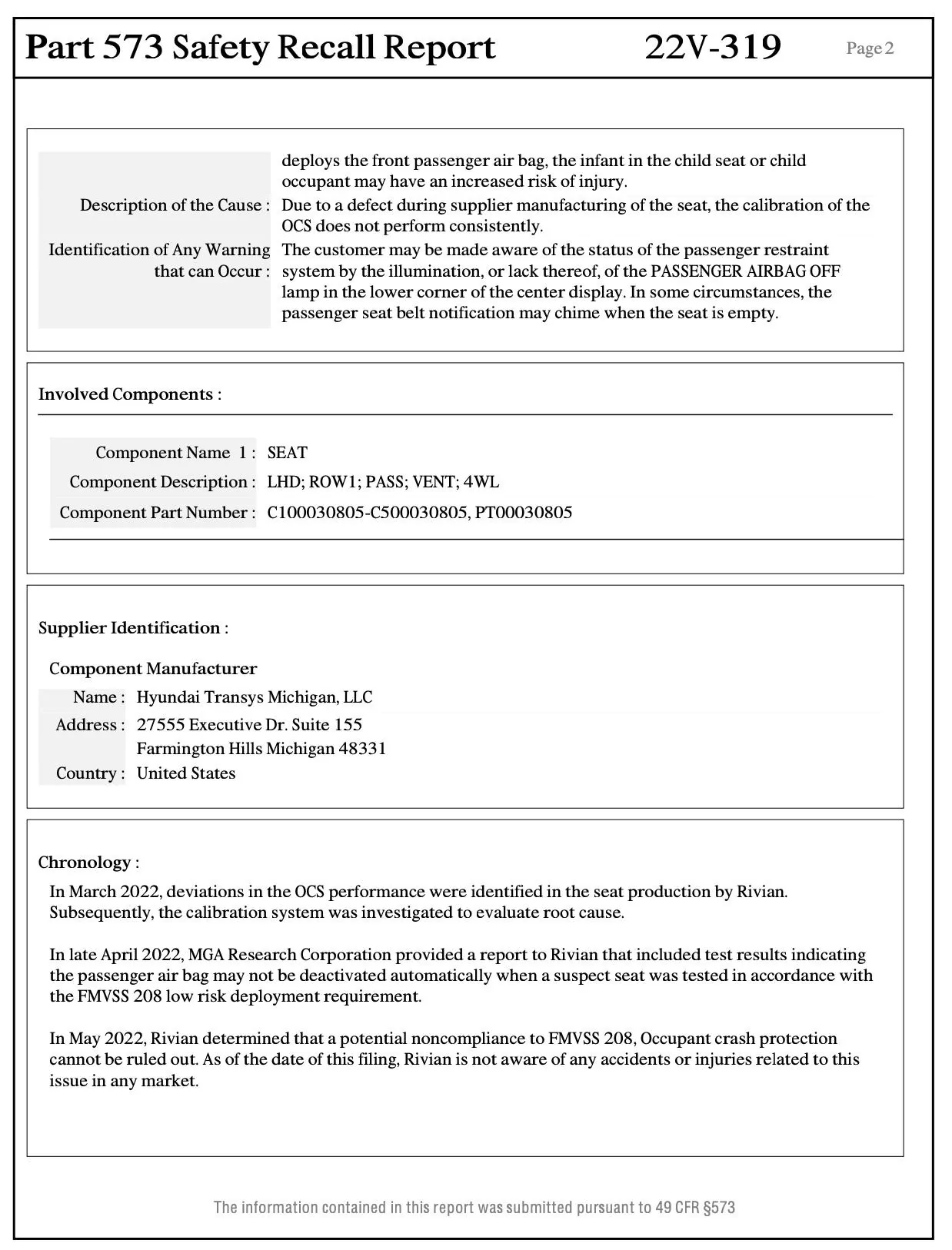

This was already a known issue in the community, but for a different reason (vehicle staying on because it thought there was an occupant). They had to do the recall because that also meant that airbags would deploy.

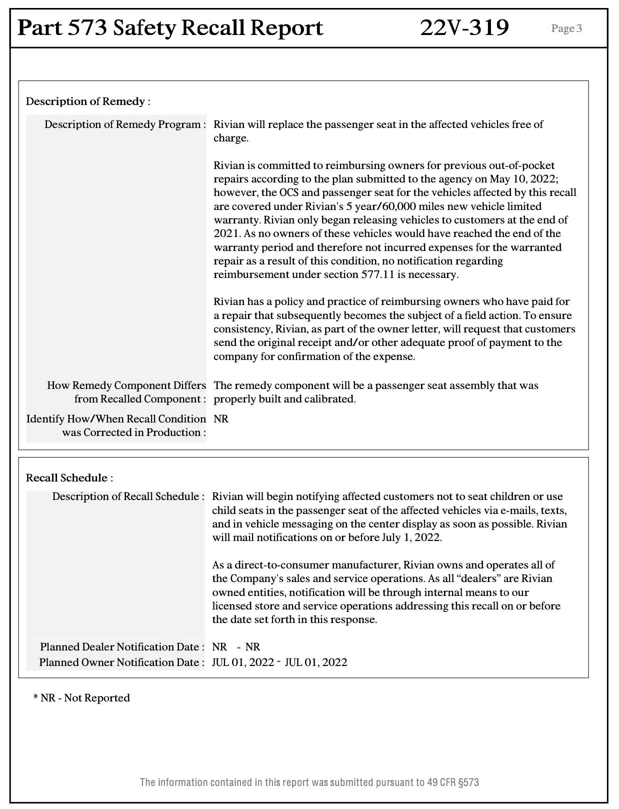

This isn’t just a problem for Rivian employees. I’ll chime in as someone who had their seat replaced well before the recall was issued. The reason for the entire replacement is that the seat is manufactured by Hyundai and as an end item is considered a warranty buy-back from Rivian…therefore they can’t just replace the sensor…they have to replace the entire thing and send it to Hyundai.
