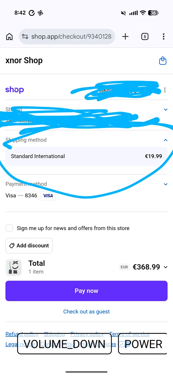

The shipping still says standard international, how can I ensure it's domestic?
You can send Lukas a quick message over on xnor.shop. He should be able to let you know for sure.
