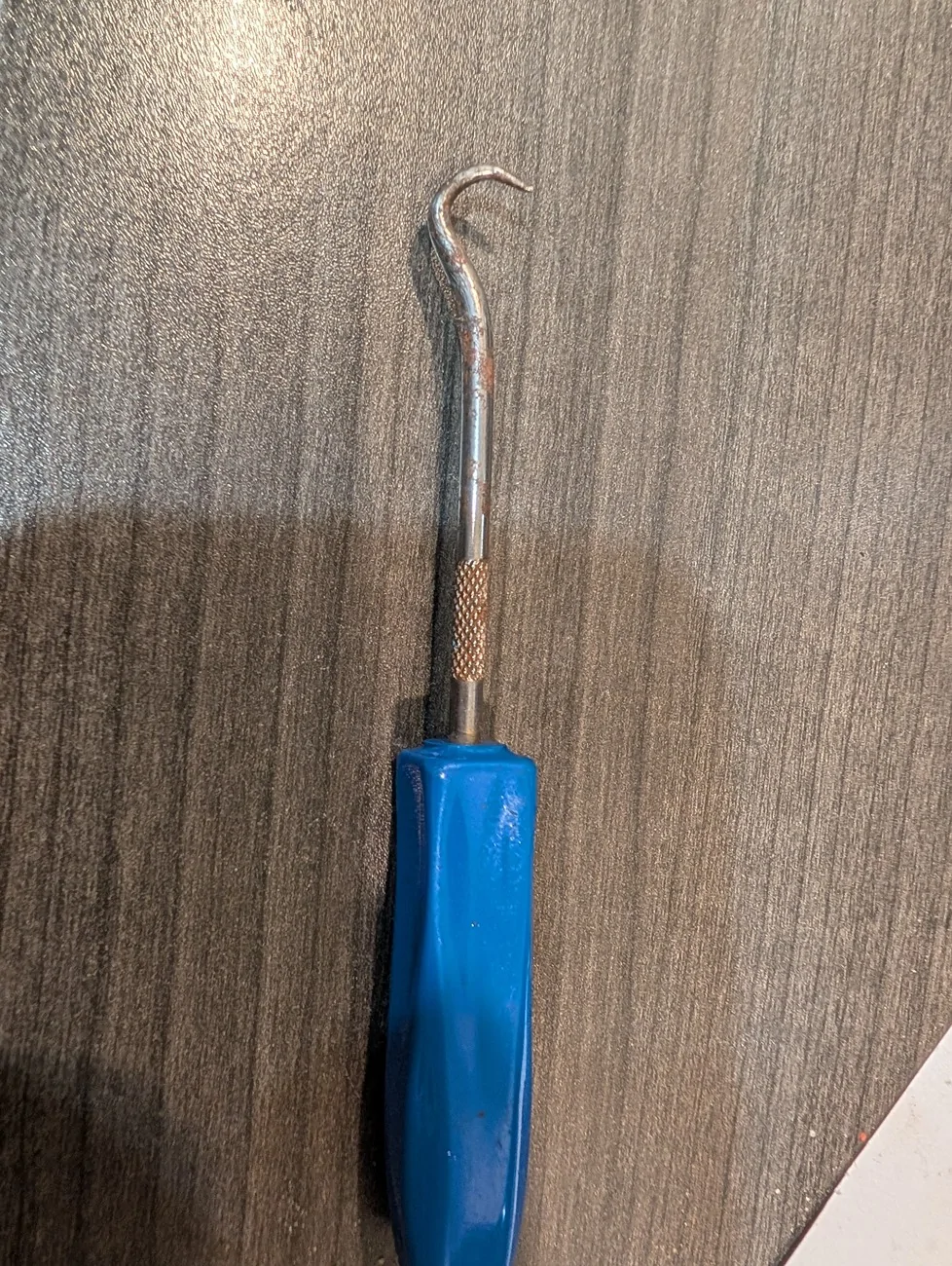

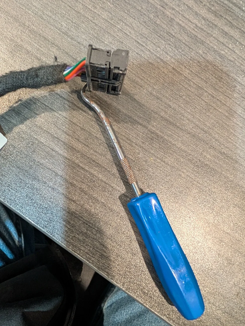

I will say, I understand the desire not to go thru that again. I was dreading having to do it. However, I found a hook tool that worked gloriously for my old arthritic fat fingers. I removed the harness I had in, then removed the components from my new harness just to make it less bulky. Fished the harness end behind the wire bundle and bracket until I could see it close the the AXM. I then hooked one of the lower empty pin slots with the hook and got it closer to position. Using a long skinny flat head screw driver, I moved the top of the connector so it was straight with the port and pulled the hook guiding it in. Then took a plastic spudger and pushed it the rest of the way in until the latch snapped in. The hook shape was important because it kept the handle from being in my view. I think the hardest part was getting to where I could see, everything else went really easy. Compared to my first time of 2 hrs, this was nothing.
