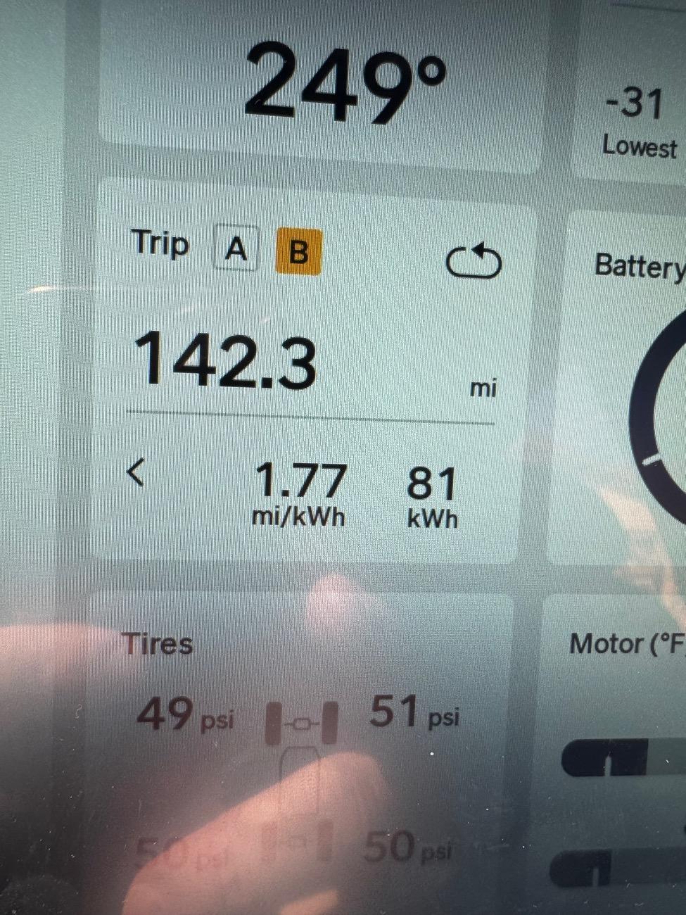

When can we expect true 500 mile range in a broad range of environments and speeds?
I drove a few hundred miles in freezing temperatures @70-75mph and averaged 1.4 m/kwh. One of the worst road trips I experienced because it required 4 charges each way.
Range in winter is a big problem, I otherwise love the R1S.
