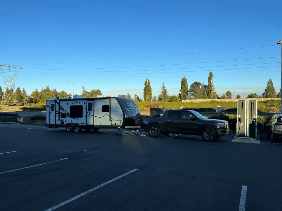

You appear to have my trailer's slightly shorter sibling:
Rivian R1T R1S Got to love it! 1664209957622
Rivian R1T R1S Got to love it! 1664209944882

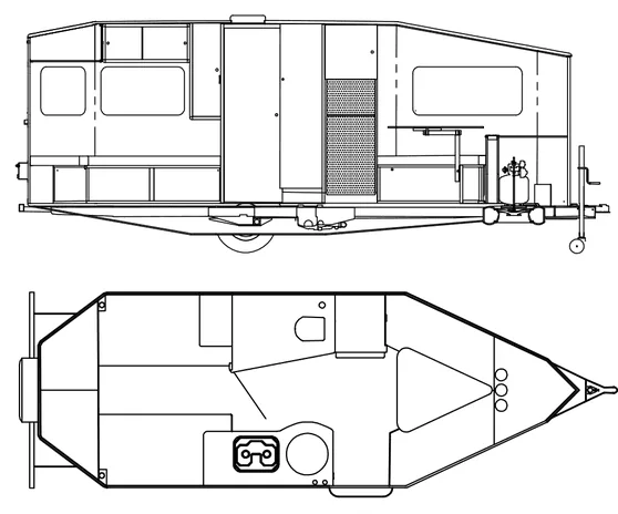

The A2124 is what we're considering and at 98", is not a candidate for most garages. It's biggest selling point for EV towing is its [claimed] efficiency. As the snip below shows, it has a triangular front designed to minimize frontal area, and a slanted rear to minimize turbulence. The underside is also smooth and enclosed, something that helps efficiency and that few other campers offer. The drawback to the A2124 design is that the interior is cramped. Just how limiting is difficult to determine from photos, which is why we want to se it person. We're actually in PA, so a day's drive to where Safari Condo is, near Quebec City. The plan is to tow our 320 up there, combining a walk-through of the camper with a Fall foliage tour.

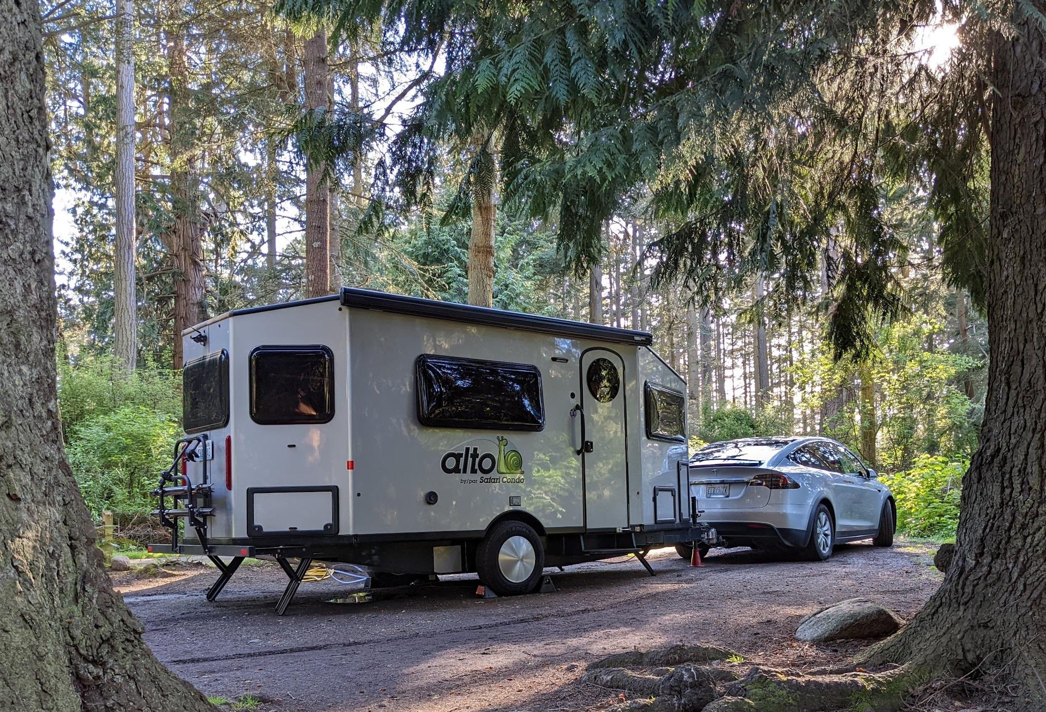

I ordered a Safari Condo Alto A2124 in Sept 2020. It arrived in Dec 2021. I'm hoping that someday my R1T with Max Pack will be its tow vehicle, but until that arrives we are towing it with our 2017 Tesla X.
Some of my key takeaways from extensive threads on the teslamotorsclub.com Model X forums:
  • aero is generally the biggest factor by far. Weight can become a really big deal if you do a lot of elevation, though
  • keep your speed down! Drag increases as the square of the speed (whether you have a trailer or not)
  • things with a small frontal area - think short and narrow - are best. Folding trailers can be great
  • Among full-size trailers, an aerodynamic shape is your friend. While eye-wateringly expensive, the Bowlus trailers are probably the best you can get
  • Not too far behind are trailers with friendly, 3-dimensional edges like Airstream, or the Alto A2124. Though note that a more-traditional style like the Alto A1723 can be very similar (at least in total drag, partly because of a slightly smaller frontal area)
  • Actual teardrops are aerodynamic because they have that shape in 3 dimensions. However, most teardrop trailers still have straight edges in two dimensions, and that causes a lot of turbulence. Most teardrop trailers are not terribly aerodynamic (though they still may do well if they have a small frontal area, like the Alto R-series)
Our X is rated for 295 miles at about 300Wh/mi. That rating is at about 55mph in good weather, so in our real driving over the past several years we have averaged about 365Wh/mi. While towing the A2124, we have gotten anywhere from 500Wh/mi at 55mph on a dry, low-wind, 65 degree day to 600Wh/mi at 60mph on a rainy, windy, 45-degree day.
So worst-case, it has cut our range in half of the rated range (though we lose less than that compared to our normal range). The absolute hit when towing with the R1T should be very similar, but given that the R1T is not nearly as efficient as the X, I'm hoping that the percentage hit will be smaller on the R1T.

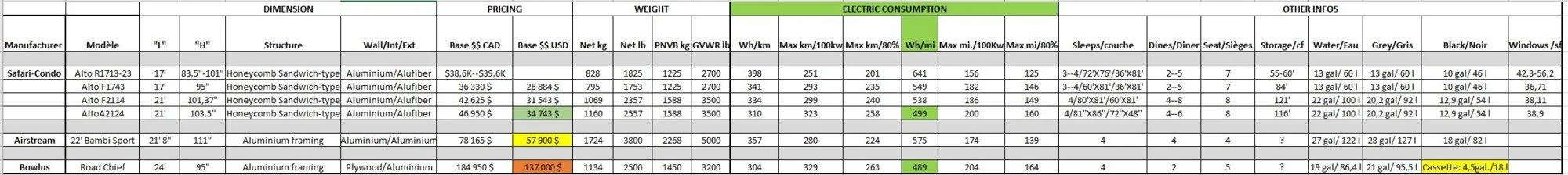

Here is a table from Safari Condo where they say they have tested various trailers behind a Model X, and here's the consumption rates they recorded.
Rivian R1T R1S Got to love it! Common caravan comparison 08-2019
Not everyone that has seen this table agrees that it's a fair comparison, but I don't have a better table.

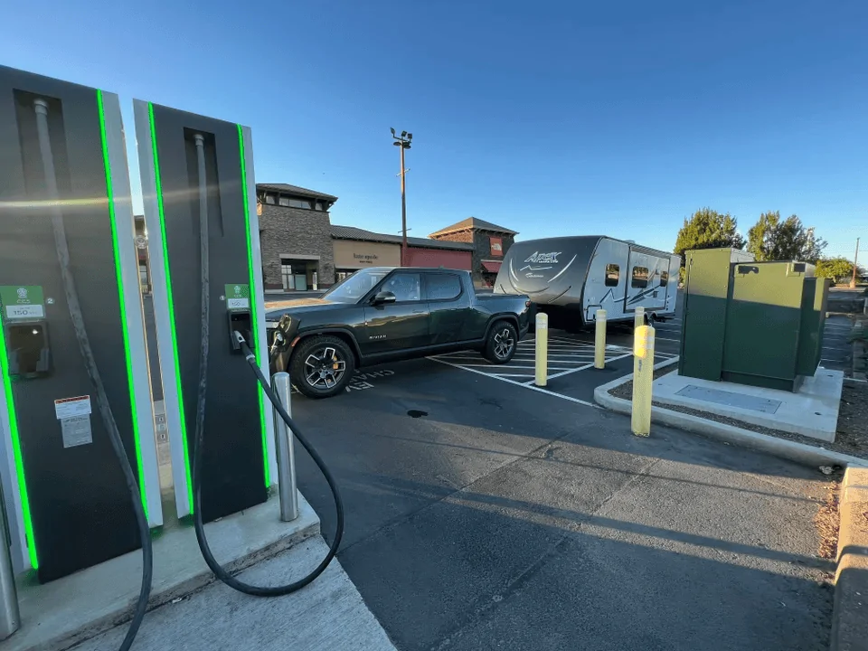

I finally can tow our Safari Condo Alto A2124 with a Rivian. Too bad we don't have any camping trips planned. But I will report back with efficiency numbers when we go somewhere.

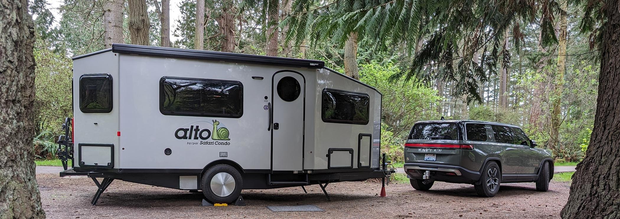

We haven't taken many trips, but here's what we have so far:
1. My wife got 1.55mi/kWh on a 56-mile route (plus a ferry ride in the middle) where speeds varied from 35-60mph. It was lower 60's with a tiny bit of rain. Very little elevation change.
2. We got 1.51 on a 136-mile round-trip over a mountain pass (up 2779', then down 807'; camp and then go back). Clear dry days in the 60's. Speeds 45-55 on backroads (almost half the trip) and 60 on the freeway. It was 1.34 on the way there (more up) and 1.73 (more down) on the way back.
3. There was a third trip, but I can't find any numbers written down anywhere. I got sick on the trip so maybe I just didn't document it, but I am pretty sure the numbers weren't far from the above.
Just for reference, when NOT towing and going 75mph (or trying to; there were some slowdowns so my average was 71mph) I got 2.27. This is an R1S with 20" wheels; I changed the tires to Michelin Defenders and added the EVSportline aero inserts.
Over the last ~6 months, the car reports an average of 2.17. That is mostly not towing (though it does include a couple of the trips). That is also mostly fairly-short around-town driving.
Redmond Chad
Oct 14, 2022
282
431
Redmond, WA
R1S (LG, FE, 20"), Tesla Model X
And we just took a fourth trip towing the Safari Condo Alto A2124. The car seems to show fewer details about energy use; maybe I need to dig more...but we did a 152.7 mile round-trip that used 74% of the battery. The R1S claims 1.5 mi/kWh.
Sanity checks: Usable battery (large pack) is about 132kWh (thanks Dave!). Times 1.5 indicates a max towing range of 198 miles. We used 74% of the battery, so could supposedly have gone 206 miles on 100% of the battery. 74% of 132kWh is 97.68kWh; times 1.5 is 146.5 miles but we actually went 152.7. Both of these metrics indicate that we did better than 1.5 mi/kWh; but perhaps not enough to get 1.6. That's in line with previous trips.
Conditions: dry, with temperatures in the 50s. Some light winds. Fairly flat for the PNW. We went just over 60mph on the highway which was most of the trip; but even though traffic was good it says our average speed was 45mph...I'm not sure if it's counting stoplights.
