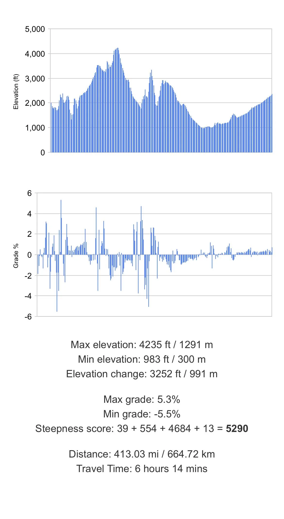

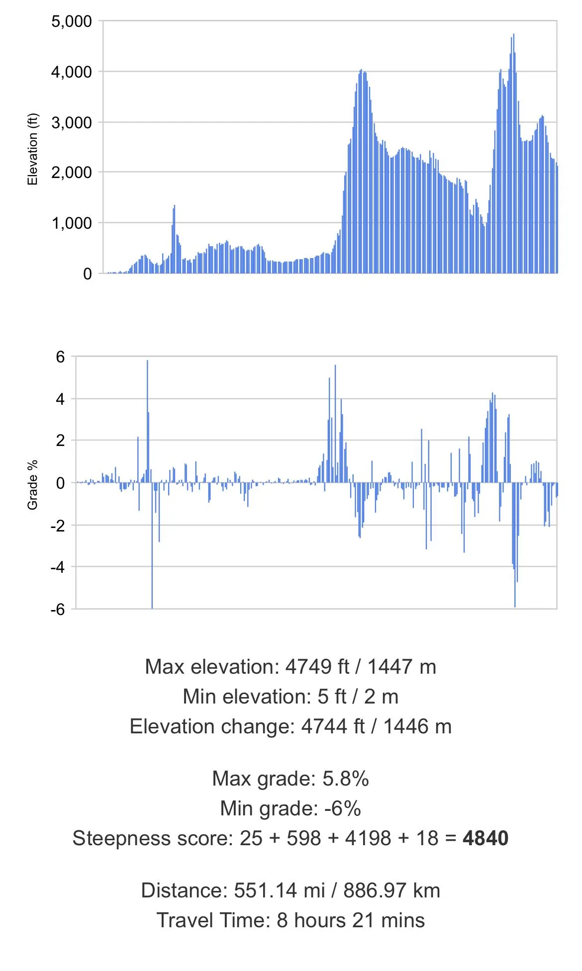

How fast were you going? How strong was the headwind? Grade?
2000 mile trip from Bay area to Las Vegas to Tucson and same route back. Highway speeds ranged from 70 to 85 mph set on cruise control. Strong winds on the vegas to Tucson leg.
Rivian R1T R1S A/C Performance B8F22E18-56BD-4B30-B1E0-1F2FC361A698
Bay Area to Vegas
Rivian R1T R1S A/C Performance 5C4D4F90-55E1-4F94-BDA6-C827312CE0ED
Vegas to Tucson
